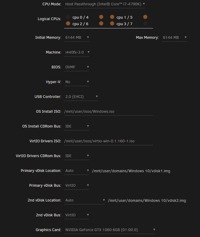

For the past few weekends I've been working on getting a VM working with my Gigabyte Nvidia GeForce GTX 1060 card with Passthrough.  I eventually got windows to see it fine (without the Windows Code 43 error) by disabling Windows 10 Auto driver installation.  So it appears to work fine, I'm able to use Steam Stream to play games.  I am able to RDP flawlessly.  The problem I am running into is I cant get Moonlight to work.  It just displays a black screen.  In further testing I was never able to get Splashtop Personal to work.  At best I will be able to Login to Win10 then its screen goes black with Splashtop.  Anydesk, wont connect just sits there saying "Connected, waiting for image".  TeamViewer will sort of work, have to keep selecting "Refresh Image" sometimes.
I was able to I think dump my video cards vbios, for some reason it is only 58KB, the VM seems to work fine with it, it will also work with a modified one from TechPowerUP at 242KB.
I have unraid set to use the GUI from the onboard/onchip video, other than that I just have this Nvidia 1060 in the system.
Has anyone run into this before?  There is clearly an issue where some work some don't.  I've tried another new install of Win10.  I'm using the latest 1809 version of windows 10.  Unraid is on version 6.6.6.  Any Ideas, I'm a little weirded out by some things working and some not and I've read Moonlight works better than steam stream.  Let me know if you need any more info I have not already given.  Thanks

We would need the VM's XML file, and the diagnostics file to be able to help further...
Appreciate the reply, yea, I have been wondering the same thing.  It may seem fine in windows but not completely...I'll see if I can dump it again, last ditch, install the 1060 into another windows computer and try to pull the bios from GPU-Z.  Bellow is my XML, IOMMU, and Logs from the VM.  If that isn't the diagnostics please forgive my stupidity and let me know exactly what you are looking for there.

Diagnostics is under the "Tools" menu, then under diagnostics, then just click "Download"...  Also just for the future, the "Code" button is the one you want to click when posting XML code, the "Quote" button makes everything hard to read...  Or better yet, paste it into a text file and just drag the file into this window...  Not chewing you out, just mentioning for the future...
Edit: Also, reading through what you did have posted:
2019-03-01T18:39:46.375082Z qemu-system-x86_64: vfio: Cannot reset device 0000:01:00.0, depends on group 15 which is not owned.
2019-03-01T18:39:46.483062Z qemu-system-x86_64: vfio: Cannot reset device 0000:01:00.0, depends on group 15 which is not owned.
This looks like that reset of the GPU thing that I was talking about, so it looks like it is not fully passed through yet...
Edited by Warrentheo
Thanks for the tip, I almost used Code, but switched to Quote.  Diagnostics are attached if still needed, but I think your right.  I need to get the vbios right.  I may not get to that till next Friday, but will definitely report back here with my results.  Thanks for your help.
media-diagnostics-20190301-2021.zip
@Phase1 I had that issue by forgetting to passthrough the audio portion of the card. Only happens if it sits on the top PCIe slot. The same card on one of the other slots works for me without the audio passthrough.
Edit:
Another thing to mention, if you select the cores for the VM, always use the core and it's HT and skip the core 0 and it's HT core. It's used by Unraid itself. Remove core 4 and use core 7 instead.
Edited by bastl
Thanks for the reply @bastl.  I did try moving the card to another slot, so far no luck.  I even removed the card and put it in another desktop and was able to export the bios from the card using GPU-Z.  Its actually 245KB.  So I think its pretty clear with @Warrentheo advice that I did not have correct vbios.  I've tried booting the VM with the new bios file, and even tried trimming the file as mentioned in one of SpaceInvader's videos.  Neither appear to be working.  The Code 43 is back in windows.  And still getting these issues in the VM Log
2019-03-02T20:48:11.803533Z qemu-system-x86_64: vfio: Cannot reset device 0000:02:00.0, depends on group 16 which is not owned.
Typically should I need to trim the bios file with a hex editor if its pulled directly from the card?  Any other ideas?  I appreciate your feedback so far.  I also fixed the CPU/Core thing too you mentioned.
Made some progress but still have exact same issue.  Got rid of the previous error:  vfio: Cannot reset device 0000:02:00.0, depends on group 16 which is not owned. by selecting the nvidia audio controller for the sound card (seems obvious now I might have to add that).  Previously I never even selected a sound card.  That's what group 16 was referenced too.
IOMMU group 16:    [10de:10f1] 02:00.1 Audio device: NVIDIA Corporation GP106 High Definition Audio Controller (rev a1)
And after nvidia driver uninstalls re-installs etc, with the hex edited bios file from the GPU added I no longer have the Code 43 error.  But still have the exact same problems as I started with.
Finally solved it, turns out with the nvidia gtx 1060 you need the video card attached to a monitor or a dummy monitor plug for windows to like it.  Maybe you need it for all GPU's this is just new to me.  I follow the /r/homelab subreddit and saw someone trying to get a headless Win10 working using VMWare and someone responded with its working fine with their 1060 with a HDMI dongle.  I have a crappy monitor next to my unraid box for emergencies, and I attached it and everything seems to work like it should now.  I hate easy stuff but glad I figured it out.  Only minor problem is with moonlight the resolution requirements for the game are the max for the monitor attached.  I've ordered a DVI dummy plug last night.  Very much appreciate your help and insight.
