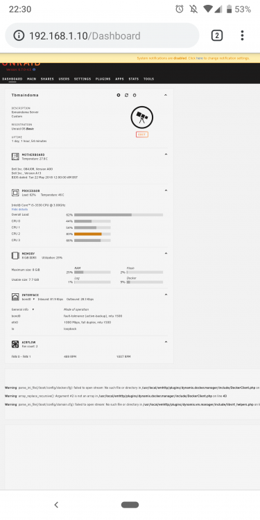

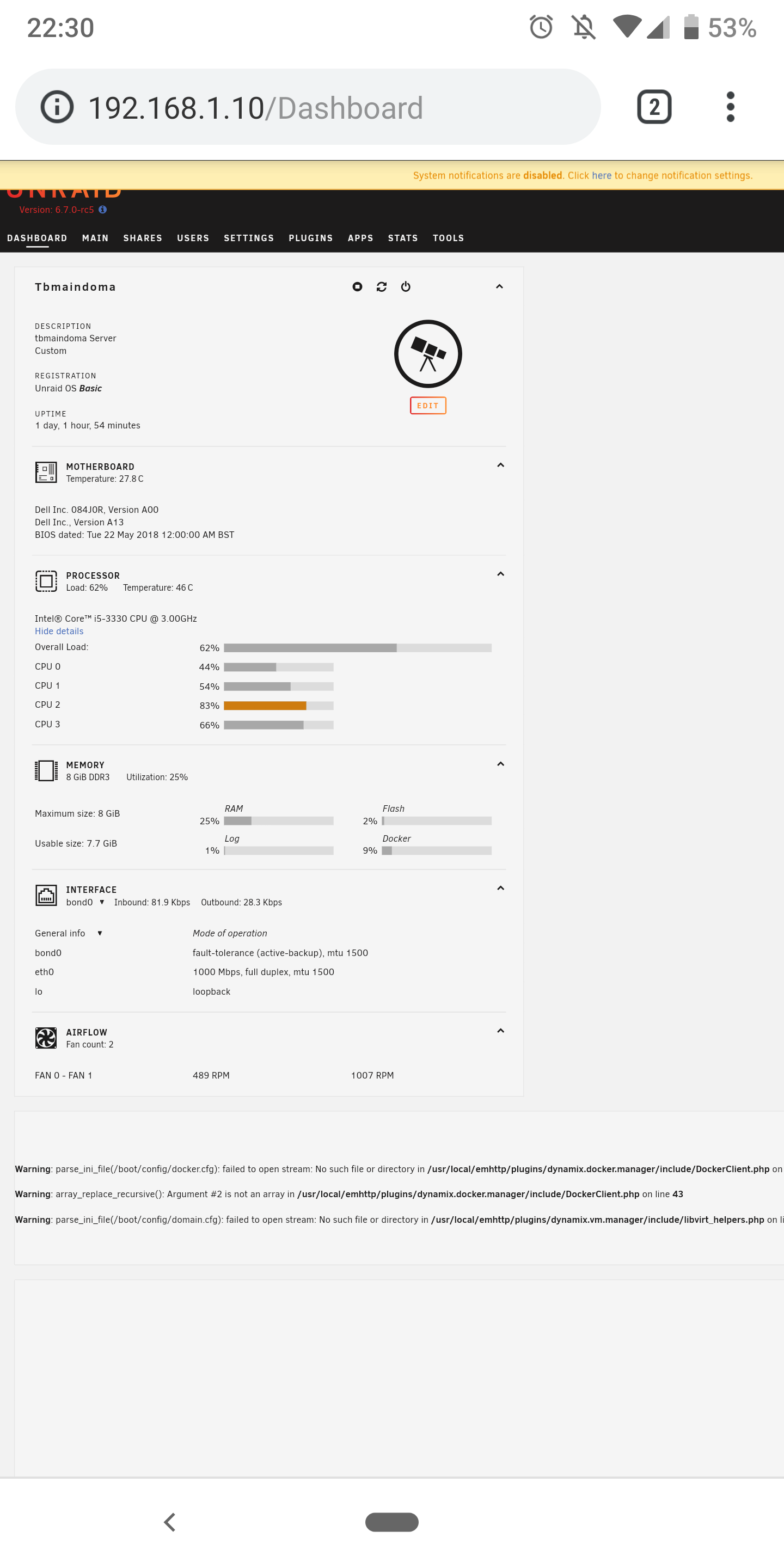

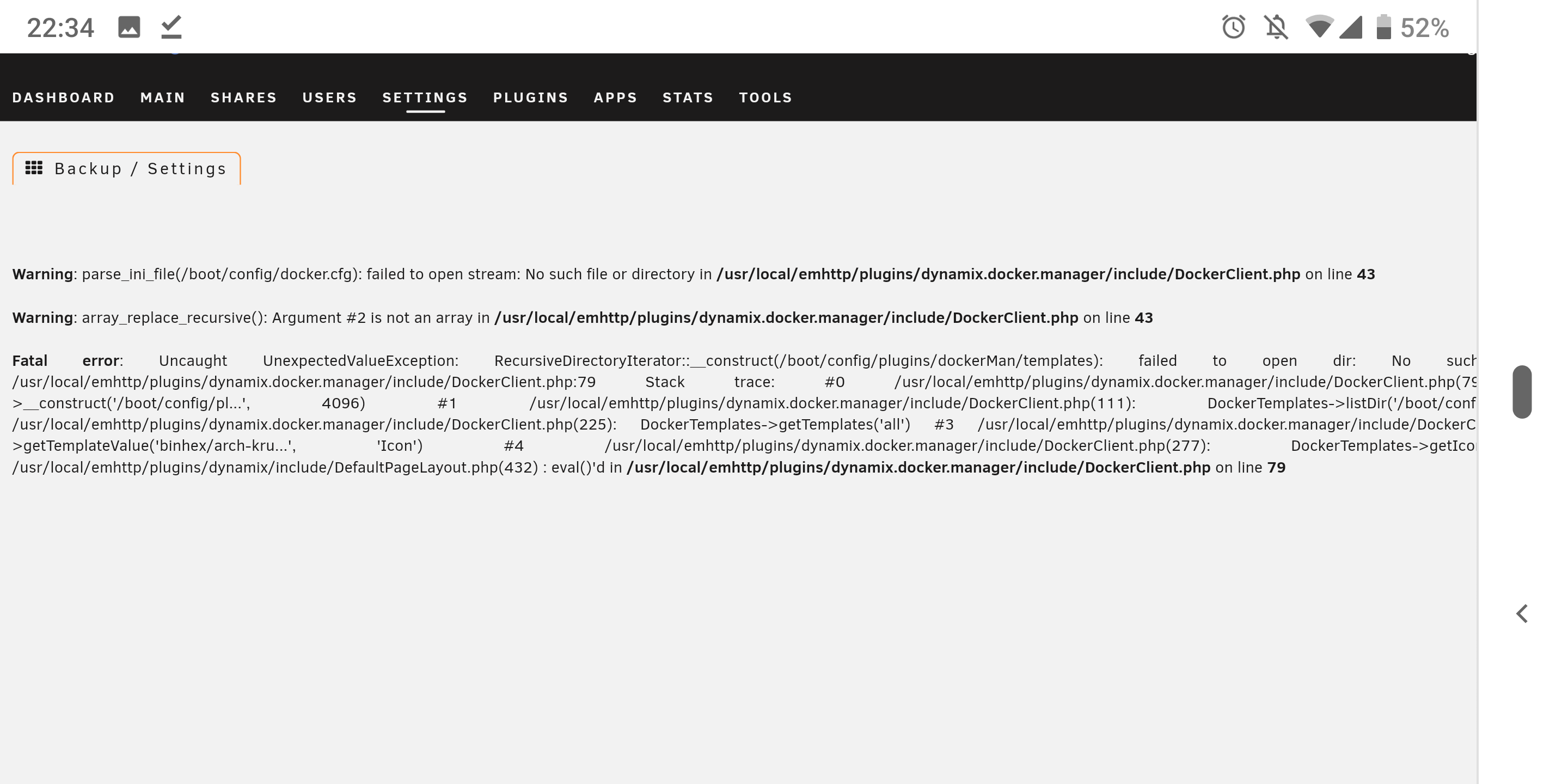

The UX is partly working but certain elements don't. I'll see if I can get a screen shot as it's strange plus I'm not sure but I think the dockers are still running.
