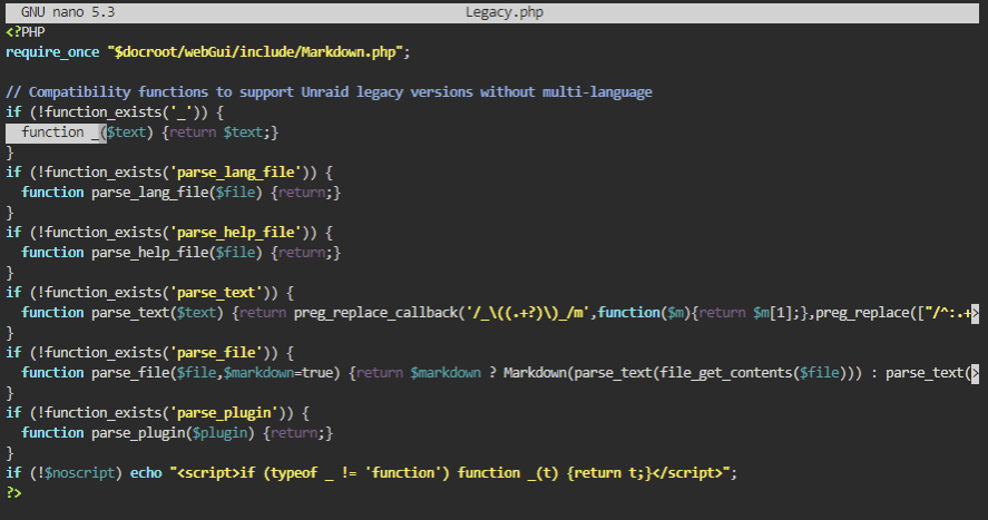

Running manually I got this error for every function defined in Legacy.php:
# /usr/local/emhttp/plugins/parity.check.tuning/parity.check.tuning.php "monitor"
<script>if (typeof _ != 'function') function _(t) {return t;}</script>
Fatal error: Cannot redeclare parse_lang_file() (previously declared in /usr/local/emhttp/plugins/parity.check.tuning/Legacy.php:6) in /usr/local/emhttp/plugins/dynamix/include/Translations.php on line 46
I fixed it (?) by removing the functions from Legacy.php.

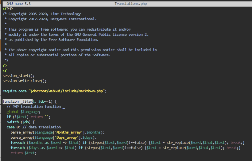

I get the following error when stopping my array:
Array Stopping•Fatal error: Cannot redeclare _() (previously declared in /usr/local/emhttp/plugins/parity.check.tuning/Legacy.php:6) in /usr/local/emhttp/plugins/dynamix/include/Translations.php on line 19
I would change the function name but I don't know the rest of your code and don't want to screw up any calls to that function.

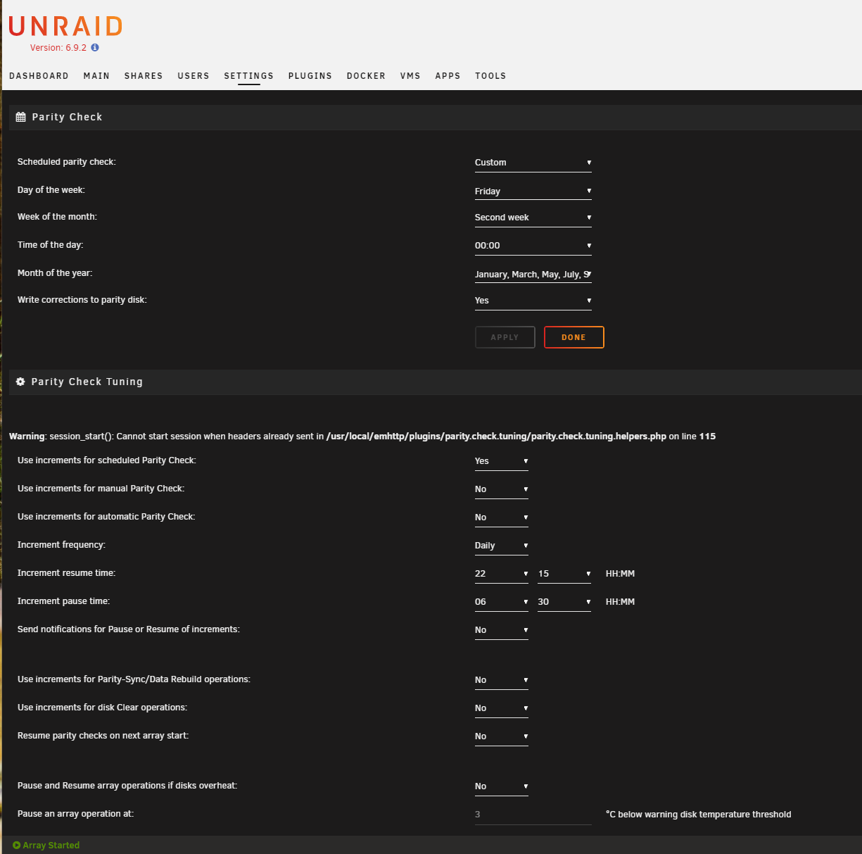

Hello. After the latest update I am getting a similar Warning as I was before. The location is a bit different but wanted to share what I am getting.
Warning: session_start(): Cannot start session when headers already sent in /usr/local/emhttp/plugins/parity.check.tuning/parity.check.tuning.helpers.php on line 115
This is on version 6.9.2
I can see where that message could originate from in the code - but I am not sure why.    Where are you seeing this message (GUI, syslog etc) and if the GUI on what page.   I did not see it when testing - but maybe I am not looking in the right place?   I need to be able to replicate the issue to be able to work on it (and know if I have fixed it). Also if it is the GUI what browser are you using?

It shows up in Settings > Scheduler.
Interestingly. I started checking this out because I had an upcoming parity check scheduled and wanted to make sure that the settings were correct as this was the first time I was using your scheduling plugin. When I originally set it up I did not see any warnings. The parity check started, there was an update to the parity check scheduler plugin which I performed while the parity check was paused because of the schedule enforcement that I had set. After the update this warning presented itself.
The parity check finished later that day but I never received a notification of that until I updated the plugin again earlier today. I thought that timing was a bit odd so I thought I would share. I have also attached a screenshot of the message as I see it.
I need to try and work out why I did not see the same message on my 6.9.2 system when testing.    I have just gone back to that system and this time that message IS being displayed which is weird.
In theory the code line that precedes the session_start() should mean that function should only be called if needed but that is obviously not always working as expected.  I Will work on correcting it on my system, but I will also add some diagnostic logging around that bit of code to help me get more information about why my check on whether the function is needed is not always working.

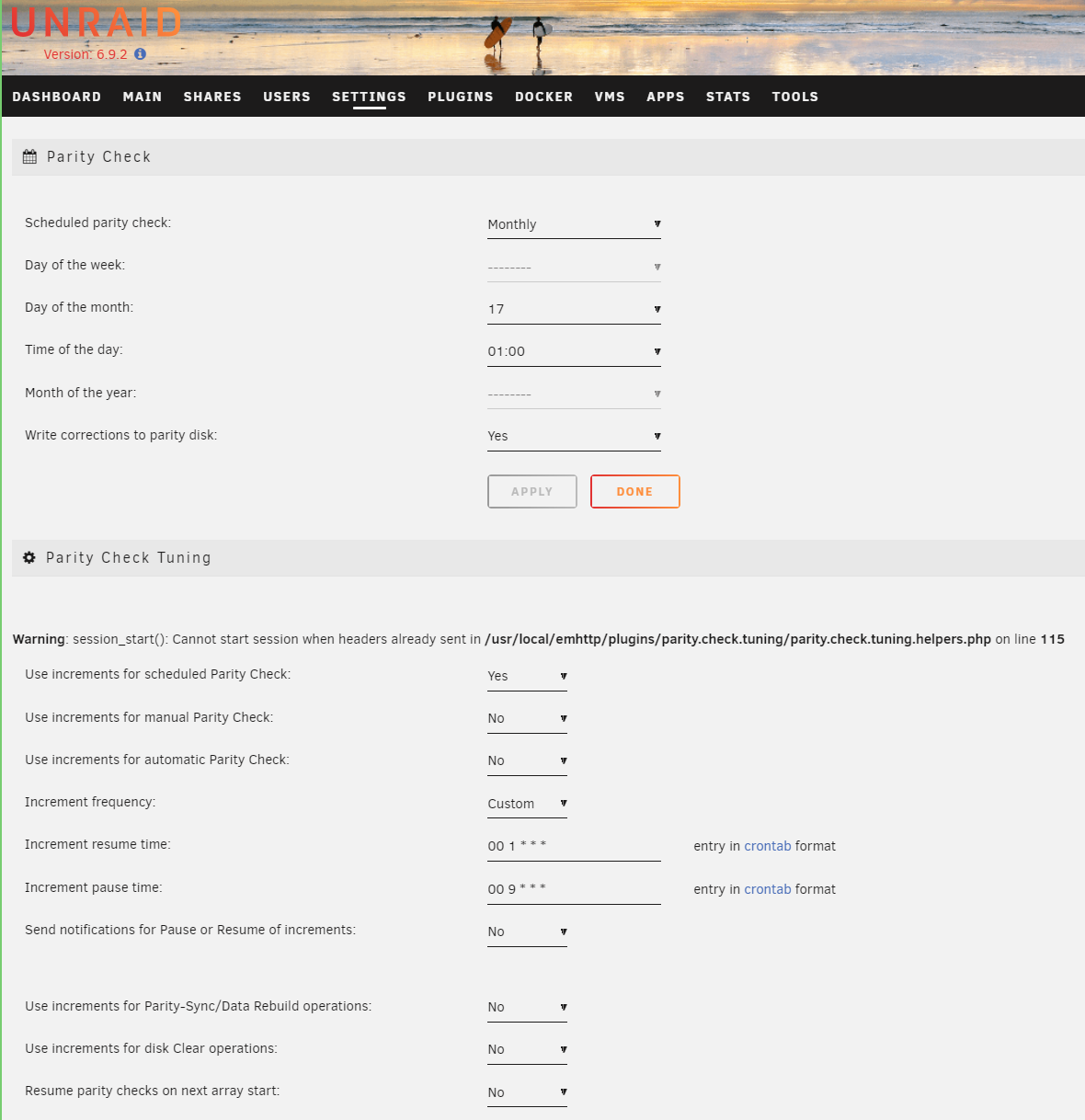

I recently started using the plug-in again and had the warning re "Cannot start session..." I'm also on 6.9.2. Here's a screenshot:Parity_check_settings.thumb.PNG.ddbe675ce89877e0d7c3881c9a08bb3a.PNG
I thought that with these settings my parity check would start early this morning (17th) at 1 am and pause at 9 am, but although it did start, it's now around 12 noon here and it's still running. Not sure if this is a result of the warning or an incorrect setting.
That is what I would expect as long as the check was started as a scheduled one.  Not sure where you are located but I assume somewhere far east or Australia if it is already 12 noon?
If you go to config/plugins/parity.check.tuning on the flash drive what files do you see as that may give a clue as to what type of check the plugin thinks is running.  The contents of the .cron file might also be useful to check that the scheduled entries for pause ant resume appear to be correct.
BTW:  If you want to run one increment a day then the 'daily' frequency option is easier to use and less error prone that the 'custom' one although I admit your 'custom' entry looks OK.
Looks like the previous update may have messed up setting cron settings correctly.   I have just pushed an update that corrects this and as far as I can see eliminates all plugin related warning/error messages from GUI and syslog.
Please report if anything still seems to be wrong after updating to today’s release.
