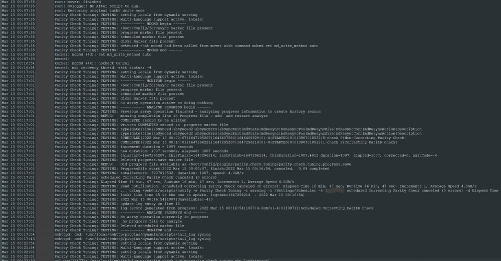

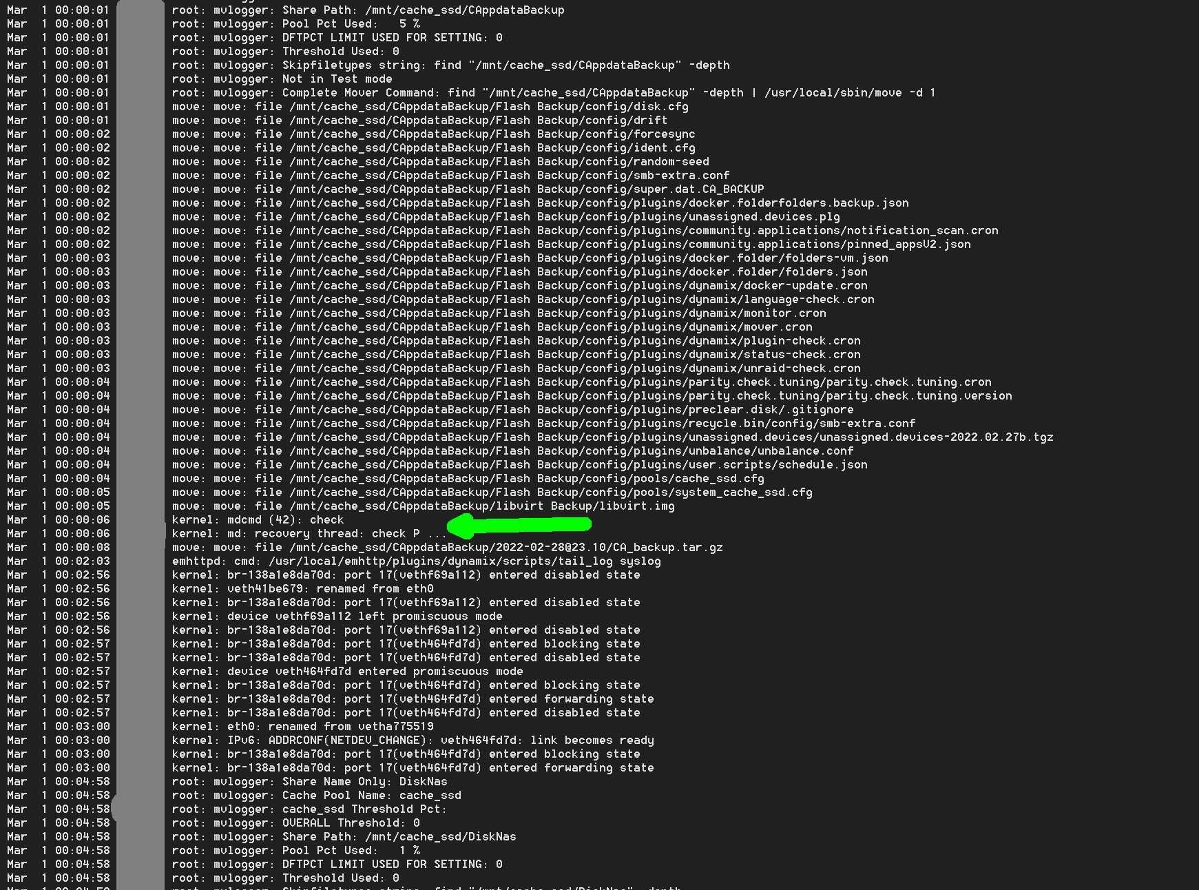

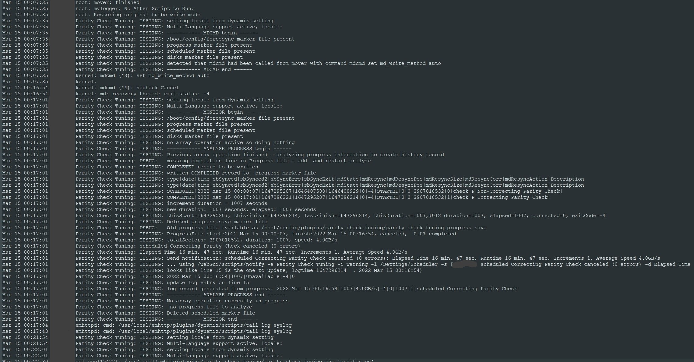

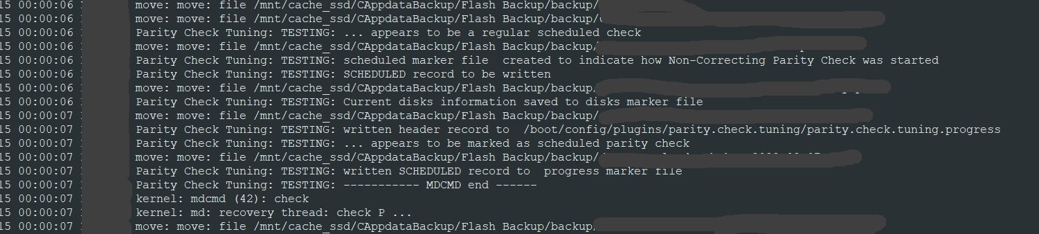

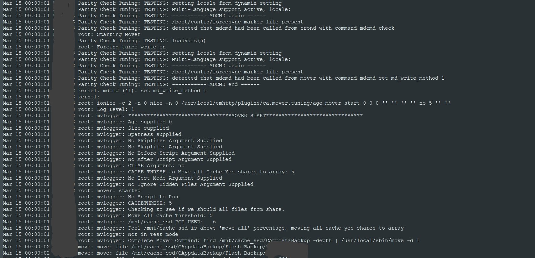

Finally got my sheduled parity check , so from syslog mover strted in 0:00:01
Mar  1 00:00:01 xxxxx root: Starting Mover
Mar  1 00:00:01 xxxxx root: Forcing turbo write on
Mar  1 00:00:01 xxxxx kernel: mdcmd (41): set md_write_method 1
Mar  1 00:05:04 xxxxx root: mover: finished
Mar  1 00:05:04 xxxxx root: mvlogger: No After Script to Run.
Mar  1 00:05:04 xxxxx root: Restoring original turbo write mode
Mar  1 00:05:04 xxxxx kernel: mdcmd (43): set md_write_method auto
but i didnt saw by unraid gui that parity was paused and wait for mover finished also i cant find it log ,only when parity started i think 0:00:06...
I checked the syslog and :
Edited by Masterwishx
I would need the Testing mode of logging in the plugin running during the period to see if I can work out what might be the problem.

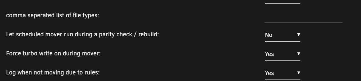

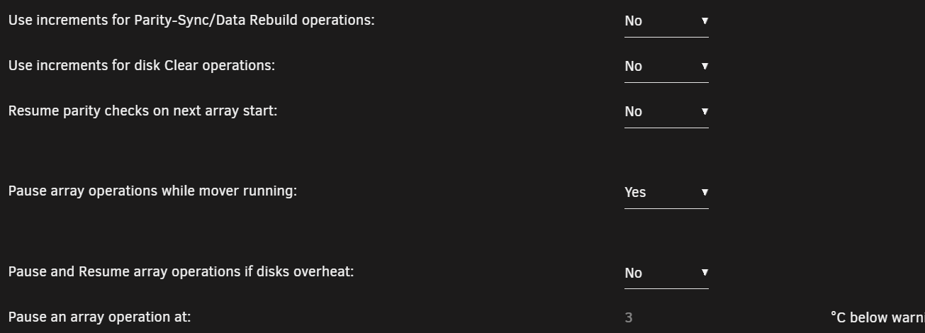

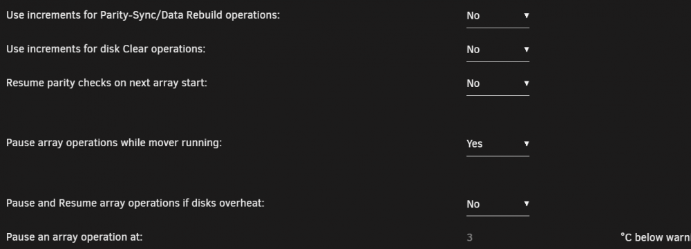

you might want to check in the plugin settings that the option to pause if mover is running is enabled.
i have it enabled ,i think its by default enabled .
also i have set in mover not to run when parity running and by syslog mover not started at 6:00 becose was parity running ...
OK - just thought I should check.  Getting the right level of testing logging will tell me what is happening under the covers.

Oh ,sorry for my missunderstanding...
Also i wanted to tell that i checked the problem we talked befor about starting parity and mover checking at 0:00 ,
and from what i can understand from log the parity is yes paused and after mover ended is continued but i dont remember that i saw pause of parity in unraid webGui in left botton corner .... please tell me if im right and if i should see pause in gui?
If a pause happens this should definitely show in the GUI with '(Paused)' appended to the operation in the status line.  Note that this text is done at the core UnraId level and is not added by the plugin so happens even when the plugin is not installed
i think it was pause but if you can check the log and tell if it ,but its not big problem i can make run parity at 0:30 after mover 0:00..
i posted becose we talked befor...
