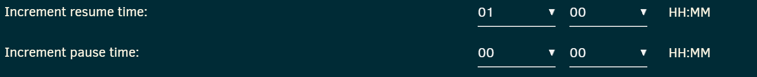

Trying to set the resume and pause times.
After clicking apply the resume time saves as entered but the pause time reverts to 00:00
Pause time was set for 06:00 and this is after hitting apply
Edited by shiftylilbastrd
This is a regression where several fields in the settings are not correctly displaying the current settings.   I have fixed for release that is forthcoming shortly.  It was a caused by me making a global edit that somehow missed some fields and I did not pick that up.
You will find that the values you set ARE being saved when you hit Apply if you examine the file parity.check.tuning.cfg in the plugins folder on the flash drive.

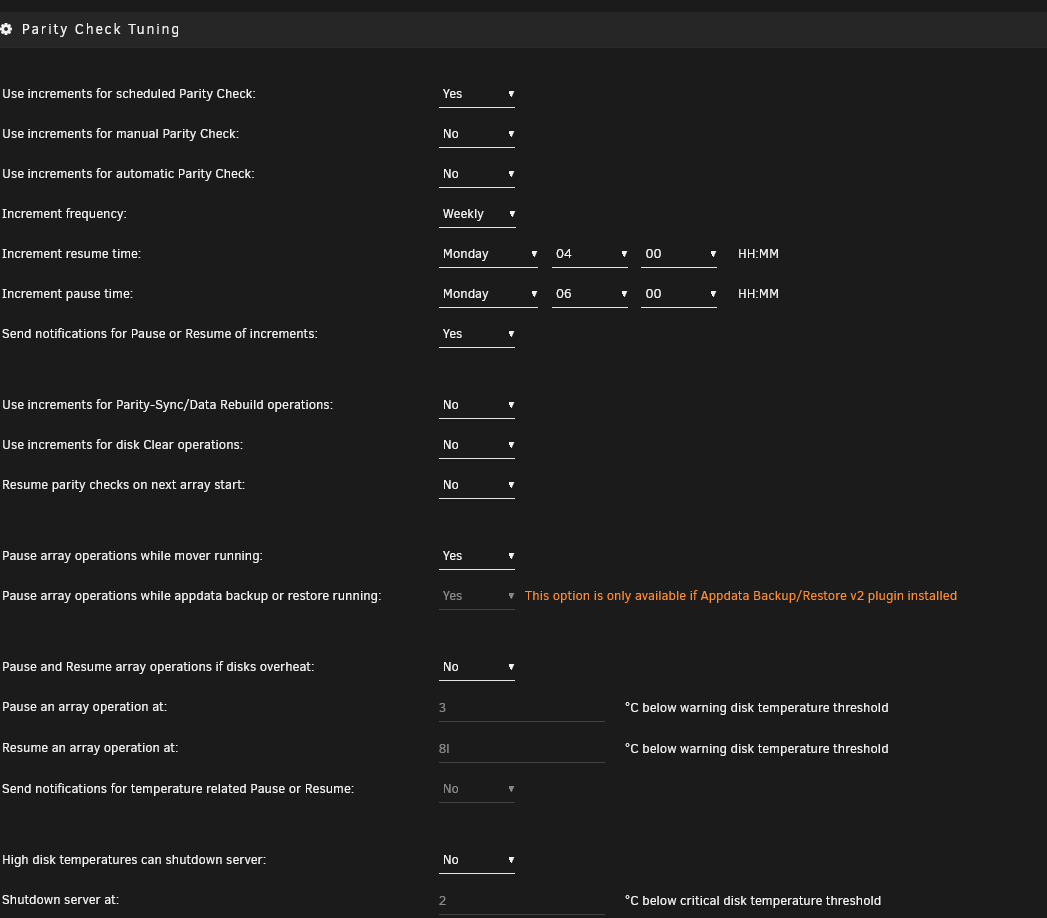

15 hours ago, itimpi said:
It appears that you do not have the option to run Manual checks in increments set.   In that case the plugin is meant to resume the check when the disks cooled off, but it did not.  If that option WAS set then it would be correct to pause until the next increment window happened.
Hopefully the diagnostics with Testing logging mode set will allow me to pin down more exactly what happened.  If not I will have to build in some additional logging to get to the root cause.
so i enabled increments for manual parity checks and changed increment pause and resume times to extend the parity window.
