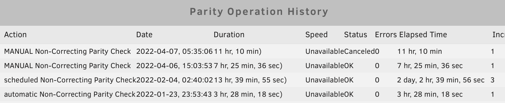

Unraid seems to be logging scheduled checks as manual (I'm running 6.10.0-rc4.)
I noticed it because my scheduled check, which should have paused in the morning, was still running. (I don't have it set to pause manual checks.)

The plugin's reporting matches unraid's history:
so I doubt it's a plugin problem, but I'm posting here because unless you're using it you probably won't notice.

I have reproduced this and It IS a a plugin bug and I will get a fix out.  I think it is a typo introduced in a recent update that is causing this.
BTW:  The Parity History entry is from the plugin as well so it is not surprising they agree :)

Now I wonder if Speed "Unavailable" for recent (and historical) runs is due to the plugin. Very minor issue either way.
1076629867_ScreenShot2022-04-07at11_37_13AM.thumb.png.5e72aab01bad5ac17eeaaea71fb0d982.png
