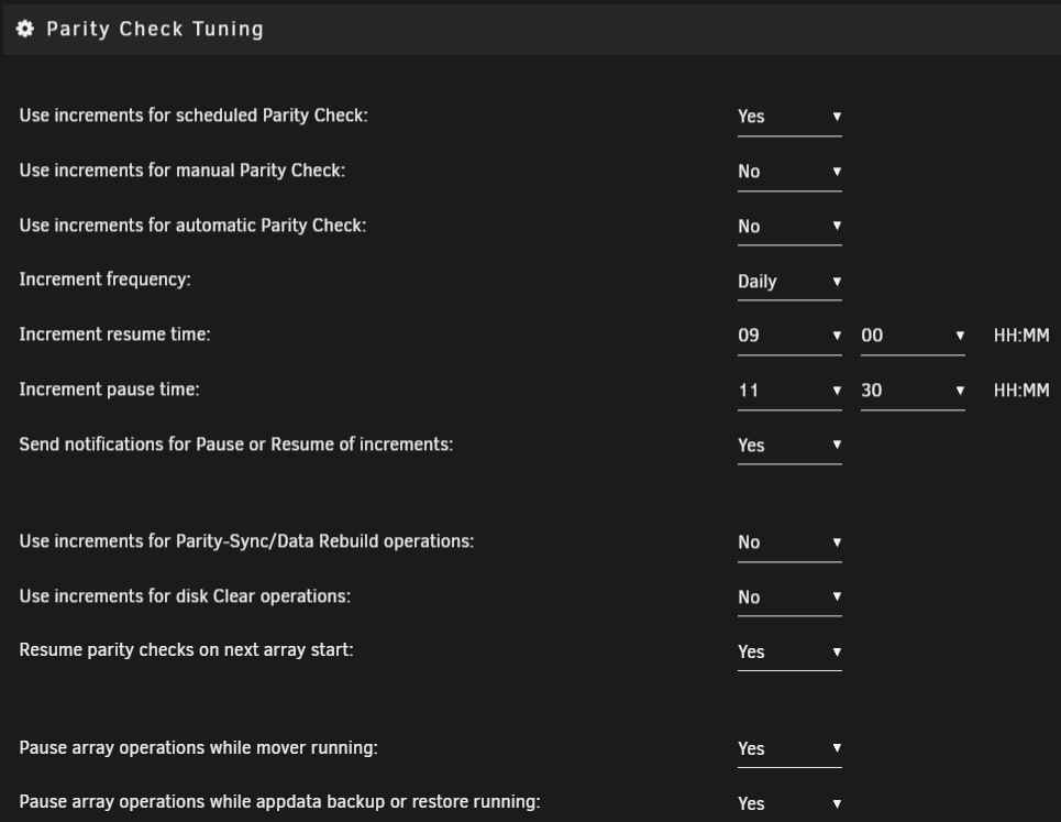

I’m having issues with my system whereby it’s crashing when a parity check is left running continuously.  If I manually resume for 20mins & pause for 45 mins it seems to be ok, but doing this manually is not great.
I’ve tried this add on which seems ideal but it doesn’t seem to be working for me. The pause occurs but the resume doesn’t.   Probably something I’m doing wrong, but would appreciate some help.
Settings shown below.  But effectively I’m trying to use custom with increment resume time ‘35 * * * *’ , and increment pause time ‘55 * * * *’
I do not see any reason why those settings will not work.   I use something similar when doing development/testing of the plugin.   If you want me to look any further then you should enable the ‘Testing’ mode of logging in the plugin and let me have the resulting logs ( via diagnostics).

Thanks.  Turned out a server reboot solved it and started working as expected.

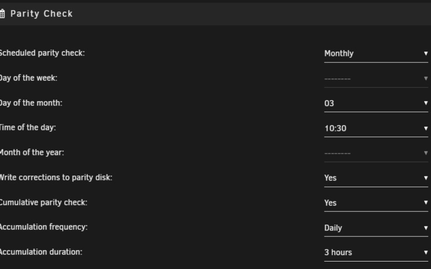

My server sleeps throughout the night and autoawakes in the morning, which means I want the parity check in the daytime. My setting:
336648952_FireShotCapture008-Tower_Scheduler-10.0.0_254.png.eea6e67518448efb1cdf42e9b89e4ab6.png1120665642_FireShotCapture009-Tower_Scheduler-10.0.0_254.png.a8385e90c54547976698b5d016d4a05a.png
The parity check started as sheduled and paused at the pause time. But the next morning after the array started the check didn't resume, forgetting it had imcomplete check task. Anything wrong with my settings?
Your settings are correct for what you want to achieve, but the option to Resume parity checks on next array start is currently broken.   I am currently working through testing of a version that fixes this issue.
