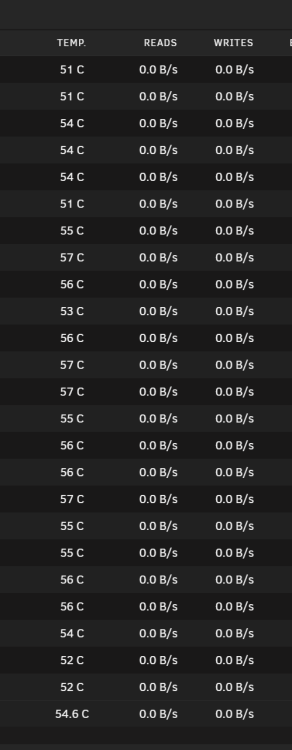

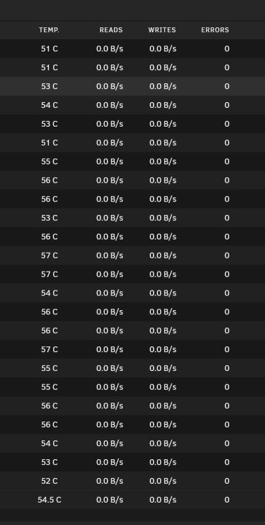

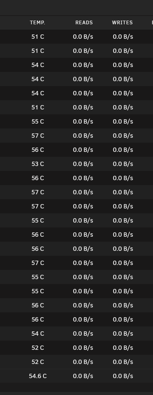

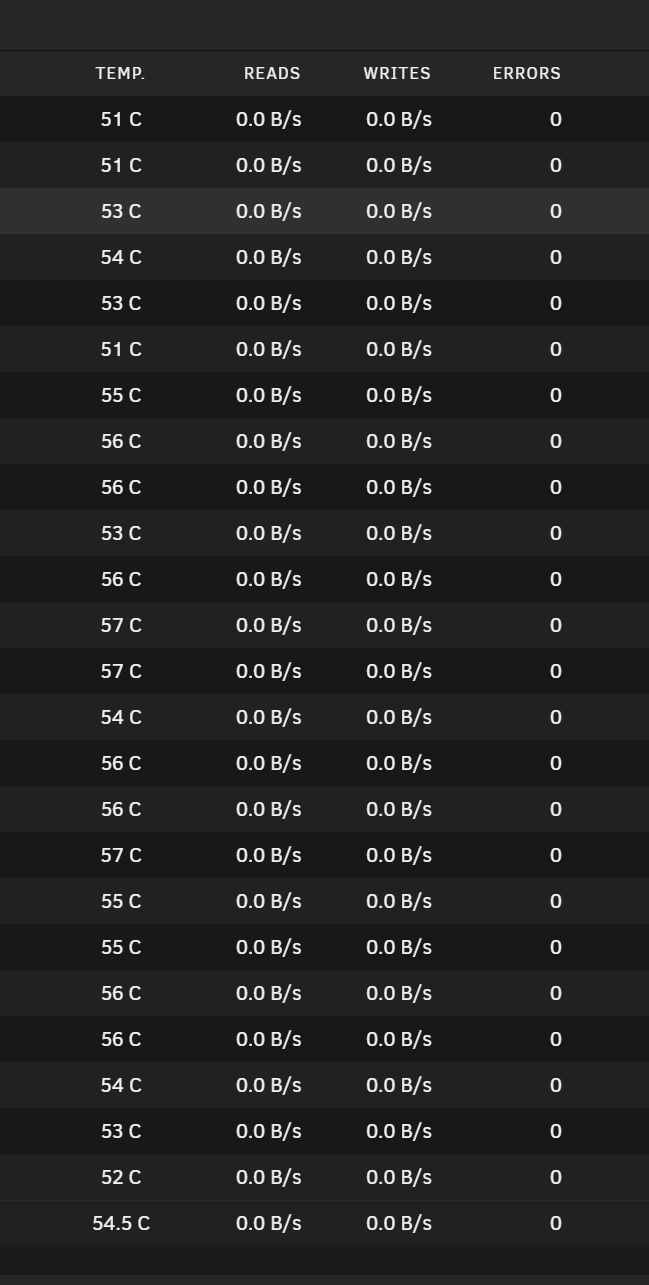

the parity check tuning clearly shows "Warm=0, Cool=0, Spundown=0" but there are several disks above 55c.
and heres a screenshot of the disk temps in the webui.

@rsbuc  I did not think anything had changed in this area but it looks like it might have done.    Can you please get me the testing mode log when the temperature should be detected as high so I can see what might be going wrong.    It is always hard to debug on my own system where I have to artificially force temperature events so never sure if it reflects real mode scenarios.
Sure! see attached
This log has my array going from normal temps to 57c which is above my CRIT level.
syslog.txt

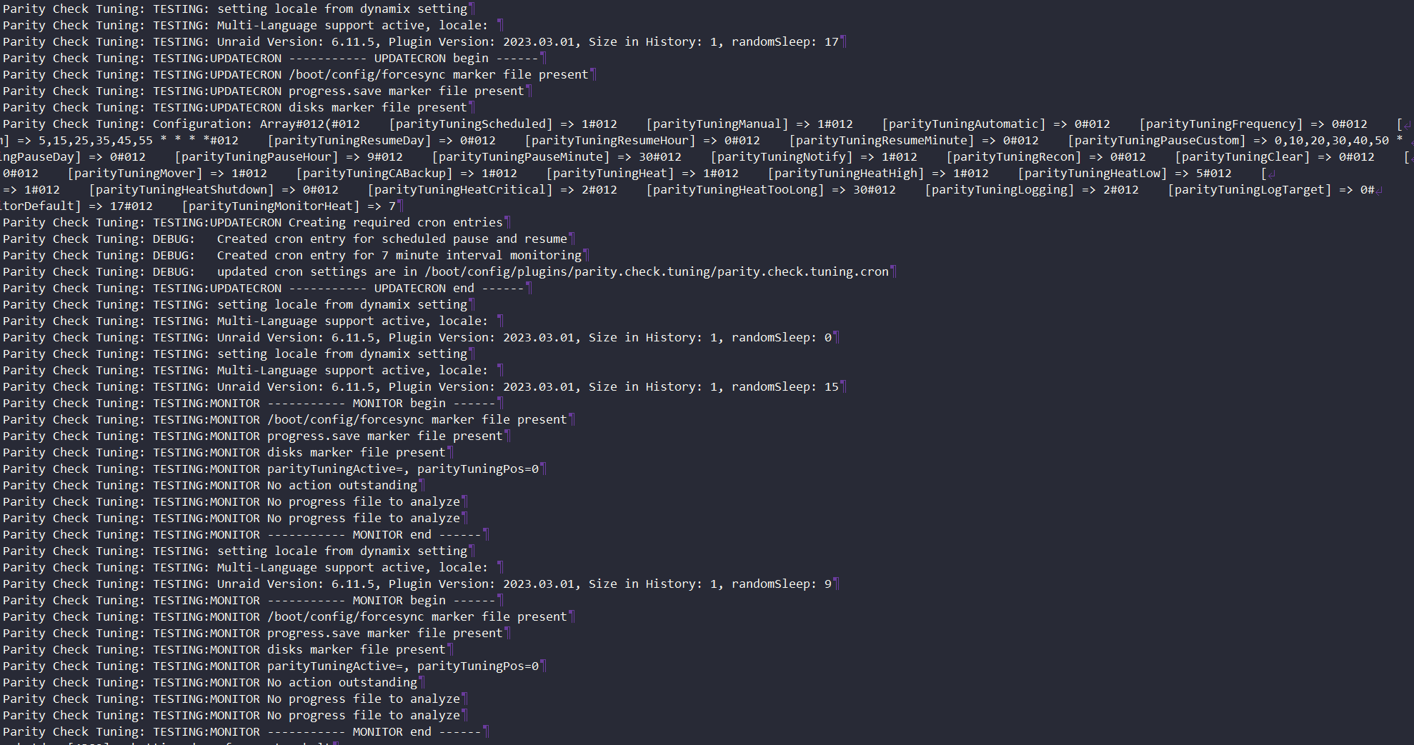

@rsbuc  Thanks for that log - it shows that for some reason the loop that is meant to loop through the drives checking temperatures is not being executed.    I just need to work out why.   My guess that I did something while tidying code for the 6.12 release that was incorrectly changed.

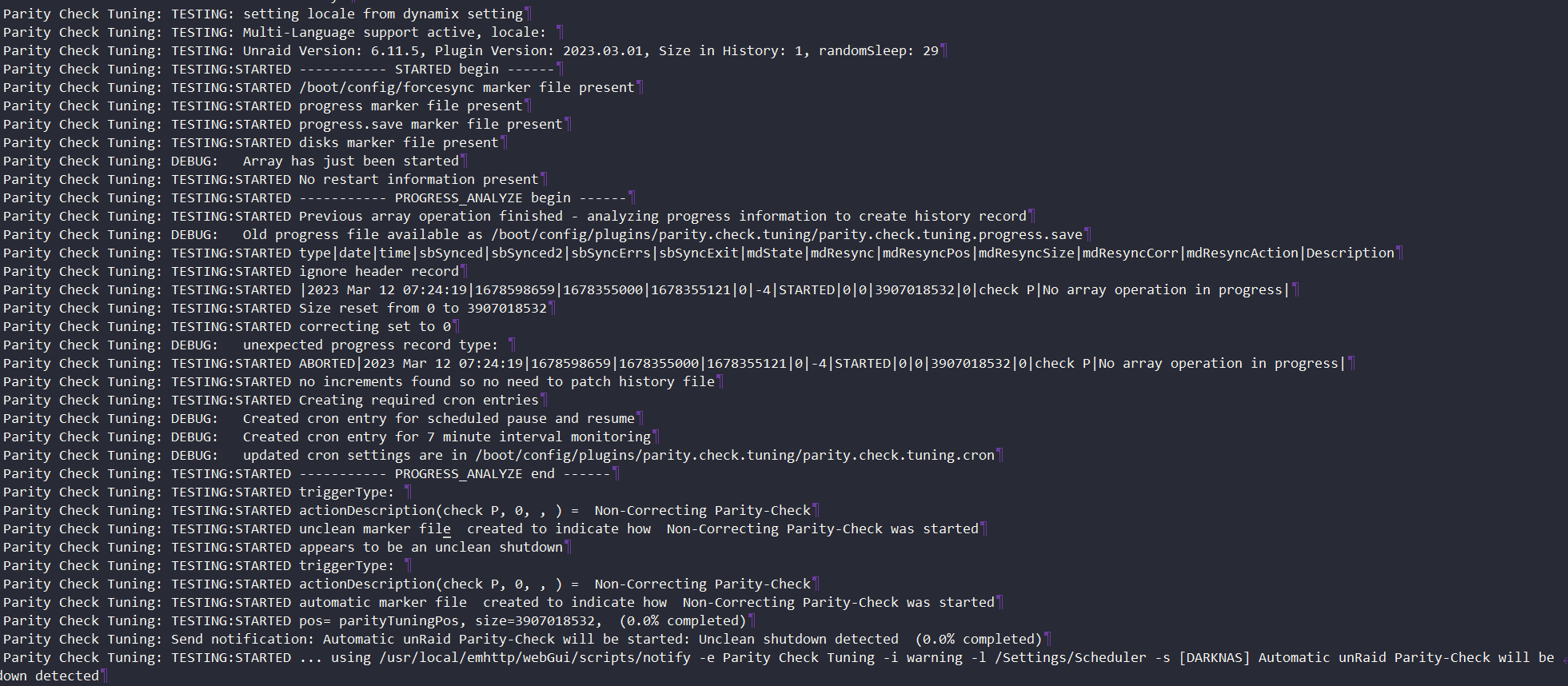

@itimpi
still have message of unclean shutdown but no parity started...
this is part of the end when shutdown:
part of start in morning when power on:
@rsbuc  The only way I can see that the temperatures for drives do not get checked is if the file /var/local/emhttp/disks.ini does not exist or has unexpected contents.  The code currently assumes it always exists with a specific layout.   Can you please check that you have that file and ideally if it does exist post a copy so I can check the contents as that is the place I get the temperatures from.
I can add a check to the plugin to flag an error if this file does not exist, and also look to see if I can get the same information from elsewhere in such a case.
@Masterwishx  Those snippets are insufficient to be certain but it is the presence of the file /config/forcesync on the flash drive (that is created by Unraid when the array is started) that makes the plugin think there has been an unclean shutdown.   A more complete log would be needed to look further.
I could obviously simply not generate the notification but it would be better to work out why it might be generated spuriously.  It is only meant to be an information message as the plugin is going to do nothing in such a case but better for it to be correct.
