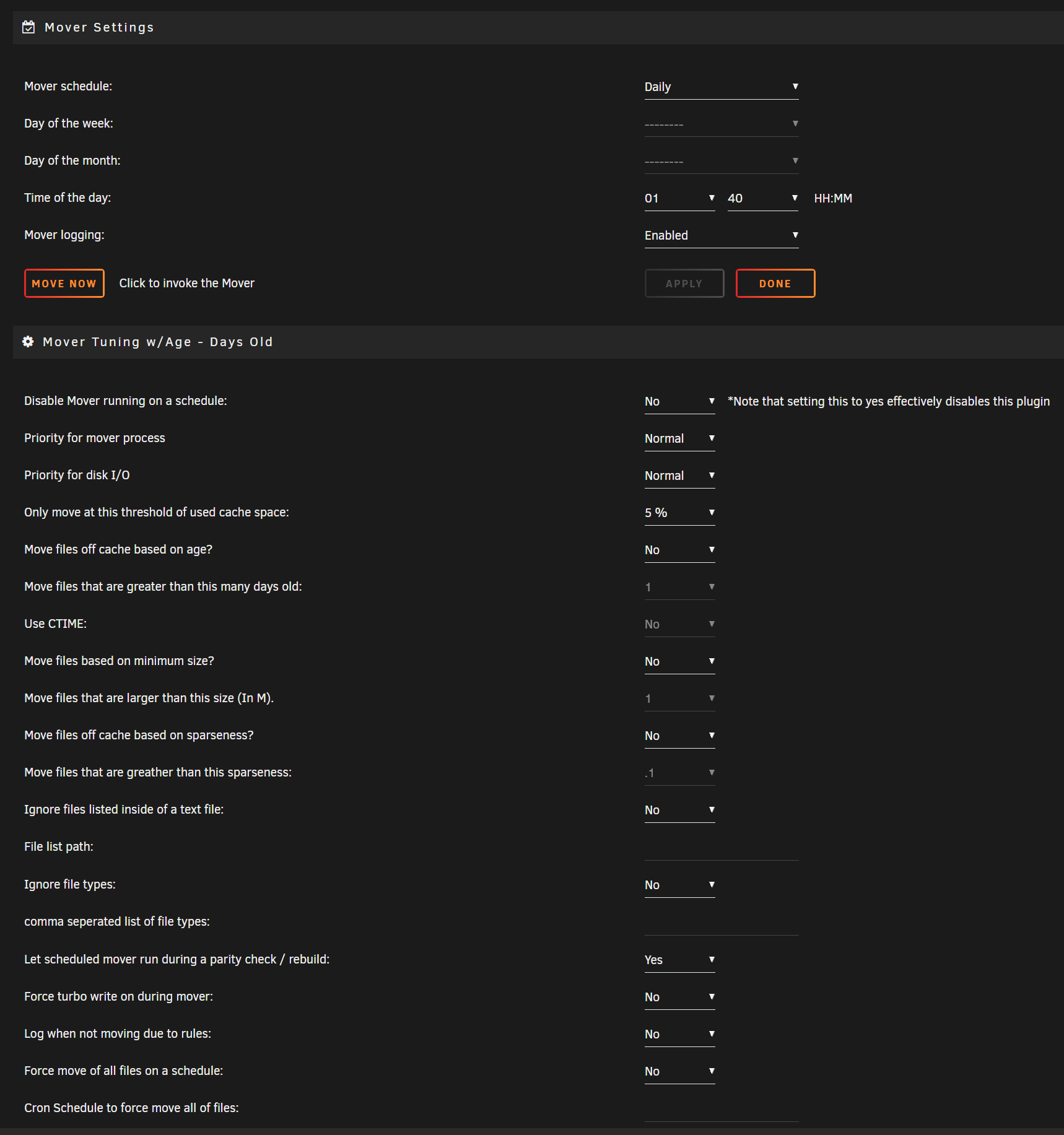

Oh ok, I did not have the big picture that there are actually two settings in different places that are interrelated:
Parity Check Tuning: Pause array operations while mover is running
Mover Tuning: Let scheduled mover run during a parity check / rebuild
I will set them as follows because I want mover to run daily, but not have a running Parity Check at the same time:
Parity Check Tuning: Pause array operations while mover is running: Yes
Mover Tuning: Let scheduled mover run during a parity check / rebuild: Yes
Correct?
I am happy that this is clear to me now. To help others to avoid this confusion maybe the help texts of both Tuning plugins for the above mentioned options could be amended to point out that there is an interrelated option in the other tuning plugin and what combinations lead to what result.
Thanks for the clarification.

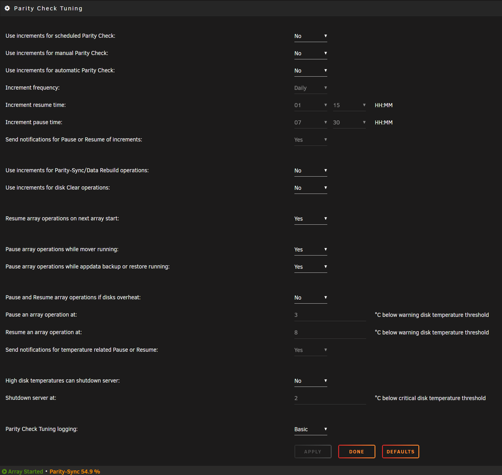

oddly i have mine set this way but for whatever reason it's not working properly.  I feel like there's some cron job running somewhere that is interrupting how this is supposed to work for me.  I have both those options you mentioned set to Yes but what happens for me is the Parity-Sync will indeed pause when mover starts running nightly at 1:40am.  Then in the morning i return to see that the Parity-Sync never resumed.  I'll check the logs to see that the mover did indeed finish a while ago.  So why did the Parity-Sync not resume?  At this point I can either wait for the random notification to pop up mid day that mover has finished and parity sync is resuming (even though I know mover to have finished hours previously) or I manually resume.
Maybe if I paste my settings someone can tell me where I brain farted?
snuts-diagnostics-20230629-1425.zip
Edited by DontWorryScro
Adding Diagnostics

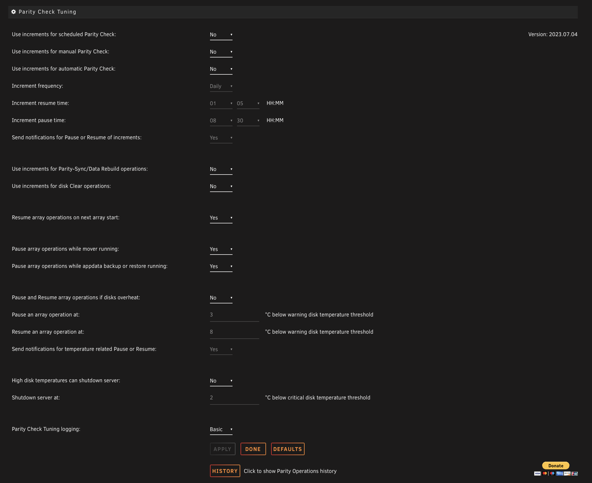

On 7/2/2023 at 8:41 PM, itimpi said:
I have not had a chance to review his change as I have been away from home this last weekend,, but it should be irrelevant to the issue you seem to have.
ok with Testing mode on the failure to resume the data rebuild occurred again over night.  The rebuild is still paused as I type this, even over 7 hours after the mover operation finished.
Diagnostics attached.
Edit: I also just now noticed after posting this that there was a Parity Check Tuning plugin update available to me now.  I've gone ahead and updated.  I also manually restarted the Parity-Sync.
2nd Edit: Shortly there after I notification popped up from Parity Check Tuning at 12:42 that "[SNUTS] mover no longer running"

Jul 4 12:42:24 Snuts Parity Check Tuning: DEBUG: Parity Sync/Data Rebuild running
Jul 4 12:42:24 Snuts Parity Check Tuning: TESTING:MONITOR ----------- MONITOR begin ------
Jul 4 12:42:24 Snuts Parity Check Tuning: TESTING:MONITOR /boot/config/forcesync marker file present
Jul 4 12:42:24 Snuts Parity Check Tuning: TESTING:MONITOR tidy marker file present
Jul 4 12:42:24 Snuts Parity Check Tuning: TESTING:MONITOR progress marker file present
Jul 4 12:42:24 Snuts Parity Check Tuning: TESTING:MONITOR automatic marker file present
Jul 4 12:42:24 Snuts Parity Check Tuning: TESTING:MONITOR paused marker file present
Jul 4 12:42:24 Snuts Parity Check Tuning: TESTING:MONITOR disks marker file present
Jul 4 12:42:24 Snuts Parity Check Tuning: TESTING:MONITOR mover marker file present
Jul 4 12:42:24 Snuts Parity Check Tuning: TESTING:MONITOR isArrayOperationActive - parityTuningActive:1, parityTuningPos:2622003844 Jul 4 12:42:24 Snuts Parity Check Tuning: TESTING:MONITOR ... not a parity check so always treat it as an automatic operation
Jul 4 12:42:24 Snuts Parity Check Tuning: TESTING:MONITOR backGroundTaskHandling: configName=parityTuningMover, value=1, isMoverRunning=0, Array: Active=1, Paused=0 Jul 4 12:42:24 Snuts Parity Check Tuning: Send notification: mover no longer running:
Jul 4 12:42:24 Snuts Parity Check Tuning: TESTING:MONITOR ... using /usr/local/emhttp/webGui/scripts/notify -e Parity Check Tuning -i normal -l /Settings/Scheduler -s [SNUTS] mover no longer running
Jul 4 12:42:25 Snuts Parity Check Tuning: TESTING:MONITOR Deleted mover marker file
Jul 4 12:42:25 Snuts Parity Check Tuning: TESTING:MONITOR Deleted paused marker file
Jul 4 12:42:25 Snuts Parity Check Tuning: TESTING:MONITOR ... no action required as array operation not paused
Jul 4 12:42:25 Snuts Parity Check Tuning: TESTING:MONITOR backGroundTaskHandling: configName=parityTuningBackup, value=1, isBackupRunning=0, Array: Active=1, Paused=0 Jul 4 12:42:25 Snuts Parity Check Tuning: TESTING:MONITOR Temperature monitoring switched off
Jul 4 12:42:25 Snuts Parity Check Tuning: TESTING:MONITOR ----------- MONITOR end ------
Jul 4 12:48:26 Snuts Parity Check Tuning: TESTING: ... not a parity check so always treat it as an automatic operation
Jul 4 12:48:26 Snuts Parity Check Tuning: TESTING: actionDescription(recon P, 1, AUTOMATIC, 1) = Parity Sync/Data Rebuild
Jul 4 12:48:26 Snuts Parity Check Tuning: DEBUG: Parity Sync/Data Rebuild running
Jul 4 12:48:26 Snuts Parity Check Tuning: TESTING:MONITOR ----------- MONITOR begin ------
Jul 4 12:48:26 Snuts Parity Check Tuning: TESTING:MONITOR /boot/config/forcesync marker file present
Jul 4 12:48:26 Snuts Parity Check Tuning: TESTING:MONITOR tidy marker file present
Jul 4 12:48:26 Snuts Parity Check Tuning: TESTING:MONITOR progress marker file present
Jul 4 12:48:26 Snuts Parity Check Tuning: TESTING:MONITOR automatic marker file present
Jul 4 12:48:26 Snuts Parity Check Tuning: TESTING:MONITOR disks marker file present
Jul 4 12:48:26 Snuts Parity Check Tuning: TESTING:MONITOR isArrayOperationActive - parityTuningActive:1, parityTuningPos:2642689172 Jul 4 12:48:26 Snuts Parity Check Tuning: TESTING:MONITOR ... not a parity check so always treat it as an automatic operation
Jul 4 12:48:26 Snuts Parity Check Tuning: TESTING:MONITOR backGroundTaskHandling: configName=parityTuningMover, value=1, isMoverRunning=0, Array: Active=1, Paused=0
Jul 4 12:48:26 Snuts Parity Check Tuning: TESTING:MONITOR backGroundTaskHandling: configName=parityTuningBackup, value=1, isBackupRunning=0, Array: Active=1, Paused=0
Jul 4 12:48:26 Snuts Parity Check Tuning: TESTING:MONITOR Temperature monitoring switched off
Jul 4 12:48:26 Snuts Parity Check Tuning: TESTING:MONITOR ----------- MONITOR end ------
snuts-diagnostics-20230704-1236.zip
7 hours ago, itimpi said:
Not using the plugin.
The easiest way might be to consider writing a User Script that you initiate after the parity check is started that keeps looking to see if the check is still running, and if not issues a shutdown.
Technically it would be easy to add a feature like this to the plugin but since it can be hard to accurately predict when a check would finish I am not sure how useful it would be in practice.  You might find the system suddenly shutting down unexpectedly while you were using the server.   If you can make a good Use Case for this feature I can consider adding it in a future plugin update (with the default being to NOT auto-shutdown).
ok yes, thanks for that hint.
I think my use case may be very special ^^
I have two unraid servers, the main one is online 24/7 and the second one starts every day for a backup and after that it shuts down again. But on the Backup server I also want to run parity checks, but I don't want to manually think about them, so I would just auto start the server and after the check is done it should shut down itself again.
The update should not be relevant to your issue but no point in not using the latest version :)
I have looked through the diagnostics that you provided and the strange thing I see is that I can see at 01:48:33 that the plugin's monitor task started but then I do not see it finishing!   At this point the plugins monitor task seems to stop running.   Since it is that that is meant to detect the mover has finished and it is time to resume the array operation the fact the monitor task is not running explains why the operation was not resumed.   However I know of no obvious reason that the monitor task should stop running - the only thing that should change is the frequency depending on whether the plugin thinks it is idling or not. :(    If you get the situation occurring again can you perhaps go into the console level and let me have the results of running
 cat /etc/cron.d/root
so I can check that it still contains the entries for running the monitor task at regular intervals.
That seems a valid Use Case so I may go ahead and add the option to close down the server when an array operation finished.   Of course I may then find it is not as easy to implement as I currently think is the case :)
this?

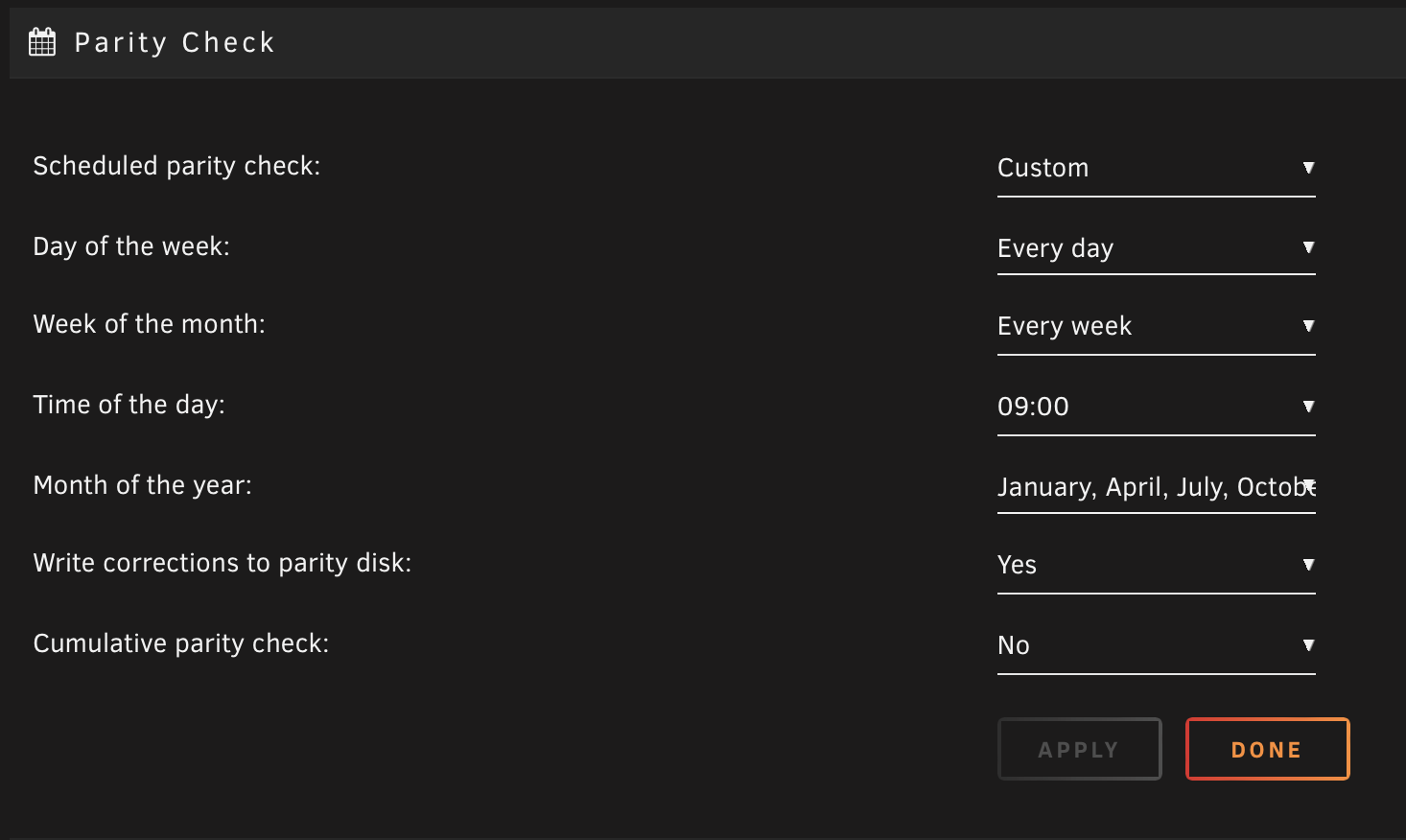

I cancel a parity check - why does it keep restarting the next day?
It IS set to allow a check everyday BUT only every 4 months...
882482064_Screenshot2023-07-08at09_03_59.thumb.png.6838482c2fbf49fd771b6f8ace39ee1a.png
1929588981_Screenshot2023-07-08at09_04_17.thumb.png.16e4690b75b93d3b5e18ce4f236dd96f.png
That is nothing to do with the plugin as it never initiates the parity checks.   It must be a bug in the core Unraid system that does not handle correctly your settings.
To be honest, I cannot see what you are trying to achieve.     Why would you want to start a parity check every day during some months, and not at all during other months.
The parity check schedule is the 1st of every 4th month. This can be any day.
After I skipped a parity check, For some reason unraid was continuing to start a parity check the next day.
I am not sure that is how your settings are being interpreted 😊.  It might be worth looking at the entry that has been generated in /etc/cron.d/root to see what is actually set.
What's the best way to look at a file in the ram system i.e /etc/cron.d/root
I'm still working out how unraids terminal commands work compared to normal linux.
The system error is this thats causing the conflict:
Jul 11 10:06:30 Moulin-rouge Parity Check Tuning: ERROR: marker file found for both scheduled and automatic  P
