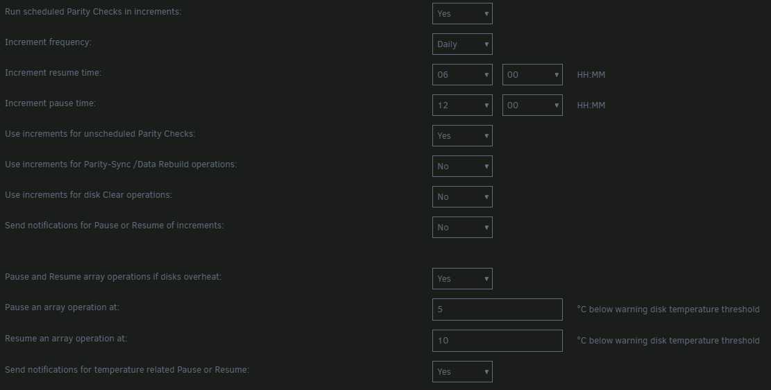

How is the temperature-based pausing and resuming of the parity check supposed to work? It seems like it ran through the entire time without pausing even though the debug messages clearly show drives were hot.
It does appear that the scheduled resume happened with all drives already hot/warm, does it only pause if a cool drive transitions to warm/hot? Perhaps there should be a check whether to start in the first place with the current temperature: some days are hot and it pushes them into the warm zone and the check shouldn't run at all.
Here is a log with the scheduled start time is 6am and end time is noon, but 2 drives are already hot, 3 warm. It appears to have run the whole way, repeating the message "drives=24, hot=2, warm=3, cool=19. Correcting Parity Check with all drives below temperature threshold for a Pause" every 5 minutes but not pausing. Highlights from the attached log:
Jul  3 05:55:01 tower parity.check.tuning.php: DEBUG: Monitor:  Parity check appears to be paused
Jul  3 05:55:01 tower parity.check.tuning.php: DEBUG: drives=24, hot=2, warm=3, cool=19
Jul  3 05:55:01 tower parity.check.tuning.php: DEBUG: Array operation paused but not for temperature related reason
Jul  3 06:00:01 tower parity.check.tuning.php: DEBUG: Resume request
Jul  3 06:00:01 tower parity.check.tuning.php: DEBUG: drives=24, hot=2, warm=3, cool=19
Jul  3 06:00:01 tower parity.check.tuning.php: DEBUG: ...configured scheduled action for Correcting Parity Check
Jul  3 06:00:01 tower parity.check.tuning.php: DEBUG: Array operation paused but not for temperature related reason
Jul  3 06:00:06 tower parity.check.tuning.php: DEBUG: Resumed Correcting Parity Check  (23.1% completed)
Jul  3 06:05:01 tower parity.check.tuning.php: DEBUG: drives=24, hot=2, warm=3, cool=19
Jul  3 06:05:01 tower parity.check.tuning.php: DEBUG: Correcting Parity Check with all drives below temperature threshold for a Pause
Jul  3 12:00:01 tower parity.check.tuning.php: DEBUG: Pause request
Jul  3 12:00:09 tower parity.check.tuning.php: DEBUG: Pause of Correcting Parity Check  (50.9% completed)
Also, I have 5 drives (2 hot, 3 warm), not 24. All 19 cool drives do not exist.

You have uncovered a bug in the code for pausing on drives over-heating and I will rectify this.   When you have activated temperature related pause/resume then you will get a monitor task running every 5 minutes to check temperature - that is the "Monitor" log entry that is in your log.   If temperature monitoring is not active then this task is not needed. so you get a lot less logged.   The other resume/pause log entries are from the standard (not temperature related) pause/resume entries
What is MEANT to happen is that the Monitor task will list the overheated drives (assuming debug logging is active) each time following the summary message and then pause the parity check that is running.   It is this list + pause code that has the bug so that the pause is not taking place.
I think the fact you have 19 "cool" phantom drives listed will be because you have 24 slots set on the Main tab (i.e. you have not reduced it to the number of drives you actually have).  Can you confirm if this is the case?  If so I need to add a check for slots allowed but not currently having a drive assigned to them to correct this count.  If that is not the case then I need to do further investigation to determine why the drive count might be wrong in your case.

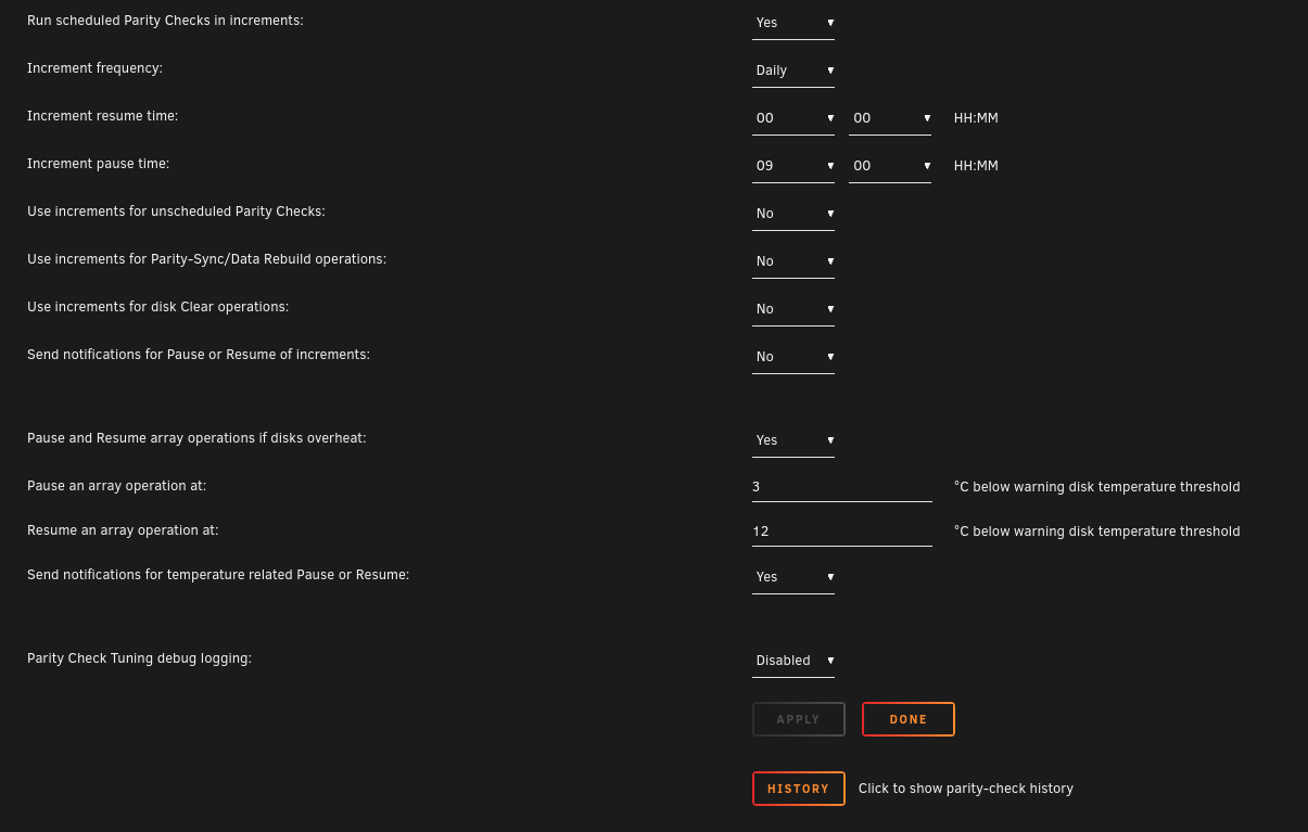

First, thanks for this very handy plugin.
I think there are minor bugs in the temperature-pausing code:
  1. The assigned-slots check (which I believe you just added) reports an incorrect total. I have 3 array disks, 2 cache disks and 4 Unassigned Devices disks. The plugin shows 4 total (I assume array) disks
  2. Parity check is paused with hot=1, warm=2, cool=1 and resumed with hot=1, warm=1, cool=2. Seems like pause/resume should be based on hot alone
  3. The PAUSE debug reports the label of the overheated drive as "temp"

1. I will have to see if I can reproduce the problem you are seeing with the drives not having the number being listed correctly.  Any chance you can ssh into your system and make a copy of the file /var/local/emhttp/disks.ini.    That should give me the information I need to work out why the number of disks being reported is wrong.    Probably going to be something trivial to fix once I have an example from your system to work from.
2. It looks like there may be a bug in the Resume code in not correctly checking that all drives have cooled enough to resume - something I need to see if I can work out why.
3.   Worked out why you are getting a drive listed as ‘temp’ rather than the correct name - a case of a missing ‘$’ on a variable name so easy to fix.

I think I have now fixed all 3 issues reported and am now doing some testing to check no obvious new bugs introduced.   I have made an additional log level of ‘testing’ available via the GUI in case I ever want a user to activate it.  Previously this was controlled by a local variable I set at my end but adding it to the GUI makes it easier to switch on/off and also means I will not accidentally issue a release with it left activated.
thanks for the disks.ini - it showed me that I was not correctly handling the case of a parity2 disk not being present when working out what slots contained drives.
The plugin ignores non-array drives - I am changing the message giving the count to make this clearer.
I have just pushed what I hope is the ‘fixed’ version of the plugin to GitHub.    Let me know if you notice any further anomalies/bugs.
I just updated and tested. (1) and (3) are fixed but re: (2) it looks like PAUSE (correctly) references the highest temperature disk but RESUME references the lowest temperature disk (it should be highest). Still, plenty good enough. Thank you.

Unraid was performing a parity check and it kept  saying temp to high pause parity.
But when i check the temp of the parity disk it wasnt too high.
The warning temp is set at 50 C.
When checked the smart it says. Current 37 during parity check and Max temp 42.
So how can the parity check say temp is too high?
1964074660_Screenshotfrom2020-08-0316-30-40.thumb.png.8f66a8e81228553c7f856a2cf4c7e80b.png
Aug  2 12:29:46 ThaNekos kernel:
Aug  2 12:30:02 ThaNekos parity.check.tuning.php: Paused Read-Check  (24.2% completed) : Following drives overheated: temp temp
Aug  2 12:30:02 ThaNekos kernel: mdcmd (910): nocheck PAUSE
Aug  2 12:30:05 ThaNekos kernel: md: recovery thread: exit status: -4
Aug  2 12:34:46 ThaNekos kernel: mdcmd (911): set md_write_method 0
Aug  2 12:35:01 ThaNekos parity.check.tuning.php: Resumed Read-Check  (24.2% completed)  as drives now cooled down
Aug  2 12:35:01 ThaNekos kernel: mdcmd (912): check RESUME
Aug  2 12:35:01 ThaNekos kernel: md: recovery thread: check ...
Aug  2 12:39:47 ThaNekos kernel: mdcmd (913): set md_write_method 1
Aug  2 12:40:03 ThaNekos parity.check.tuning.php: Paused Read-Check  (24.4% completed) : Following drives overheated: temp temp
Aug  2 12:40:03 ThaNekos kernel: mdcmd (914): nocheck PAUSE
Aug  2 12:40:06 ThaNekos kernel: md: recovery thread: exit status: -4
Aug  2 12:44:47 ThaNekos kernel: mdcmd (915): set md_write_method 0
Aug  2 12:45:01 ThaNekos parity.check.tuning.php: Resumed Read-Check  (24.4% completed)  as drives now cooled down
It does not look as if you have the latest version of the plugin?   There have been some fixes released in the last few days that relate to temperature related pause/resume.   You can upgrade the plugin even if you already have a parity check running and the fixes should kick in.
if you still get unexpected results using the latest version of the plugin (2020.08.03) then please enable the “Testing” log level for the plugin in Settings->Scheduler and post (or PM me) the results.   When testing the temperature related feature I have to artificially force the conditions for pause/resume as normally my disks do not overheat so it is always possible that I am missing some real-world conditions.    That level of logging should tell me exactly what is going on so I know what to look for that might need fixing.
yea i just say the update and did the update.
Aug 3 17:30:01 ThaNekos parity.check.tuning.php: DEBUG: -----------MONITOR start------
Aug 3 17:30:01 ThaNekos parity.check.tuning.php: DEBUG: array drives=6, hot=0, warm=0, cool=6
Aug 3 17:30:01 ThaNekos parity.check.tuning.php: DEBUG: Read-Check with all drives below temperature threshold for a Pause
Aug 3 17:30:01 ThaNekos parity.check.tuning.php: DEBUG: -----------MONITOR end-------
i enabled the Debug normal that is off. But i see 6 drives which is correct for the array.
It doesnt check the  Cache ones?
No, it is only checking array drives as they are the only ones which take part in parity checks (or other long running array operations).     If a sensible use case could be made for cache drives overheating to pause main array operations it would be easy to add that, but it has not seemed something to consider at the moment.
if you increase the log level to “testing” you will get even more detail about each drive as it is checked.
once you are happy that things are working as expected I recommend that you disable the debug logging to minimise writes to syslog.
FYI:   Hot means reached pause threshold temperature
        Warm means between pause and resume thresholds
        Cool means temperatures below threshold for resume.
