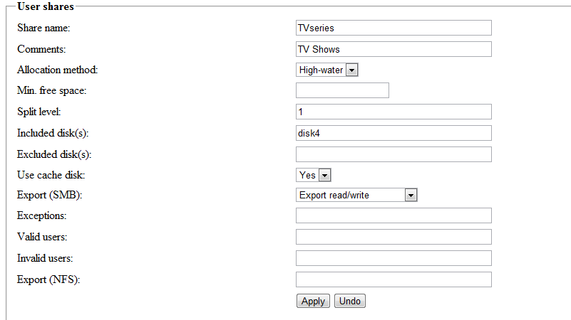

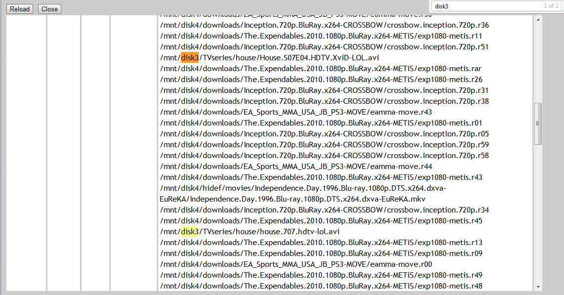

i'm definitely having problems with the included disk section.
I have a share set to only put things in disk4. At first every worked fine, but that was because disk 4 had the most available space (it was a brand spanking new drive). After a few months as the size got reduced and high water allocation kicked in, it now puts the stuff in other disks.
Here is a pic of my share configuration and see how things in that folder are on the wrong disks;

Using include only is working just fine for me.
Try maybe moving the files and making sure the directory all the way to the root TVseries directory on disk3 is deleted then set and Apply the share settings before rebooting the machine to ensure any past knowledge of the share being on disk3 is deleted.
Peter
they fall in disk 2 and others as well. Does the split level maybe play a role?
I have the split level set to 1 but within TVseries i have folders like House,entourage, etc...
The split leve should not have any effect.
Peter
