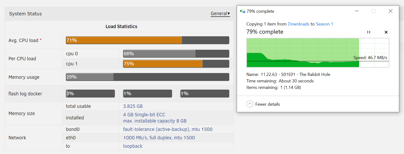

My parity drive completed overnight, and got the following speeds when transferring a file this morning:
Speeds start off at 110MB/s or so, but then drops off significantly.

That write speed to the parity array is normal with the default setting for parity calculation. The burst of speed at the beginning is just memory caching.
