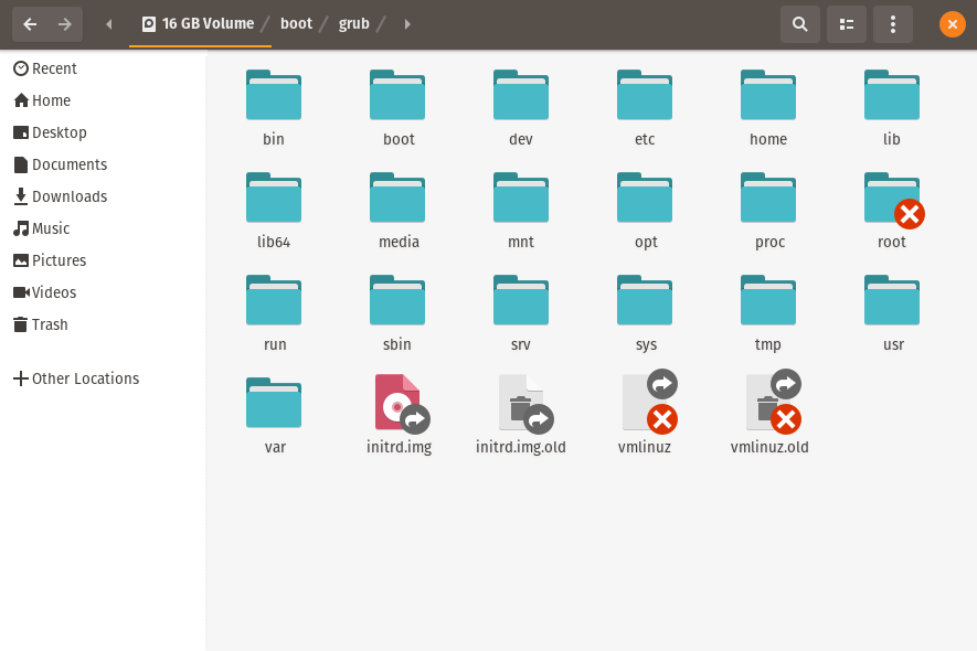

I rebooted my server and the USB-drive became unbootable. I opened a Linux-live machine and saw, that the USB-drive has been overwritten with what seems to be the filesystem of the array and not the flash-drive.
Picture is attached to this post.
I have NO idea what has happened, and it is obvious that the USB-drive has been overwritten.
Are you sure that is the folders on your Unraid flash and not the folders on your linux-live? Some of that doesn't even exist anywhere in Unraid so it's hard to imagine a way it could have been copied to the Unraid flash from within Unraid.
It might be, but I've make a Linux-live drive from a 32GB USB drive, and it shows up as a 16GB volume in the Live-OS, which matches the USB-drive where I have UnRaid.

I agree with @trurl - this does not look like the normal Unraid folders - On my 6.6.7 machine (set up as a basic NAS device) I do not have folders "media" "opt" and "svr" so it looks to us as though you are looking at something else.  What to you see in those folders?  What do you see in the "boot" folder.  It may give a clue as to what happened.
Yeah, it seems like I've been mistaken due to the fact, that the size of the volume was misrepresented in my Live OS.
