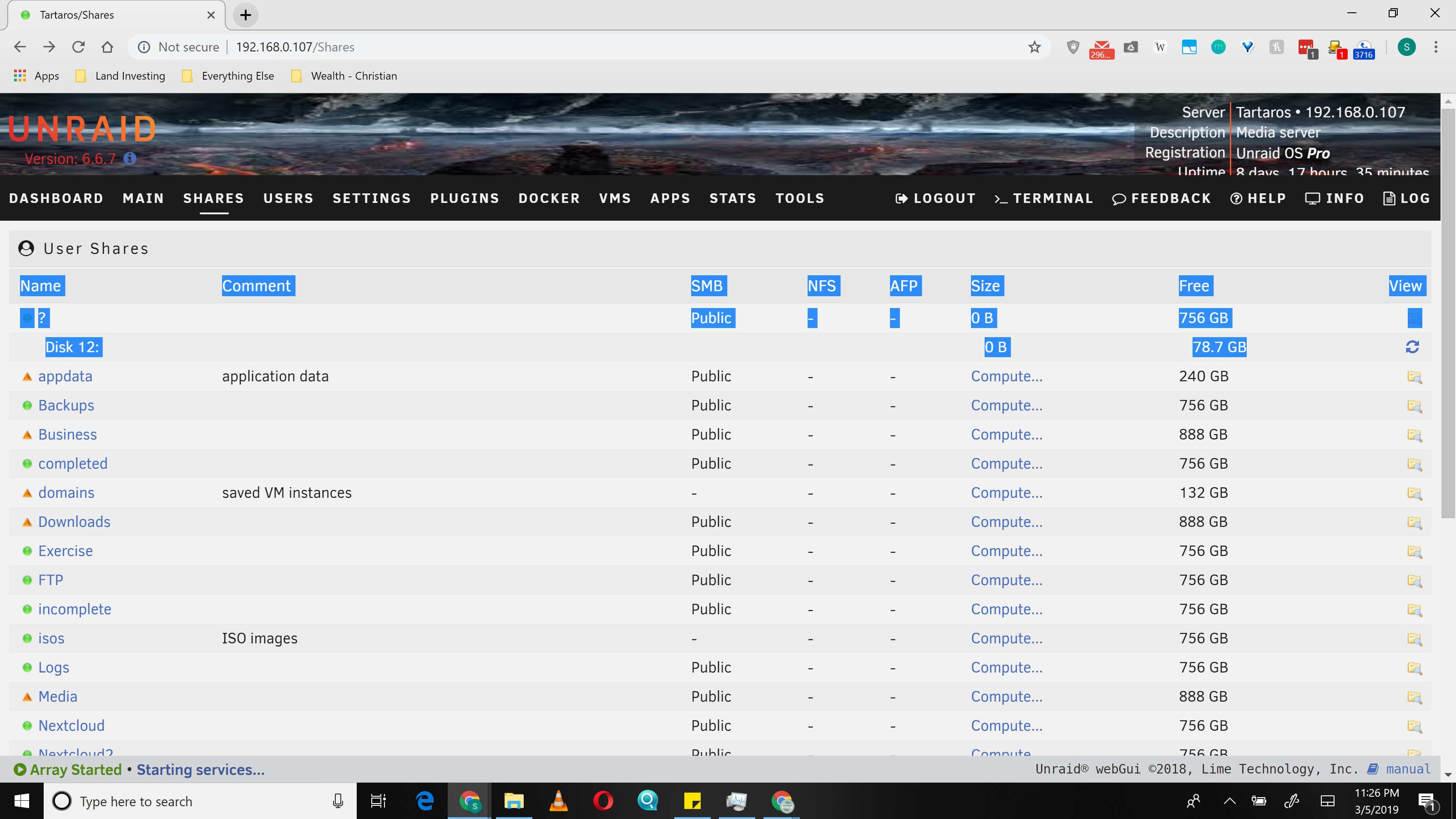

Go to Shares - User Shares and click the Compute... link beside that share, wait for the results, and see what disk(s) it is on.
Name        Comment   SMB       NFS    AFP    Size   Free           View
?                                Public     -                  -0 B    756 GB
Disk 12:                                                         0 B    78.7 GB
Well, it is empty, so you should be able to delete it from the webUI simply by clicking on it to get to its page. Assuming the webUI doesn't choke on the special character. That still doesn't explain how it got created in the first place of course.

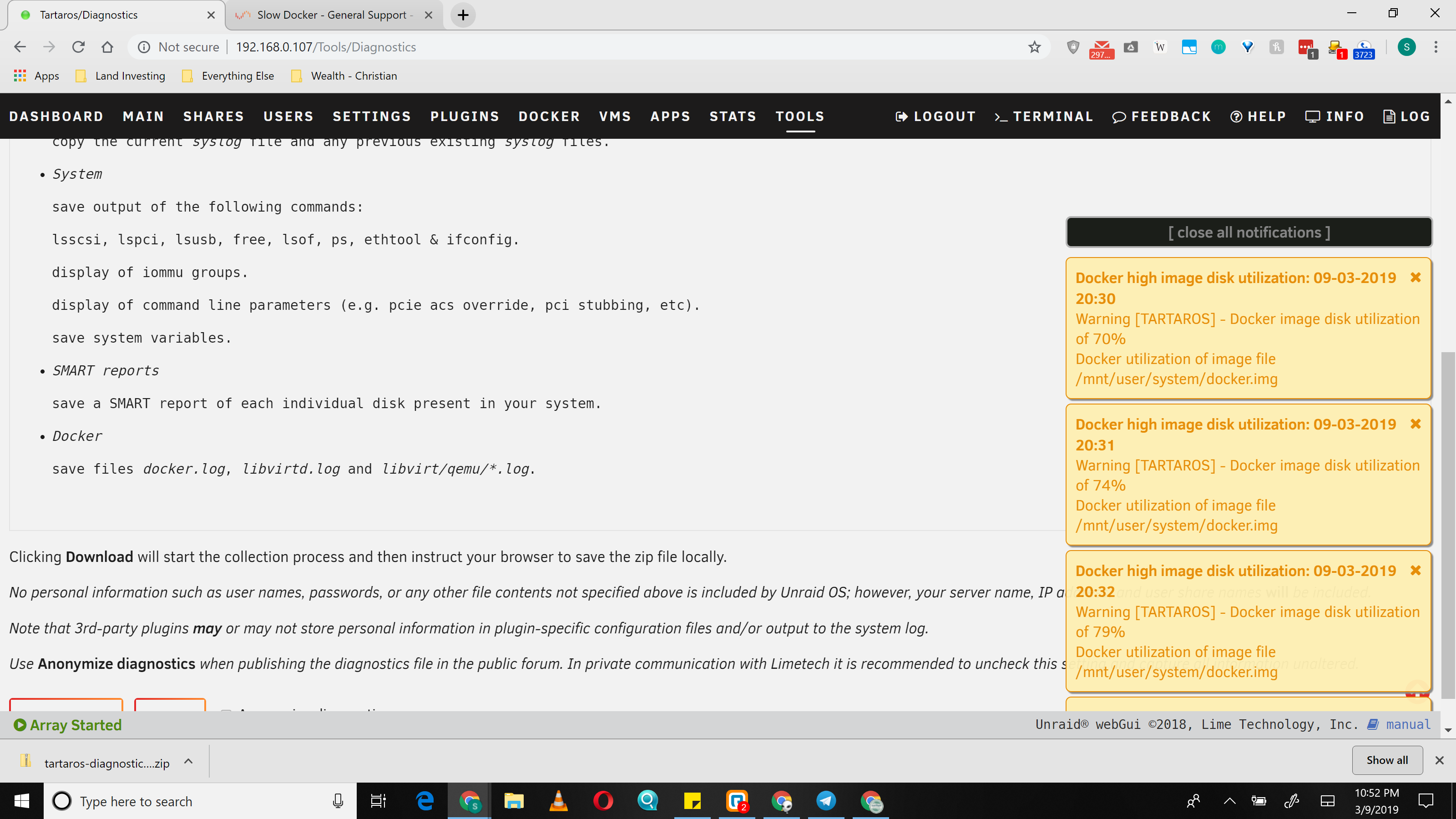

Ok, so i re-added a lot of my previous docker, and now i'm getting filled up with "Docker high image disk utilization" messages.  I attached a diagnostic.
tartaros-diagnostics-20190309-2250.zip
You have misconfigured one of your docker applications, causing it to write into the docker image instead of to mapped storage. This would be something within the particular application settings, not in the docker settings for the application.
Every path the application uses must be a path in a mapped container volume. Common mistakes are not using the same upper/lower case as you used in the volume mappings, or using a relative instead of an absolute path (must begin with /).
There is a section in the Docker FAQ about "Docker Image Filling Up":
https://forums.unraid.net/topic/57181-real-docker-faq/
