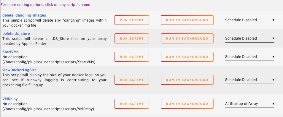

Hello! I've tried to setup today this but it seems the array never starts, it get stuck in "Mounting drives". If I remove the script then it starts correctly. I'm running on 6.7-rc5... maybe that's the problem? 🤔
Nope. Your problem is it's not just one script. It's 2 scripts. The top script is set to "At startup of array", the bottom script isn't set to auto start, it's called by the first script. There is a reason I posted it like I did. Name the first one whatever you want, and set it to auto start. The second script MUST be named StartVMs, exactly, and not auto started.
oh damn, I thought it was just one. Sorry! will try again.
Thanks!
Just tried it but still not working.
I'm making sure that from the server I can ping the pfSense machine and it works fine. So this command "ping -c 1 -n -w 1 10.0.1.1" is working.
I'm also seeing the first script (I called it VMDelay) on the logs

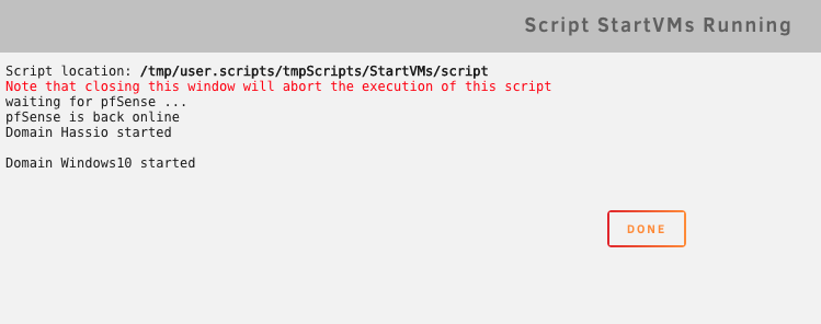

But after pfSense is back online the other script is not triggering. However if I run it manually from the User Script panel by hitting the "Run Script" button then it turns on my other VMs.
I'm probably doing something wrong but not sure how to debug the mistake 🤔
Edited by bluepr0

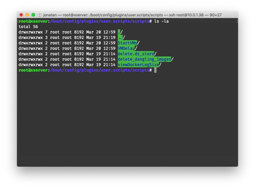

Check to see if that is exactly the name of your StartVMs script. I can't check mine right now, but try navigating to that path and see if the script exists there.
Seems like it's there indeed.
Edited by bluepr0

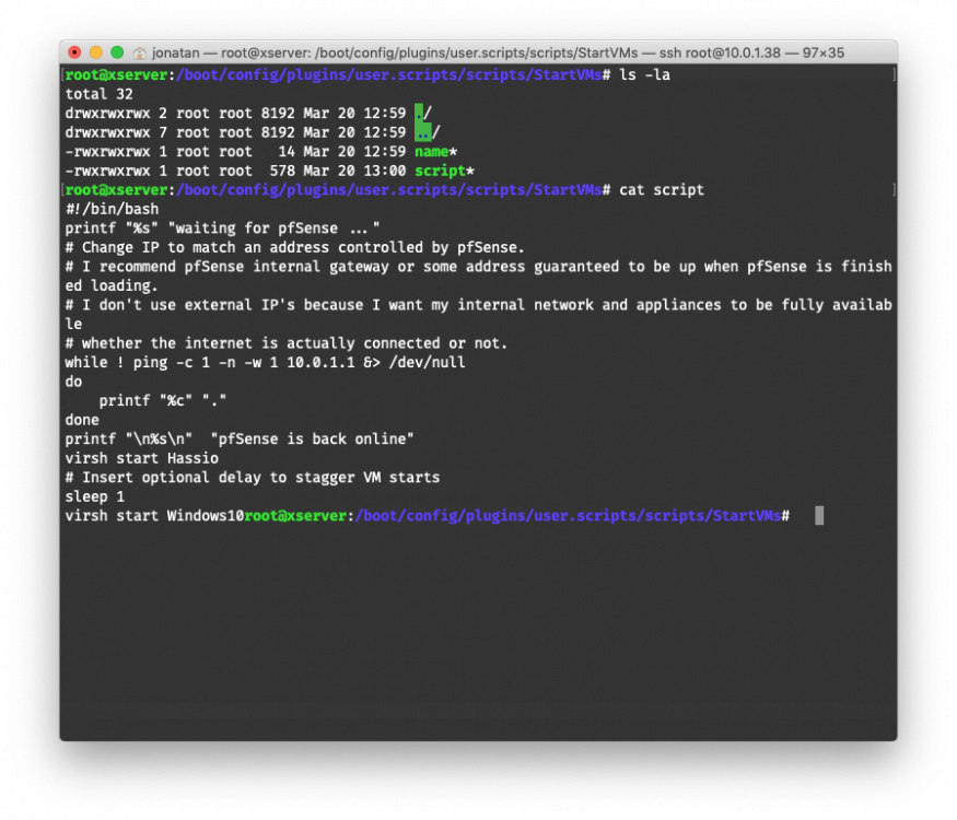

Can't tell from that screenshot. What's inside the StartVMs folder?
Sorry, this should do it.

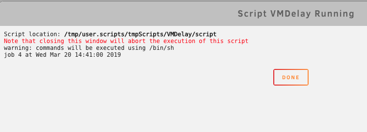

What's the output if you click "run script" on the VMDelay?
This should be it
That output looks correct, did it kick off the StartVMs script?

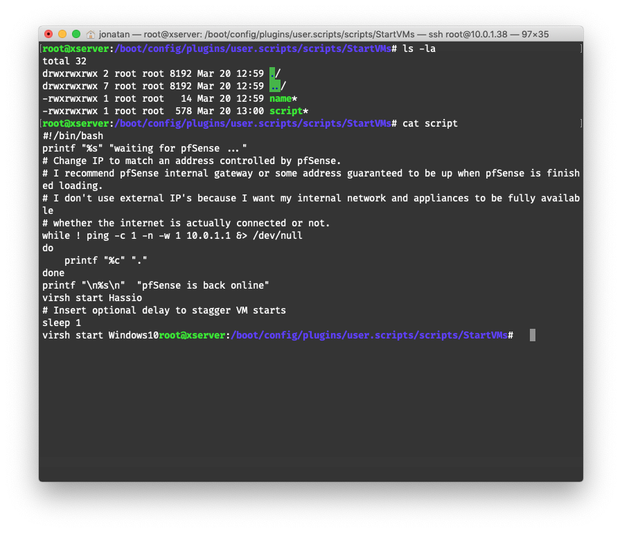

BTW, if you copied and pasted from the forum, it can introduce stray characters. It's best to type this kind of stuff out manually, or paste it into an editor that will show you all the raw characters like notepad++.
Nope, if I run the VMDelay script it runs fine but it doesn't fire the other script it seems, at least the VMs are not getting started. If I run manually StartVMs they do get started so I would guess it's not a problem of the script itself.
I did copy and paste the script on Atom to modify and then paste it on the script file on unRAID
However here's the text as well
#!/bin/bash
printf "%s" "waiting for pfSense ..."
# Change IP to match an address controlled by pfSense.
# I recommend pfSense internal gateway or some address guaranteed to be up when pfSense is finished loading.
# I don't use external IP's because I want my internal network and appliances to be fully available
# whether the internet is actually connected or not.
while ! ping -c 1 -n -w 1 10.0.1.1 &> /dev/null
do
    printf "%c" "."
done
printf "\n%s\n"  "pfSense is back online"
virsh start Hassio
# Insert optional delay to stagger VM starts
sleep 1
virsh start Windows10
