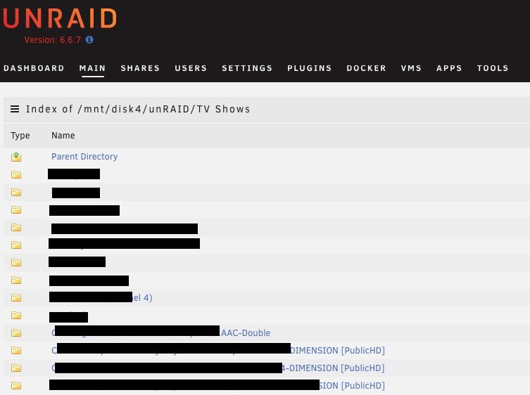

Go to Main - Array Devices, click on the folder icon at the far right in the View column for Disk4, then post a screenshot.

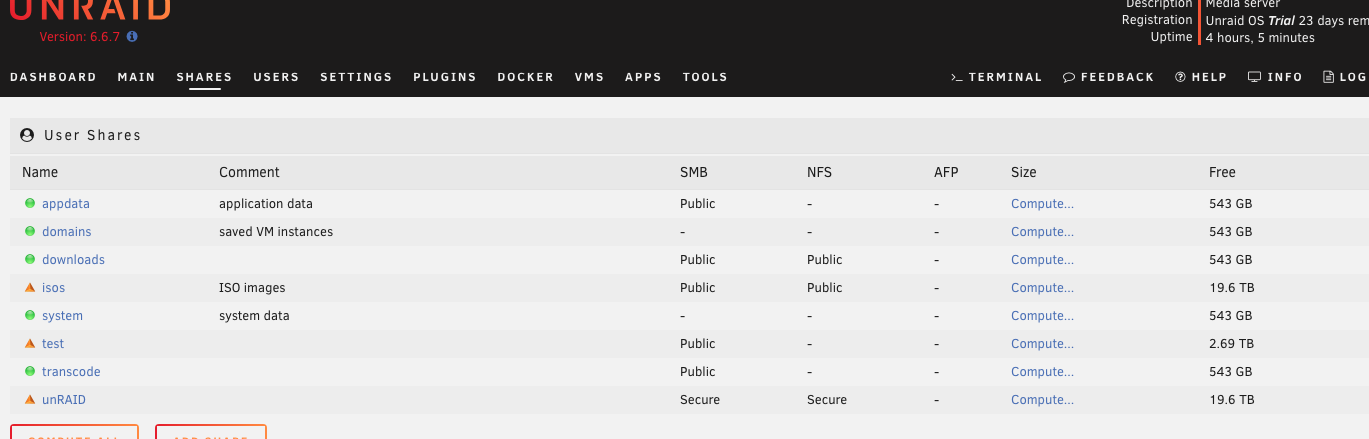

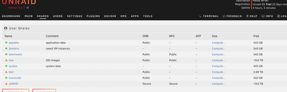

Go to Shares - User Shares and post a screenshot of that also.
Yes I used unBALANCE.  I moved /mnt/disk1/unRAID/TV Shows to /mnt/disk4/unRAID/TV Shows.  The former director is empty on the disk1 as well as in the SMB share.  It's full on disk4, but I can't see that on the share.
Here are both images.
