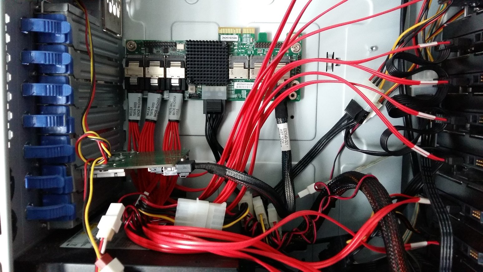

Cheapest would be something like this, using an existing ATX case:
You can get an used Intel SAS2 expander for around $60.
As @johnnie.black pic show, those are typical cheapest solution, buy a SAS HBA + SAS expander, usually were LSI base.
I got Lenovo expander ( also LSI base Maxim base, may be MAX72044B ) in ~USD 40 and 10. Depends on card's firmware, Intel one will be more smaller in size and can power by PCIe slot or molex. You can connect in 1 uplink to HBA and remains 5 port for 20disks or 2 uplink and remains 4 ports for 16 disks. Just ensure at least SAS2 speed level.
Could I ask what the card on the back plane is?     I believe that the card in the back is a SAS expander card using molex for power but I'm not sure what the other card in the picture is.    I got here because I was looking into an external USB enclosure for unraid but agree that SAS is best and using external cases would work great.
I read the message under yours but am still confused.    I am completely unfamiliar with SAS technology and how the drives eventually make it to the actual host in this case.    I've found external SAS cables that are 6' long and assume that's what you're using to connect the boxes.
Thank you.
The expander in an Intel RES2SV240, the other is just an adapter from SFF-8087 to SFF-8088, like this:
https://www.amazon.com/SFF-8088-SFF-8087-Female-Adapter-Bracket/dp/B071D5XTVJ
Because a SAS expander is being used, cables form main box HBA and SAS expander can be up to 10 meters total, including the cable from adapter to expander, but you want to keep the as small as possible, from SAS expander to SATA disks you're limited by SATA max cable length (1 meter)
Awesome!    So you have two (or could have similar) Intel RES2SV240 cards, one in the actual host machine that plugs into a "hot" SAS port, use a cable out the back to the second Intel RES2SV240 card in another machine where this is pictured?
Thank you.     I'm not familiar with SAS equipment, but am learning.
The expander connects to a SAS HBA, though it could connect to another expander if needed.
There are no need 2 expander connect each other, each port have 4 pair link ( that's why a 2 internal port will name 8i ), so it may connect 4 SATA/SAS device or host to host. SAS could connect in different way.

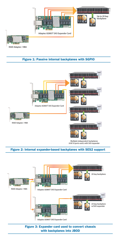

Few days ago, I got another non-LSI expander, it is Adaptec AEC-82885T ( same as Intel RES3FV288 ). It is a SAS3 expander have 2 external port and 7 internal port (8e28i or 36port), ready for future build.  Below are some example.
