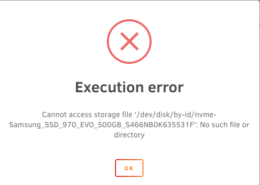

Here's my issue. If i keep my primary drive code will passthrough the nvme controller it will show me this message.
If i remove the disk portion(shown below), it will go into an eternal bootloop. I can't figure this out for my life. Would appreciate any guidance.

Remove the disk portion then add <boot order='1' /> under then section where the nvme controller is added. Insert it in right after the address domain line. It won't know to try to boot it without that line.
I tried this but didn’t work for me. Still went into eternal bootloop
I thought I added it but you need to add a boot order line under your nvme pass through section in the xml.
Sent from my SM-N960U using Tapatalk
Add this to the section
boot order='1'
boot order='1'
Yep you mentioned that. I managed to fix it afterwork. My windows installed pre controller passthrough seems to kept crashing. I switched over to Seabios, reinstalled windows and everything is working like a charm! Thanks David for your help.
