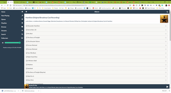

knex666 Posted May 20, 2020 Author Share Posted May 20, 2020 5 hours ago, GooseGoose said: and my snapserver post arguments: snapserver -s pipe:///data/snapfifo-test1?name=Test1&sampleformat=44100:16:2 -s pipe:///data/snapfifo-test2?name=Test2&sampleformat=44100:16:2 i have also tried: snapserver -s pipe:///data/snapfifo-test1?name=Test1&sampleformat=44100:16:2 snapserver -s pipe:///data/snapfifo-test2?name=Test2&sampleformat=44100:16:2 but the snapcast player on my phone only seems to pick up the first pipe file. Is this how i should be trying to do multiple streams? I am also getting a weird issue with the second instance of mopidy3 where i click play and the audio works perfectly but it looks like it skips all of the songs on the front end. Do you know what would be causing this? cheers You cannot use the -s pipe multiple times. just use 2 snapcast container with a different adress. The Issue: Are you running Spotify? I had some troubble with a non valid configuration / authorisation with Spotify that endet like this. Cheers Quote Link to comment
GooseGoose Posted May 20, 2020 Share Posted May 20, 2020 11 hours ago, knex666 said: You cannot use the -s pipe multiple times. just use 2 snapcast container with a different adress. The Issue: Are you running Spotify? I had some troubble with a non valid configuration / authorisation with Spotify that endet like this. Cheers ahh cool, thanks! I will try that. nah this is just using the local files, and the same config as the instance that works (with the audio stream changed) Quote Link to comment
