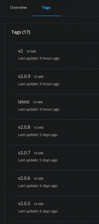

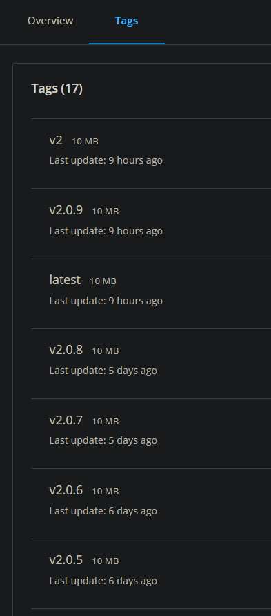

its the latest docker updates, every 2nd is working ...
the last one 9 hours ago is working again.
you can also just use a tag wich works for you ...
just as note
Edited by alturismo
updates with tags
just as note
Agreed, working again
