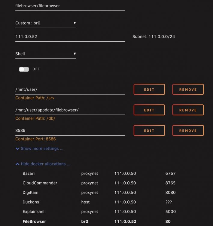

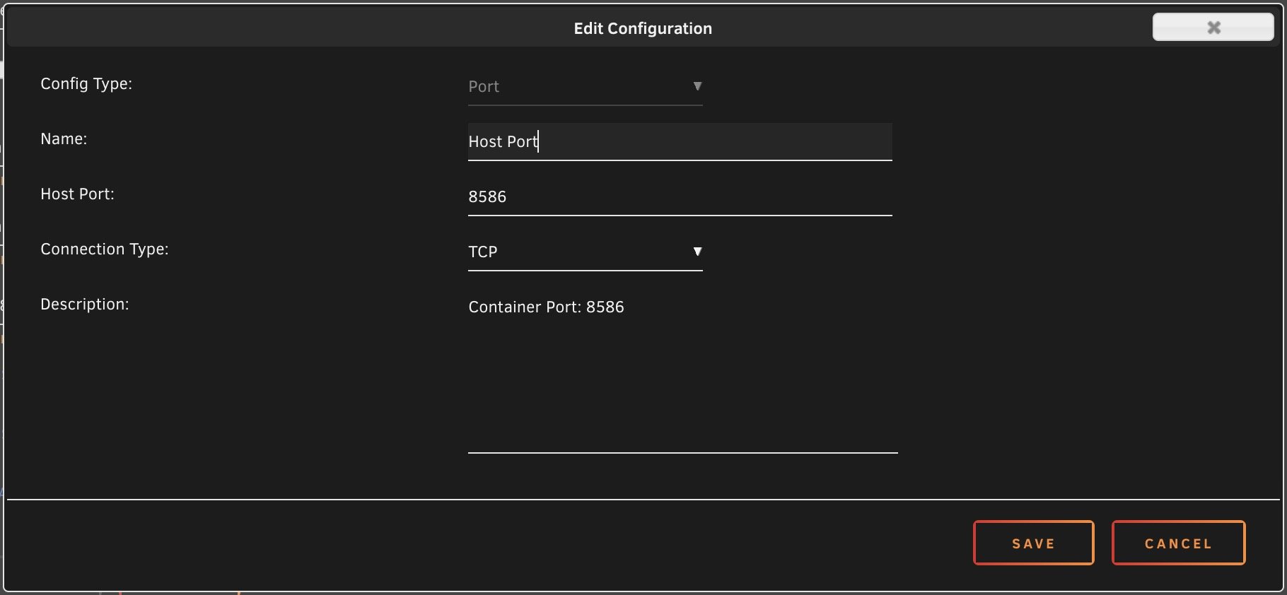

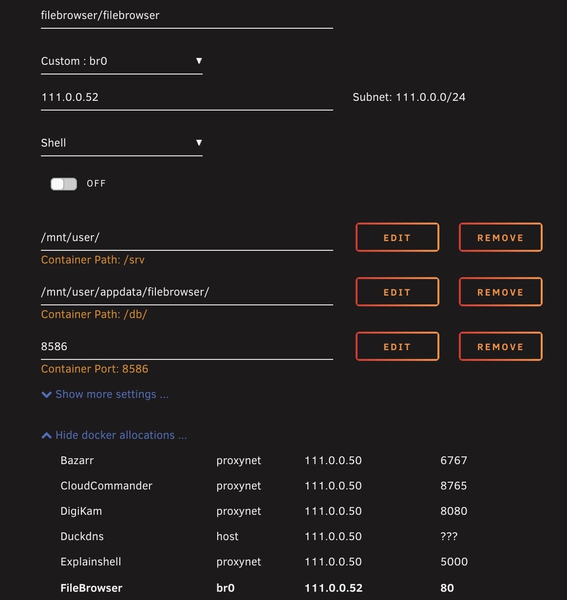

I installed FileBrowser and created a port variable for it because port 80 is used already by unraid GUI.
I couldn't get to the interface for some reason, like the port I added is not used. From there I got the docker an IP and it confirmed that the docker isn't using the port I set. I'm wondering if did it right now...
My problem is I will use it with organizr and letsencrypt dockers so I need to put this docker into my custom docker network so organizr can access it.
What's wrong here?
What's wrong here?
Hi the Containers port is 80 I think so you have to bring Host port 8586 to 80 and not 8586 to 8586?
But I am not familliar what organizr does - you have to figure it out.
Edited by knex666

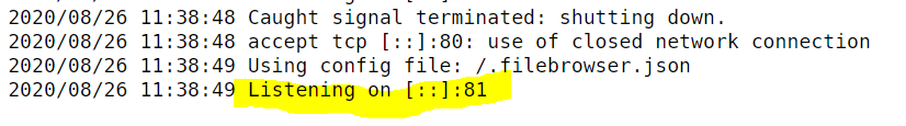

Looking at https://filebrowser.org/cli/filebrowser it seems the command is filebrowser -p to set the port, how do we get this to apply on the boot or in the settings? Looking in the database it seems the port is set to 80 but I cant see how to run the -p command to set the port?
Edit - Seems changing the post argument seems to be the way to apply a custom port, following the above (under advance) you can apply a -p xxxx for the port number.
I had to do some playing with the system reloading a few times but my one is now working on NOT port 80.
Not sure if that can be set as a normal port variable using the above one cam showed as an example?
Edit 2 - So made the changed, the application will work and load on the custom port but the docker is still hooked on port 80 in the allocations, not sure how we change that setting at all or where that is set?
Edited by brent3000
Found more info
I don't use this but the usual way with any docker is to just map a different host port.
How would I do that? I tried adding the port like cam above showed in his screenshot but its still showing '80' as the port in the allocations? Or is this set somewhere else?
Did you notice that didn't work for them either and there was a reply to their post just above?
Yes but as above it didnt work and I think it was just the assumption that if the port mapping changed it would change on the screen, it seems thats not the case due to the Host and Container references being different in how they appear on the docker page.
I did get this working now to how I would need it and deff need some more playing to get my head around it as it seems docker needs alot more changes than I thought than simply enter a field when its out of the norm :)
slowly but surely haha updated the link and seems my other apps now work and use the ports without any issues :)
when u want to change natively the listen port from filebrowser
@brent3000 change it in the filebrowser.json file ..
restart docker ...
whyever u want todo so ...
