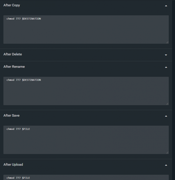

Hi! I'm using this FileBrowser docker image. I've used the flag --user 99:100 but since umask is 0022 instead of unraid's default 0000, any file/folder created using FileBrowser can only be written by user "nobody".
This means that when accessing my shares via SMB I cannot edit the files or directories created in FileBrowser.
Is there any way to change the default umask value in the container? I know some images have this option built in, but it is not the case with this one.

may try this
should solve the most issues ...

41 minutes ago, PicPoc said:
How can force 'chmod' to 666 ? FILEBROWSER writes by default 755 and files are not writable by users.
may start reading the official docs, this docker runs as root i assume (i use my own template), but there are options to run after each event, so you can easily chmod files automatically.
https://filebrowser.org/configuration/command-runner
by default all smb users should be able to work with these files, but i assume u use personalized user shares, so may read the docs to figure it out.

6 hours ago, PicPoc said:
I don't understand how command-runner works !
rather say you too lazy to read the page ... ;)
here an idea to make them 777 ...
Yaaaa ! Thanks !
I understand now.
The difficulty was to understand how to make the sentence. Thanks to you, it is now very clear.
For "After Upload", I use :
chmod 0666 $FILE
Great ! and thanks again. :)
