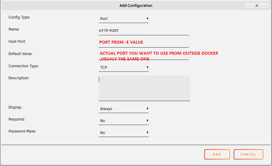

28 minutes ago, Nodiaque said:
Under "HTTP Port" and "HTTPS Port", you input the port that you want to listen to. This port will be the port used to access the server.
Docker itself listen on a port, but this is the "port forward" mapping from docker and your real NIC. This way, the service can listen to 8080, but you can open this port to 8888 from outside request.
You'll have the LSP port and SSH Port too to modify if needed.
Another thing you can do, if you want (like me) to have a matching port from the docker and outside, is add this to you extra parameters:
-e OPENHAB_HTTP_PORT=8888 -e OPENHAB_HTTPS_PORT=8443
This command will tell openhab in the docker to listen to another port. If you do that, you must delete the ports in the template page and recreate them (because they expecte to listen on the default port).
This part of the explanation I didn't understand.
Where do I change the ports numbers?
And where should I run the command you mentioned?
the -e openha.... is extra parameter

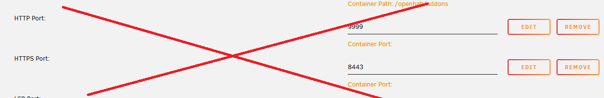

When you do that, you change what the service is listing from. But then, on docker template, you must add new port forwarding for these port because the default one have another port on the host side. So delete http port already there
And create new one 1 by 1
As for the reverse proxy, you can install SWAG that already have everything setup for reverse proxy. But openhab shouldn't be open on the outside. for this, either use a VPN or openhab cloud, which is free (that's what I use, this way, nothing open).
I forgot. You must also change this value to your http value:
Else, when you click on webui in unraid, it'll direct you to whatever the value is there by default, which is 8080 I think. I do run openhab as host, I simply run it on other port like you can see. In fact, port 9999 used to be the default port, they changed it somewhere in version 2.5 I think. Running it as host also make it available for network scan and other stuff like that. Technically, when you run as host, you don't need to define the port redirection like I did because all port are mapped automatically. I prefer having them specified anyway, this way, when you create other docker for other service, you can check all port already assigned under show docker allocation
Edited by Nodiaque

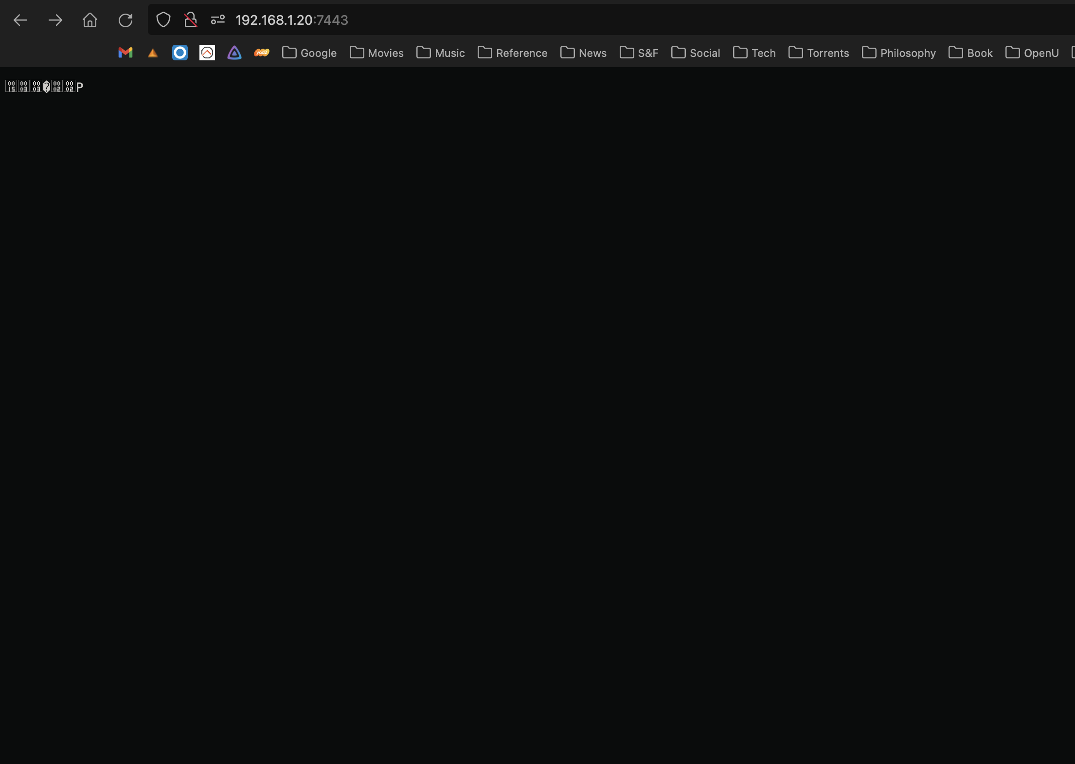

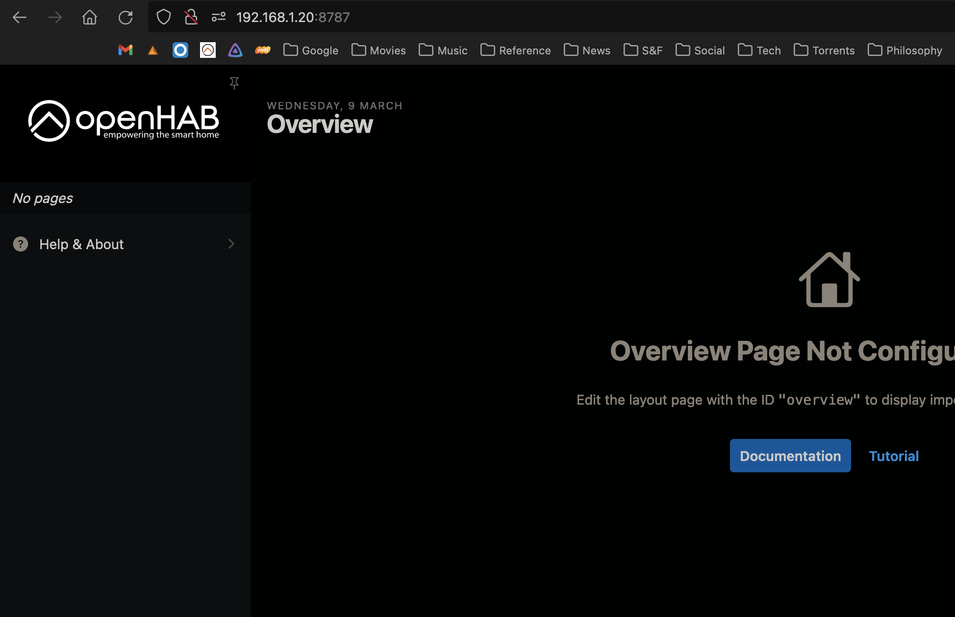

To have a secure connection, you must use the ssl port. Also, your router need to allow loopback connection which sometime doesn't work. Try from a cellphone on lte network instead of wifi, that's how I tested it.
Also, certificate from let's encrypt doesn't work from IP, they work for dns name. You must configured swag to get a certificate for your dns name like dyndns, duckdns and other.
I tried. Unfortunately, it doesnt open properly.
135436847_ScreenShot2022-03-09at22_25_44.thumb.png.e65d5b8039106744c2434698ad1cae7c.png
However, when I try the http port, OpenHAB's MainUI opens ok.
1694566611_ScreenShot2022-03-09at22_30_54.thumb.png.8c40f29fc4b564c7129e0ebd6b16a654.png

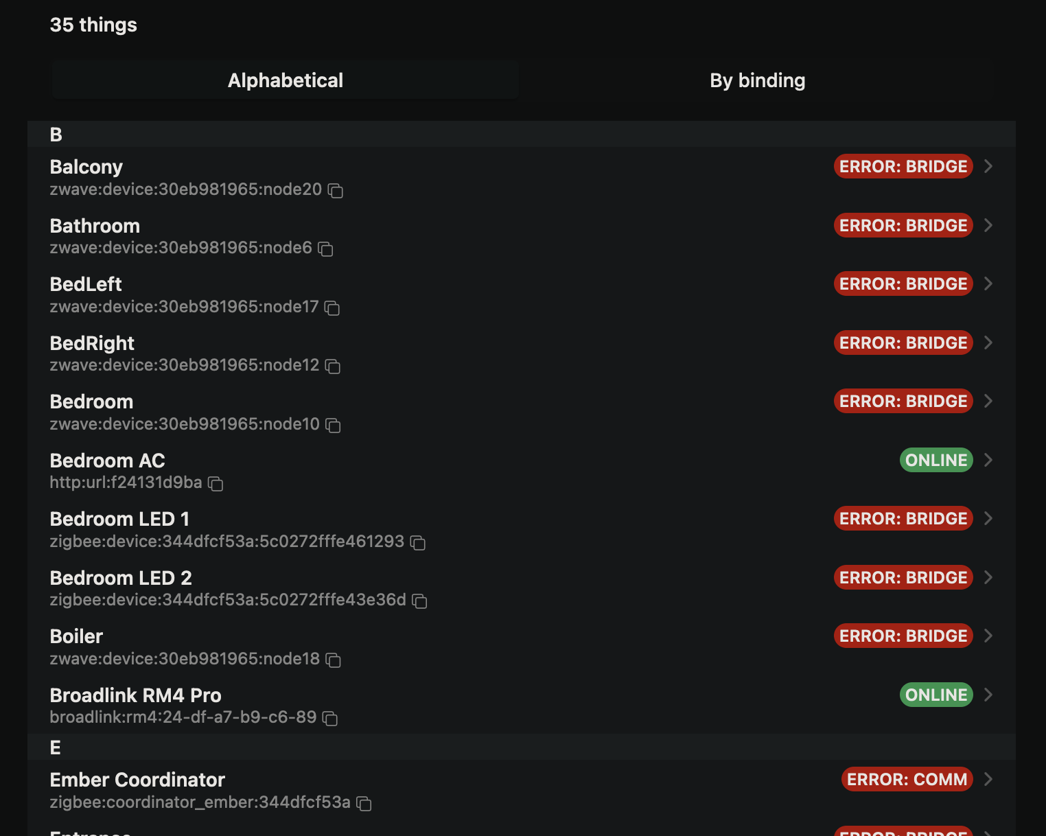

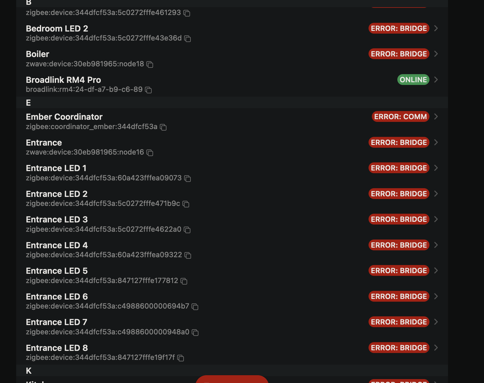

Hello Friends,
After rebooting my unraid server today, OpenHAB 3.3.0 (installed with the docker app) no longer recognizes my zwave and zigbee controller dongles that are connected using USB.
This means all my zwave and zigbee Things are showing an Error: Bridge message.
I tried to reboot the unraid server again, thus also restarting OpenHAB, but that didn't fix the issue.
Does anyone know how to fix this?
336162946_ScreenShot2022-08-15at21_09_42.thumb.png.d105e11577a5bc8969d775948167c7c6.png
383800408_ScreenShot2022-08-15at21_12_22.thumb.png.6424ac06b444ec4186edd70893b6860a.png
Edited by mjeshurun
