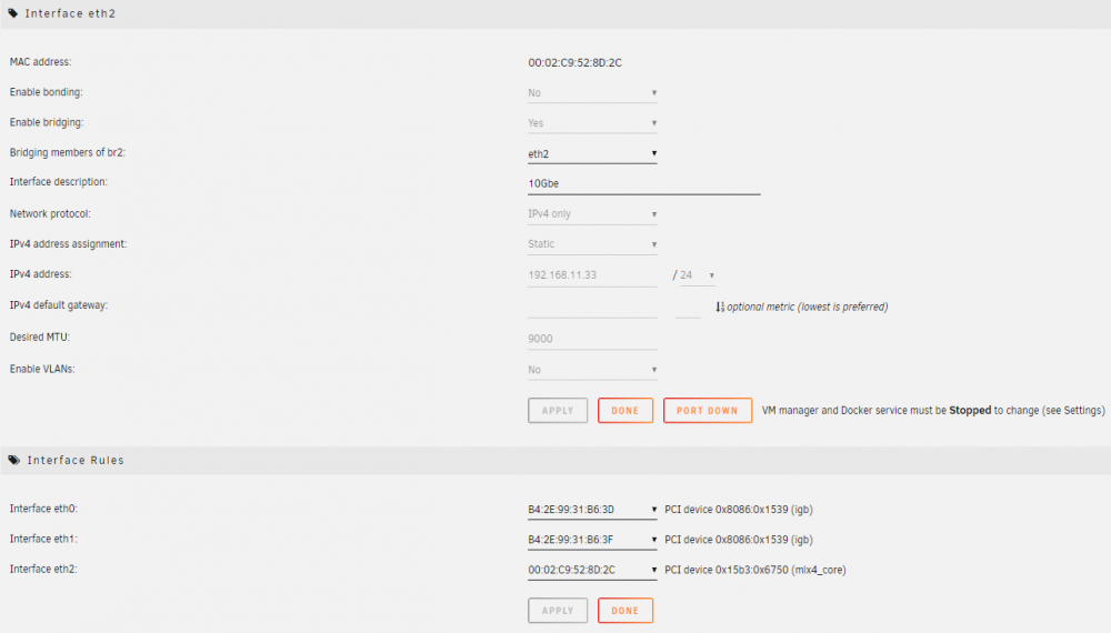

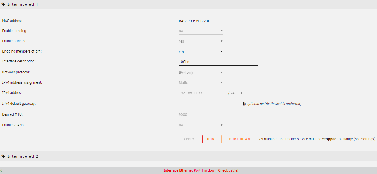

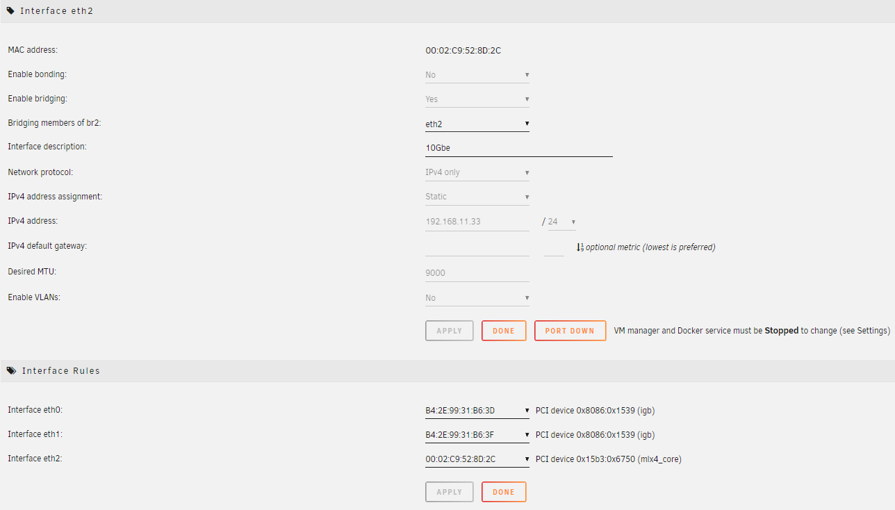

10GbE NIC is currently eth2, you can change that in interface rules, a reboot is need to take effect.

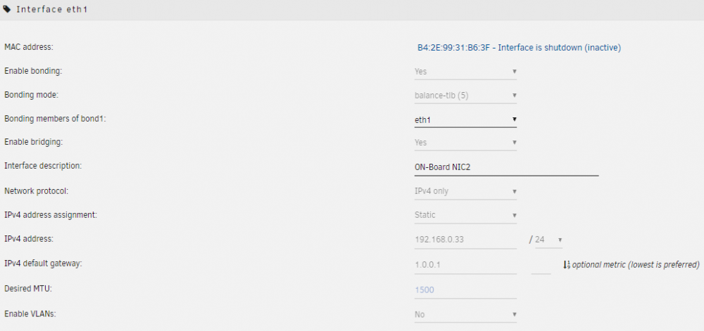

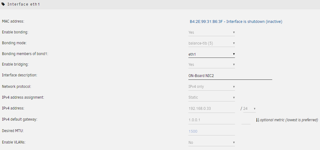

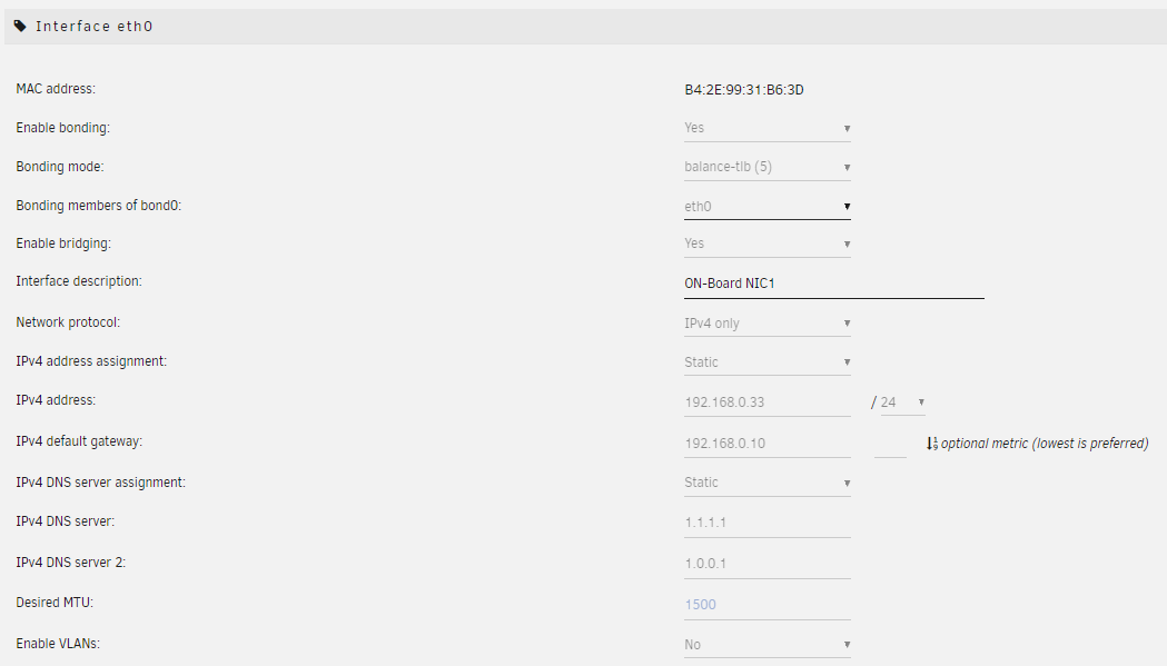

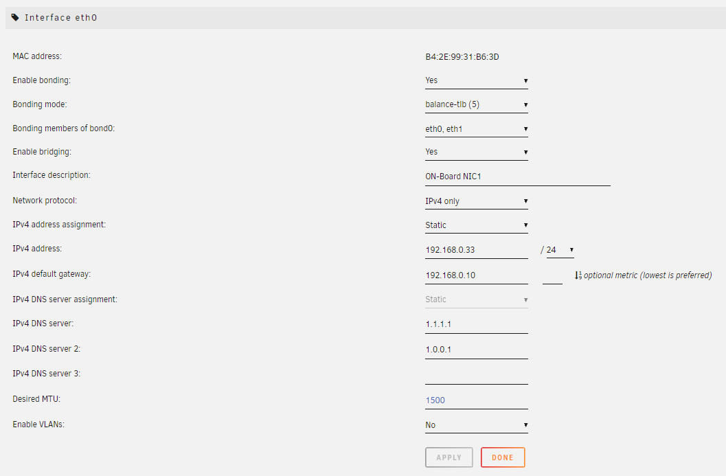

I have addressed that issue and now all working, any idea why I cannot bond/bridge the two on-board nics together? if I select bonding or bridging they will only show the current interface so I cannot add eth0 to eth1  I have an unmanaged 16port switch so nothing fancy just thought I would make use of the two ports seeing as they are there! 🙂
unraidserver-diagnostics-20190306-1315.zip

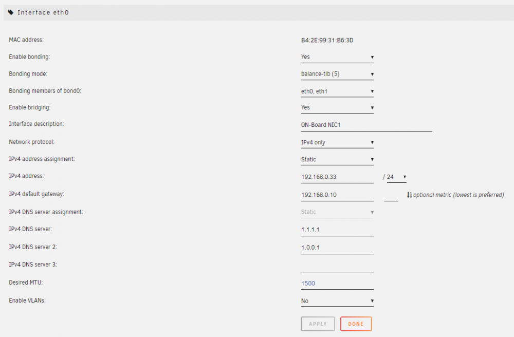

You have two bonds, disable bond1 on eth1 and add that one to bond0.
Could of sworn I tried that!
Magic Man, Thank you ;-)
