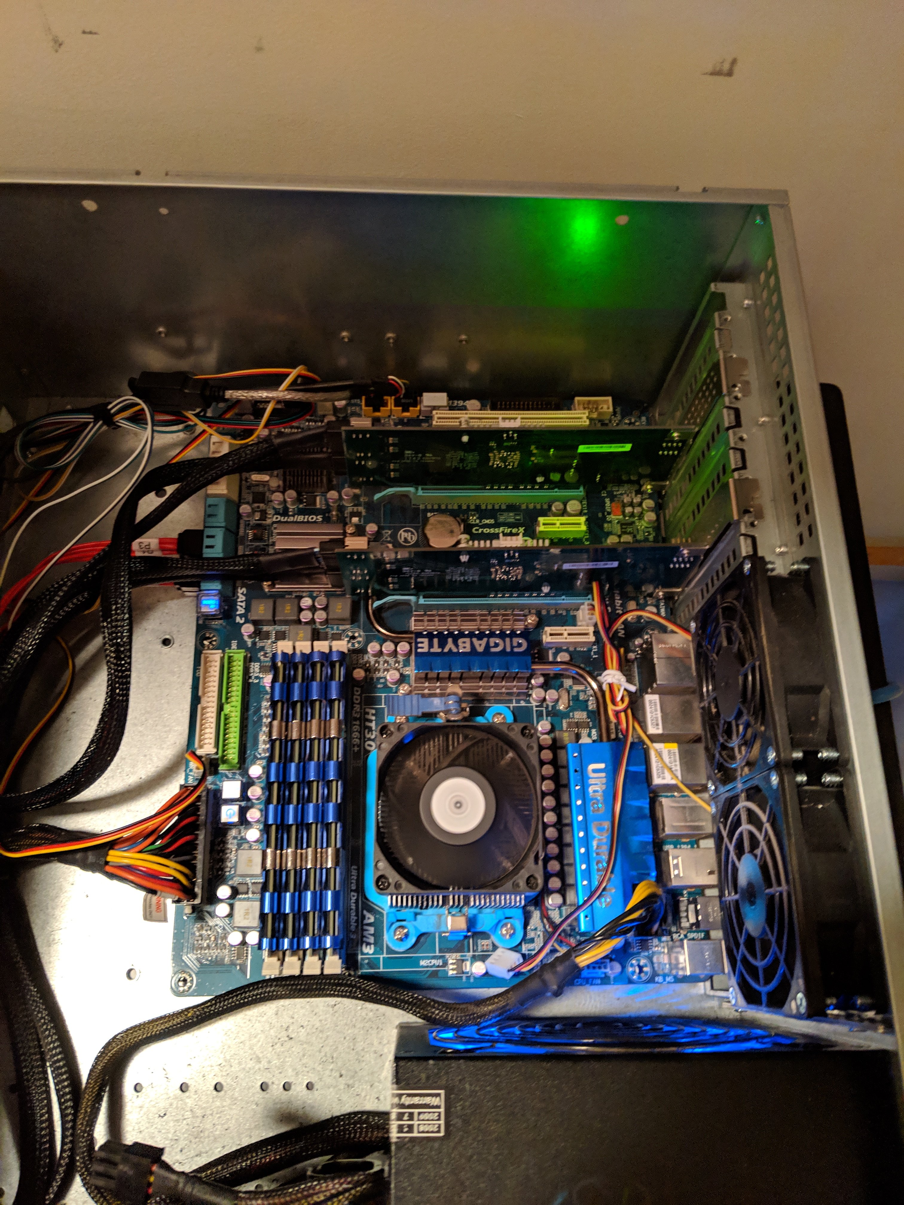

I have an unraid server running 13 drives. I have bought 2 more drives to add to the system. But it is only detecting one of them, and I'm not sure why.
Do older motherboards actually have a limit of 14 sata drives? I was hoping to not upgrade the whole system until I was ready to go 4k, as it works fine as it is currently.

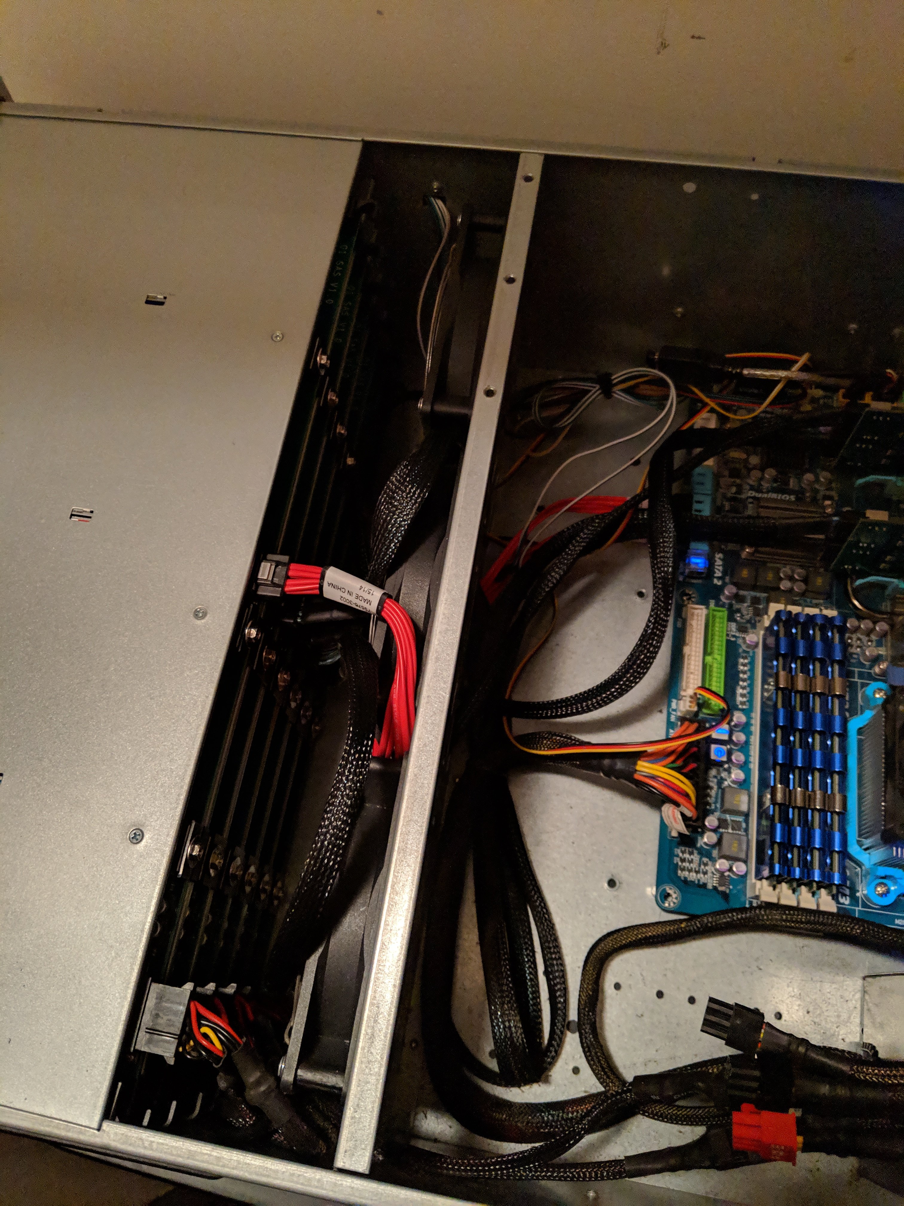

Here is the setup. My case supports 20 drives, I've got 16 of them wired up right now.
One row only has 2 drives in it, and I have one cable running for that whole row, so I know they should all be good to run.
Any thoughts?
Here are a few pics. Not really sure what you'd need to see.
