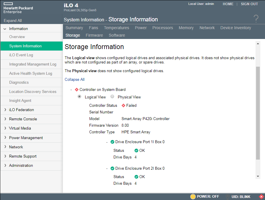

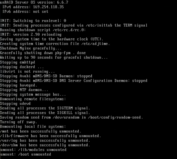

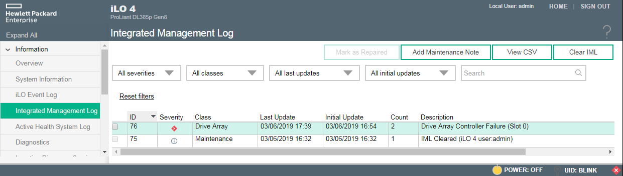

I am kicking around the idea of putting UNRAID on my unused HPE ProLiant DL385p Gen8 and was doing some initial testing. Immediately I ran into a problem shutting down. It starts just fine and proceeds slowly. it get to the point where the screen output says "umount: /boot unmounted". This is where it appears to hang. After about five minutes the server's alarms start going off with a critical array controller failure. The only thing i can do at this point is pull the power. It may be important to know that the cursor on UNRAID's output is continuing to flash up until i pull power.
The server is 6.6.7 with UEFI USB media created via the UNRAID tool. There are ho hard disk present in the system at the time of testing, just the boot flash drive.

I have made and attached a diagnostics but i don't know how useful they will be as this is a blank installation with no disks and the problem happens at shutdown. Let me know if there is a better diagnostic output i should run/capture. Thanks.

disable the p420 controller in the bios. I've had problems with them since I started with unRaid 2+ years ago. get. an HBA that allows drive passthrough in JBOD instead..
