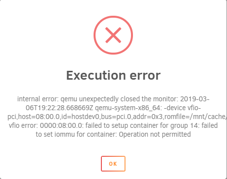

Execution Error failed to setup container

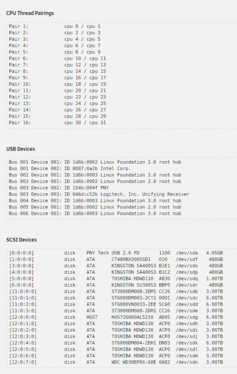

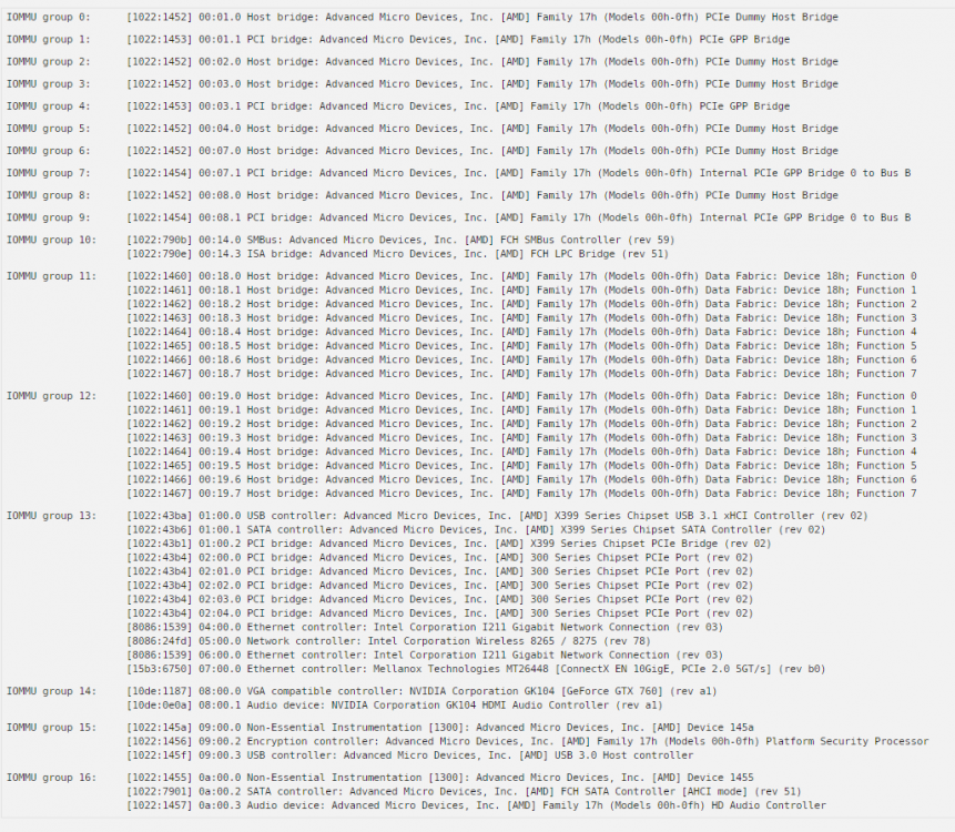

I wonder if anyone can help me out with an issue I have creating a new VM passing through my Nvidia GTX760 please?
I followed spaceinvader's guide on passing through a single card in a machine and all info is below...
Many thanks in advance!

The BIOS on a GTX 7 series card is not encrypted, no special actions should be needed...  Only GTX 10 series and the RTX cards have the encrypted BIOS and drivers that make it needed to do the BIOS passthrough...

ah ok,
I only entered that line on the xml as I was getting the error mentioned in my post, any ideas what is happening then?
Can you not use a single card on unraid as a VM unless it is a GTX10 or RTX?
