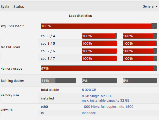

I have just found this which I guess is the reason?
image.png.56c38e1528e72f3cb82e34dacb1c0c3b.pngimage.png.534e26cb84cfb67e96c2697e32ef074a.png
I have stopped Sabnzbd and the other dockers are now OK.
I would appreciate if someone can advise, I guess using my diag file, what causes the issue.

looks like the mover is running all the time, did you set it up a schedule?
i have it scheduled for every hour, nd I have just noticed that I had set a new downloads folder (for Sonarr / Radarr / Sabnzbd) to use the cache drive.
I guess that this is going to max out the CPU & memory?
I have now switched off the cache drive for this share and increased the mover period
However I have managwd to start the Sabnzbd docker again, but after 10 mins the dockers have locked up again.
I am looking to reboot after added another 8GB of memory.
