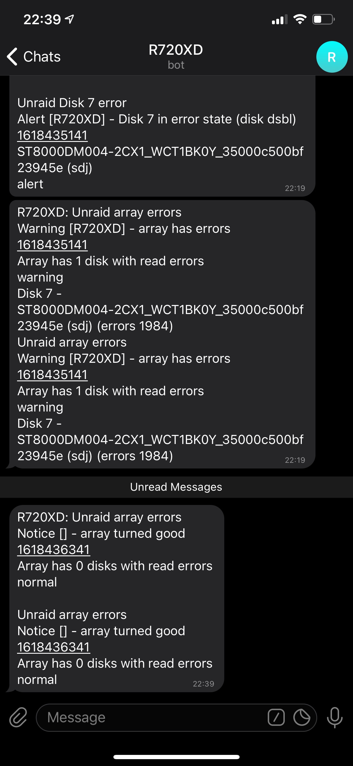

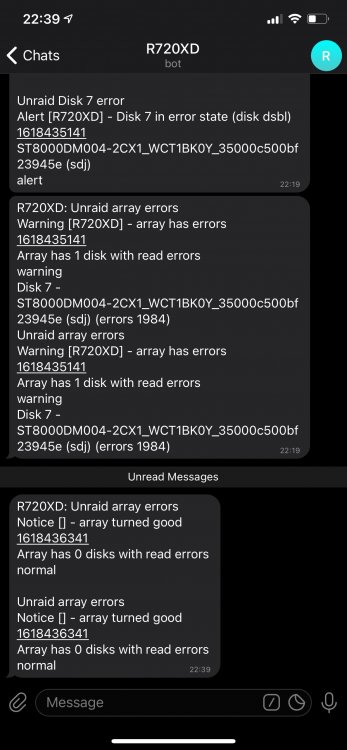

Just as an update Disk 7 has now got the Red X and says emulated, logs 22:28 before i shut down and 22:42 on reboot shall i order a 12TB to replace it with? or will the corrupted move onto a New Drive
Regards
Lee
r720xd-diagnostics-20210414-2242.zip r720xd-diagnostics-20210414-2227.zip
Thanks for the diags before and after rebooting. The controller lost communication with the disk and when you rebooted the disk didn't come back on-line. Assuming there isn't something strange going on with cables (a loss of power to the disk, for example) it looks as though it has actually failed. It's a shame that SMART didn't give more of a warning. If that is indeed the case you at least know where you stand and can replace the disk and move on. The replacement would rebuild in the same state as the current emulated disk. If that's still mountable and has your files on it then that's how it will rebuild. If it was my server I'd certainly replace the disk with a new one and keep the old one to investigate at my leisure.

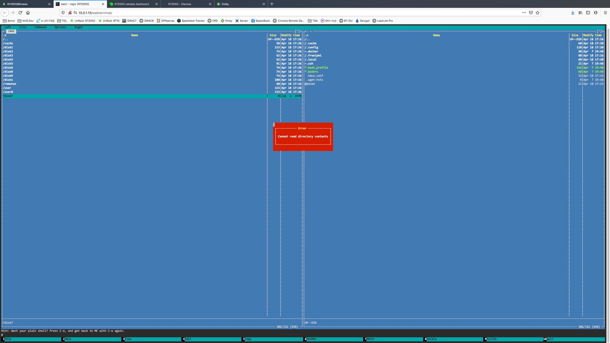

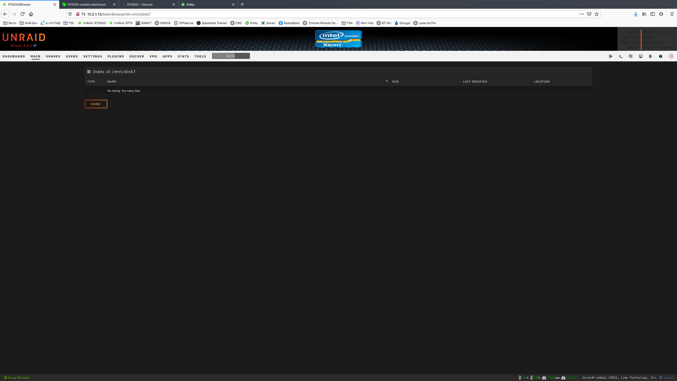

It looks like a corrupt file system. Have you repaired it since replacing the disk?
No i havent didn’t realise i needed too, Do i start the Array in Maintance mode and do it i have no idea anymore its just messing with my brain too much! i just need a working stable server its been fine past 8 years now one thing after another.
Edited by leeknight1981
