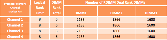

Some time later, this is the best I've been able to find. It's about Haswell Xeon servers using RDIMMs/LRDIMMs so it's not what I was looking for at all. Pages 3 and 4 do show that the more DIMMs you add, the slower you have to clock them though.
I've seen it before for those CPUs, but for desktop CPUs and UP Xeons I believe there's no such limits, e.g., Kabylake supports up to 2400Mhz, you can use 1 or 4 DIMMs at that speed without issues, I would guess the main difference is Intel announces the max speed with all DIMMs populated and AMD, possibly to announce higher speeds, does it but they are only valid for when 1 or 2 DIMMs are in use, nothing wrong with that as long as they publish the max speeds depending on the config, and that should be done mostly by the boards manufactures, like Asrock who shows that on the specs for most AMD boards, but I do prefer the way Intel does it, and this isn't new, I remember the exact same issue with AMD Athlon 64 CPUs, they also had similar limitations.
