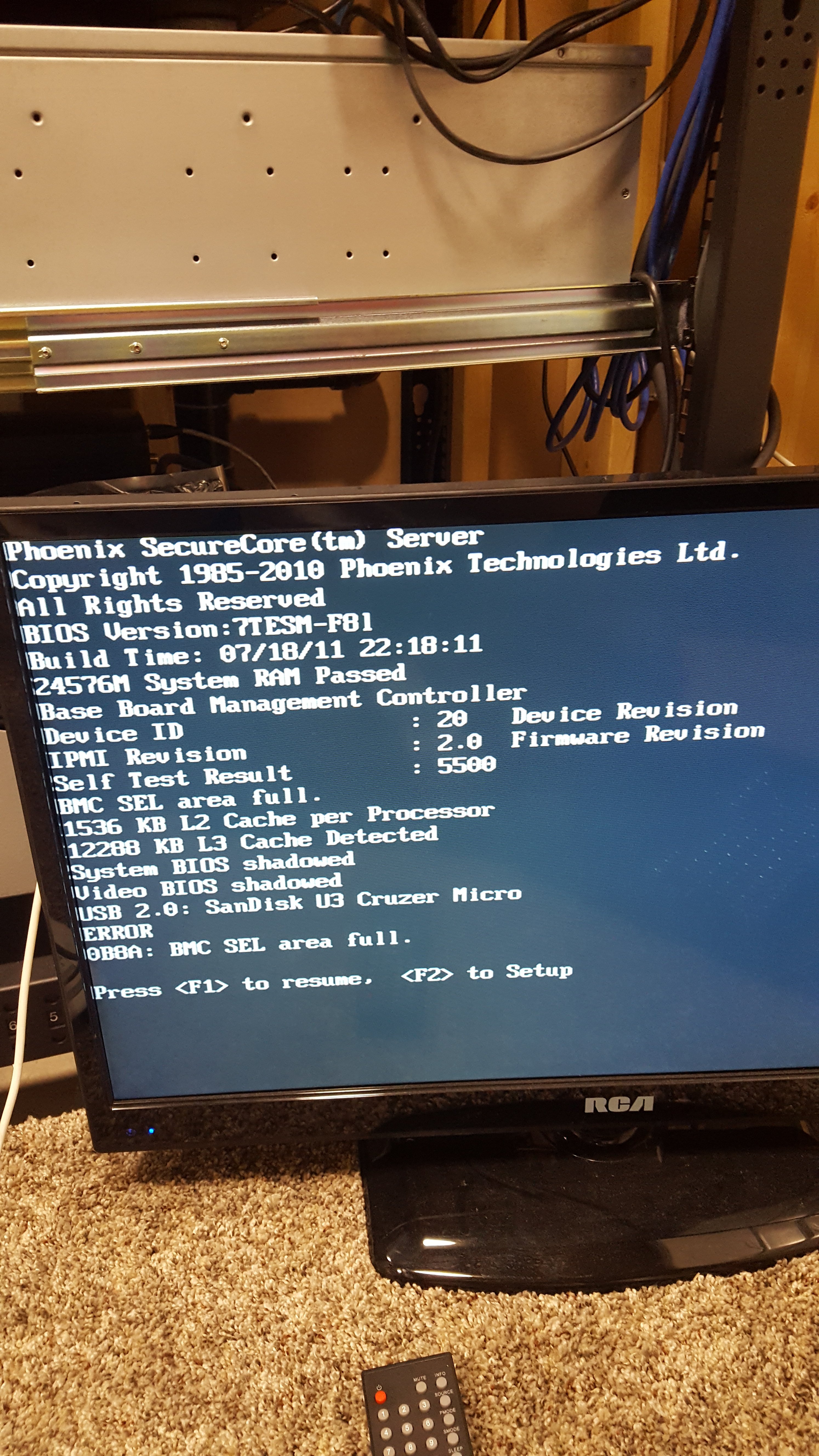

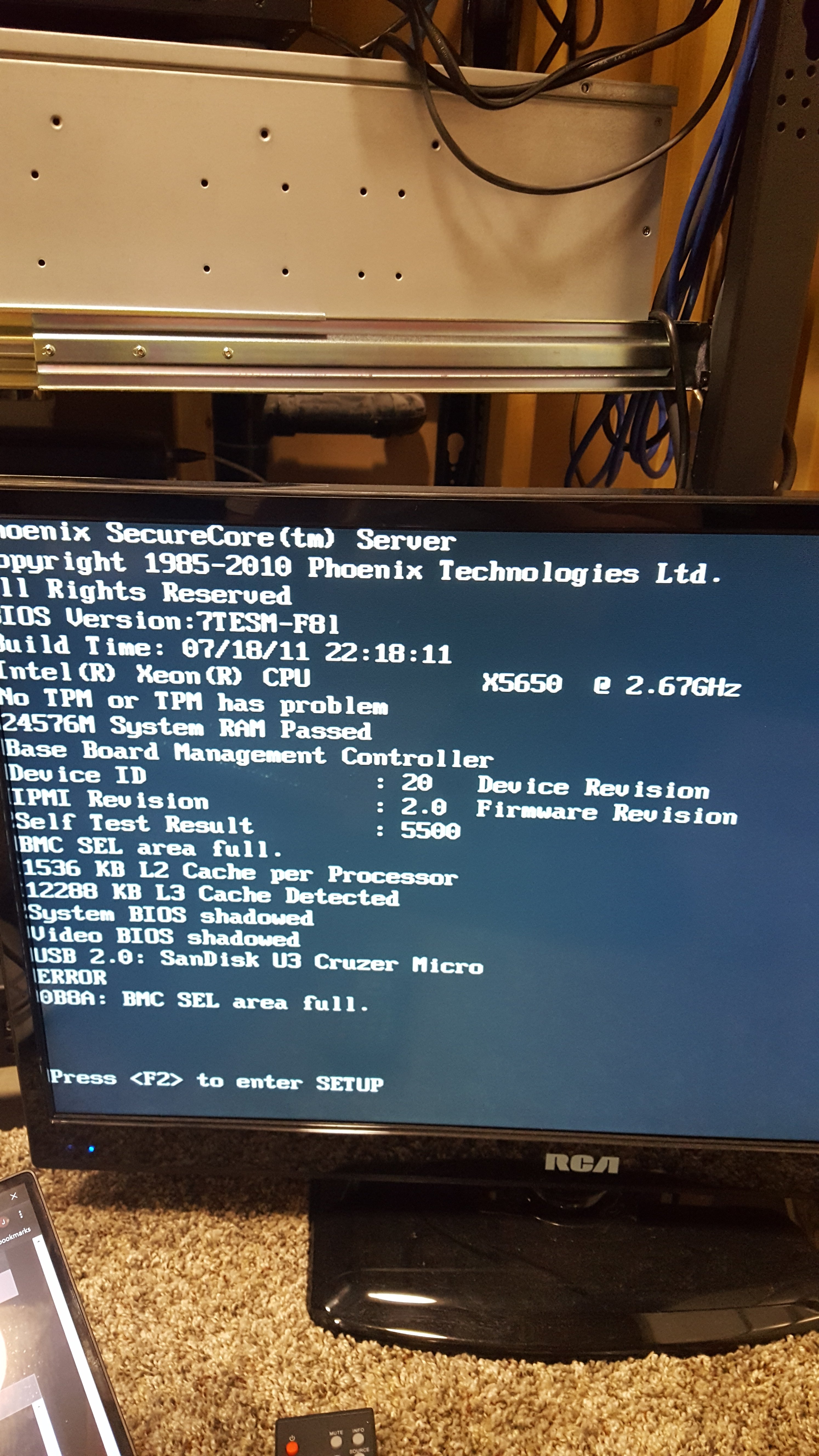

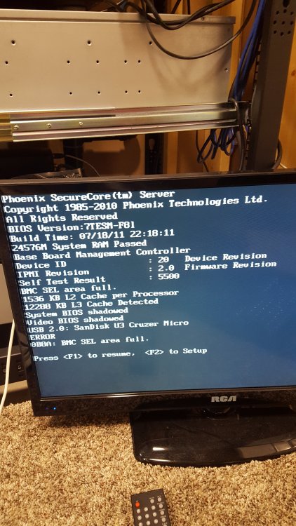

Hey guys, need some help. My server get stuck at this point and reboots. Second picture shows no TPM or TPM has problem.

SEL = System Error Log. I guess you have to press F2 to enter the BIOS setup and deal with it there. You have some problem that's filled up the space reserved for the log. So you need to read the messages, delete them, fix the problem that's causing them. Then you can boot and use your system.
TPM = Trusted Platform Module. It's a cryptographic device used for generating and storing keys. You don't need one to run Unraid.

Thanks John, I cleared the event log through IPMI. Most alarms due to low fan threshold speeds. I guess I need to look further into that.
Anyways, I am now able to boot.
Thanks for the help
