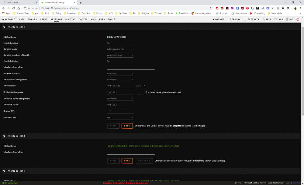

I have been trying to set up WOL on my Gigabyte x399 Aorus Xtreme. The manual says the board supports it.
I have been unable to get it to work however. I think I have isolated the issue to the boards NICs. The Aorus Xtreme has three NICs; a 10GB and two 1GB ports. It appears the 10GB NIC does not support WOL. The two 1GB NICs do.
In network settings unRAID shows all three NICs as bonded. I think the inclusion of the 10GB, which does not support WOL, is causing WOL to fail. As a result I am thinking that I could utilise one of the 1GB NICs as my network connection. Or maybe bond eth1 and eth2. Though I dont really need the bandwidth.
I cant seem to get it to work though. eth0 is the 10GB NIC, eth1 and eth2 are the 1GB NICs. eth0 is showing as bonded with eth1 and eth2.
Firstly, how do I stop all three NIC being bonded?
Secondly, how do I tell unRAID that eth1 is the NIC to utilise for network connectivity?
I tried setting Enable Bonding on eth0 to no then setting eth1 to bonded with eth2 however I dont get a connection. When I do this unRAID reports "Interface Ethernet Port O is down. Check cable!"
Also eth1 and eth2 have the message :Interface is shutdown (inactive)" next to the MAC address.
Any advice on how to configure network settings so as to utilise a particular NIC would be much appreciated.

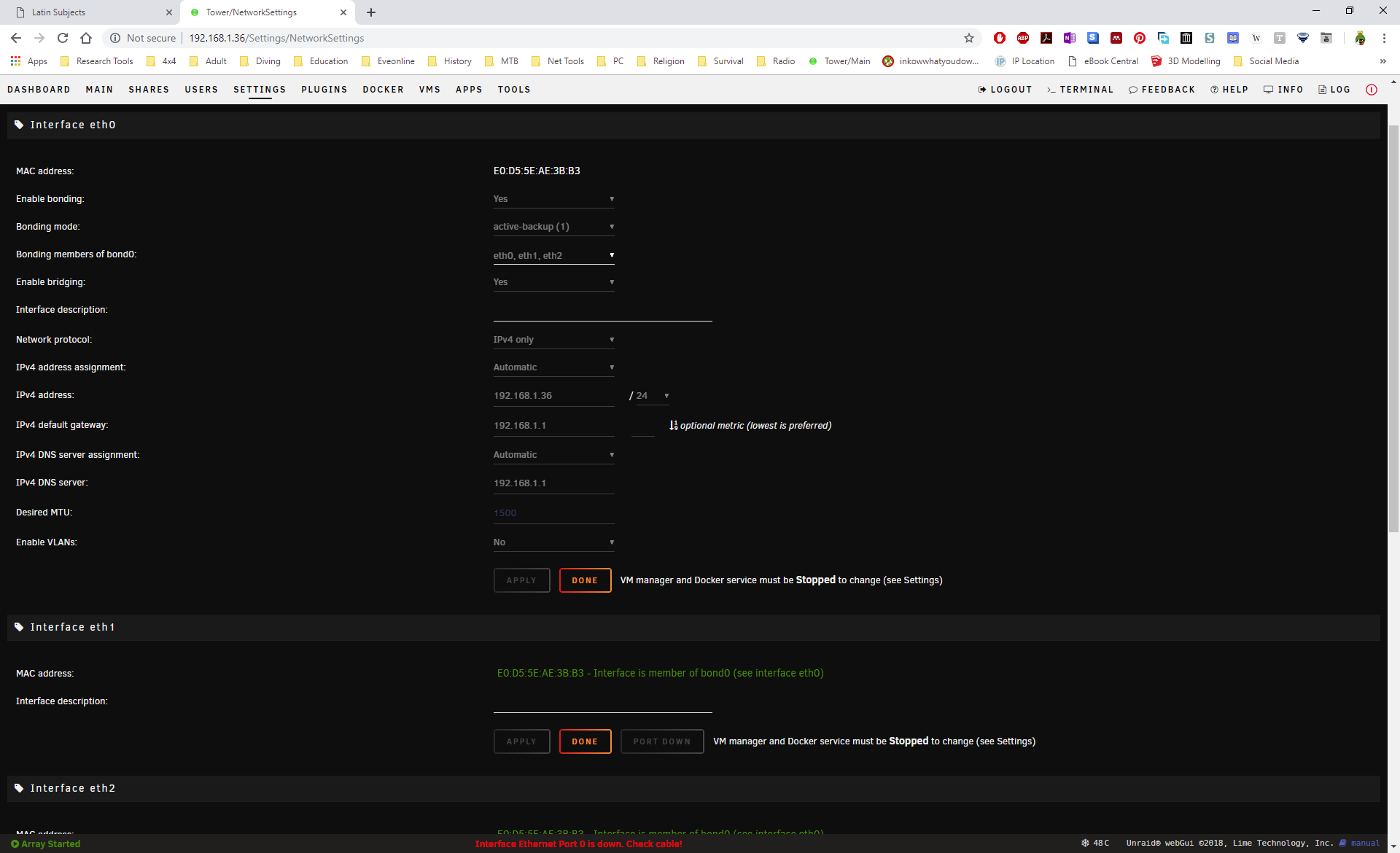

Looks like all three NICs are bonded to me. Interface eth0 says "bonded" bonded members of bond0 are "eth0, eth1, eth2"
Both interface eth1 and eth2 show as member of bond0.
It doesnt matter which port I run the cable to. I get connectivity regardless of the port as they are bonded. I dont want the ports turned off in the bios as I intended to stub them and assign them to VMs.
Im not seeking to utilise a bonded connection. In fact I only want to utilsie a single NIC, either eth1 or eth2. At the moment I cannot work out how to do that.

I tried setting enable bonding on eth0 to no. When I do I loose network connectivity. eth1 and eth2 show as "interface inactive". I cannot find a setting to make them active. Even setting eth1 or 2 to bonded does work. eth1 is connected to the router however it continues to remain inactive and doesnt get an IP address.
you have me stumped then as I have no issues using either NIC
If I turn my bond off, I can assign an IP to eth0 or eth1 and can access my system from either NIC, as i have both wired into my switch.
What I have discovered is that eth1 and eth2 need to be unchecked from the bond prior to unbonding eth0. When I do the "interface inactive" notification dissapears.
In theory all three NICs are now independent. However, I am still getting the message "Interface Ethernet Port 0 is down. Check cable!". I am presuming unRAID is looking for network connectivity on eth0 as opposed to any port. With a cable plugged into either eth1 or eth2 they pcik up an IP address when I select apply however there is still no netowrk connectivity. By that I mean I cant access anything. Using the GUI unRAID wont check for plugin update and Fix Common Problems reports no internet.
What about the internet rules at the bottom of the Network Settings page? Are they telling unRAID which ports to utilise for network connectivity? Should I re-order them so that the 10GB NIC, which doesnt support WOL, becomes eth2?
Edited by darrenyorston
spelling
Unraid uses eth0 as its management port, and this port requires Internet access for Unraid to work properly.
You'll need to re-arrange ports (see network rules) to assign the "correct" interface to eth0.
Ok. So i just change the MAC address assignments? Move one of the 1GB ports to eth0?
