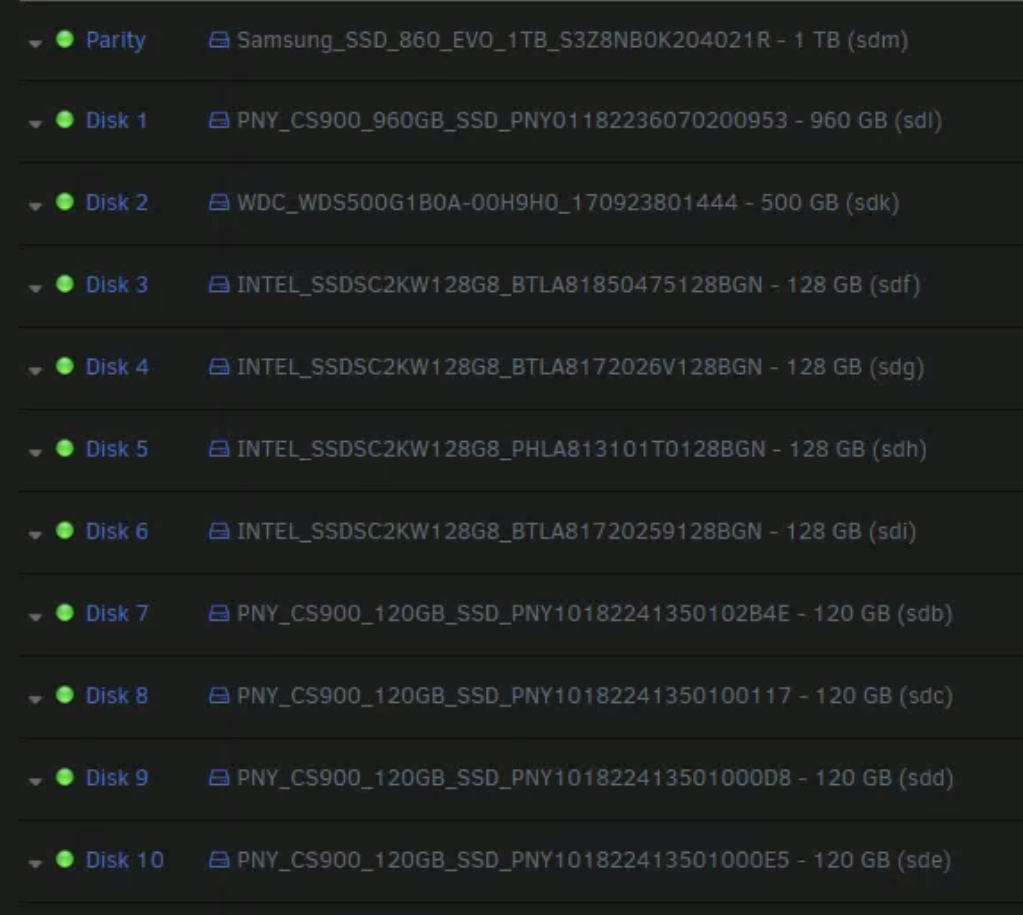

I currently have it in all in a server right now but just not happy with the performance... read/write (128MB) using the SSDs as a unraid setup.

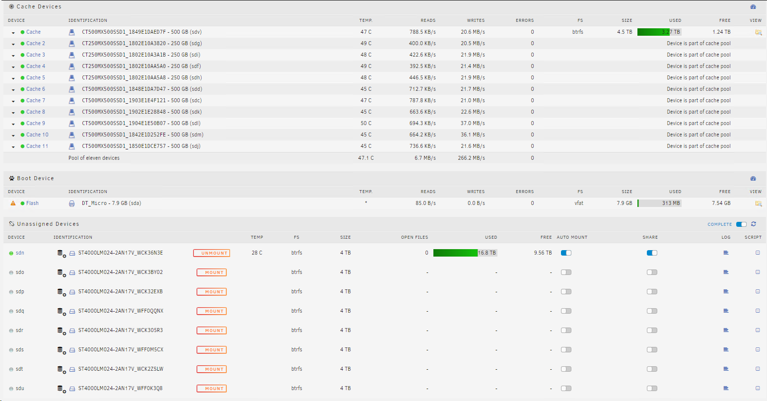

It's difficult to get great performance using SSDs in an array, because of how parity works and the lack of trim, you can get much better performance with a btrfs raid5 cache or unassigned pool, I'm using one with 11 SSDs and get pretty much line speed with 10GbE, but note that btrfs raid5 still has some issues, mostly the parity hole, so a UPS is strongly recommended.
