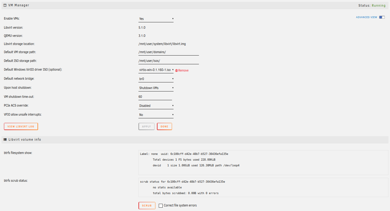

Settings -> VM Manager
Make sure advanced view is enable (top right)

I did enable advanced view. I can select the new file, but the /system/libvirt/ directory is empty...... (Because i deleted the file...)
You have to specify the file, e.g.
/system/libvirt/libvirt.img

You need to re-created by
Wow, this was way simpler than i thought. just typed the path in. thanks!

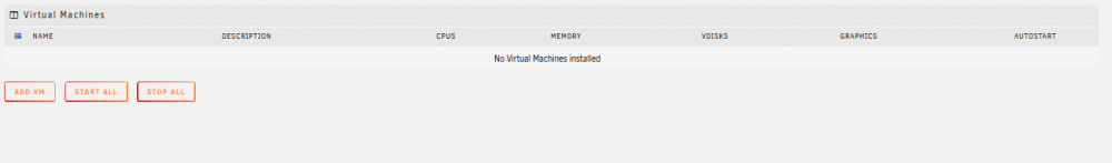

I was able to recreate it but VMs section no longer seens my domain that I have created, although I can verify that the domains folders exist
can someone help me reimport them so I can boot the VMs?
If you don't have a libvirt.img backup, and you should, you'll need to recreate the XMLs for all VMs, using the same config and pointing to the existing vdisks, uefi booting VMs might also require this.

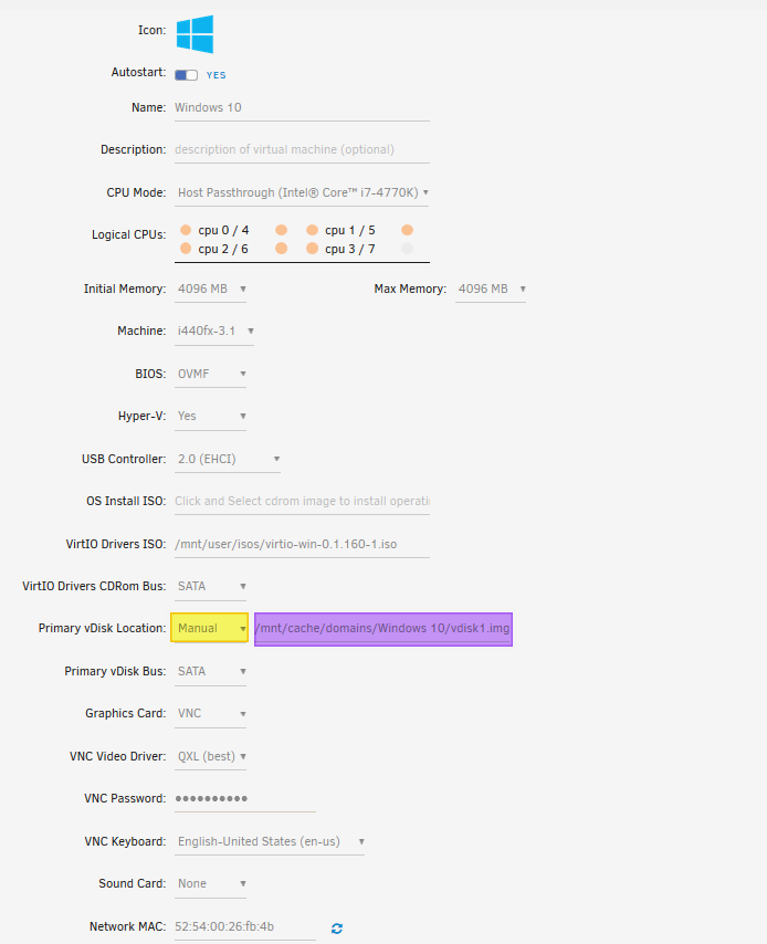

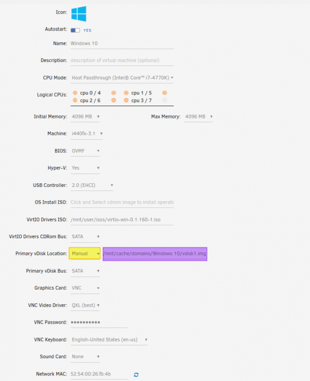

I actually just fixed it
so what I did is go through the motions of creating another Windows10 VM
BUT instead of making a new vDisk I simply selected manual, and pointed to the already existing vdisk that I created before I bunged everything up.
Windows10 VM booted as if nothing happened
