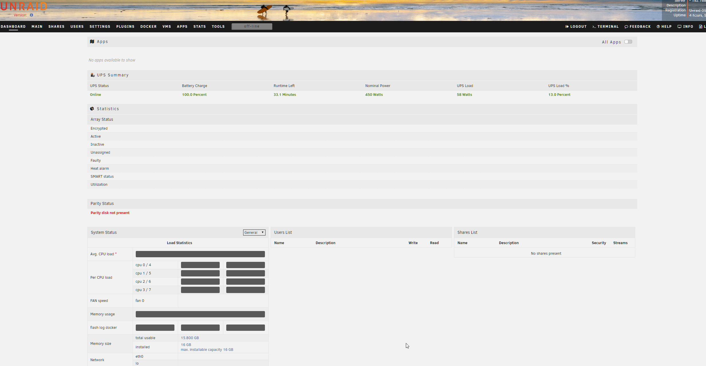

I noticed the other day that my parity disk went missing according to unRAID. Under the dashboard it would say it's missing and no other info. The disk in question is a 10TB WD Easystore that I had used kapton tape on. I've been using this drive for about 4 months without issue. I couldn't stop the array so I had to issue a powerdown command to turn it off.
I turned it back on and the drive was showing up fine. I did a SMART short test and it passed. I started a parity check and here is where it gets interesting. At about 30% or so I guess the disk disconnected, as I got a message that the parity sync finished (errors). It then starts back up and disconnects a few times. I was able to shut it down again and move the disk to a different bay so the SATA cable should be ruled out as an issue. I also downgraded the server from 6.6.7 to 6.6.3. This is a 10TB easystore (4 months old) that I had to tape the 3rd pin on to get it to show up in the system, tape looks fine not damaged. I am using a SYBA non raid card for additional SATA ports - I don't know exactly what drive is connected to what but it should be a mix up and I've had no other issues. Upon another parity check it made it a few hours before having an issue again, "disk missing."
I shutdown and just retaped the pin on my drive, moved it to another bay and powered on my server. I uninstalled the dynamix plugins that it told me were not compatible (system stats and another one I don't remember exactly) even though they've been running for months without issue. I've also removed the preclear plugin.
Not sure what else to check? It seems to show up fine after restarting and SMART indicators seem to show no problems. I couldn't post diagnostics as when the parity disk shows missing, it doesn't let me do much on the server, including downloading the log/diagnostics. Could the drive be bad?

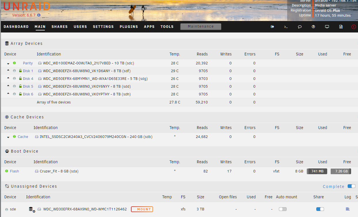

It dropped out again after maybe 8 hours? Long SMART never finished.
I ran an fdisk -l command and it shows up as dev/sdc
Currently my drives are:
10TB parity
8TB
8TB
8TB
5TB
240GB - cache SSD
3TB - unassigned device drive
I'm not too familiar with command line but the fdisk command looks like the 10TB drive is being recognized there as SDC, correct? It's just not showing up in the mapper? I just want to be sure it's a bad disk before I RMA it, or if it's something else.
Edit: just ran df -h and it doesn't come up... does this mean the drive is not showing up at the hardware level?

Just saw your post johnnie:
root@unraid6:~# diagnostics
Starting diagnostics collection... echo: write error: No space left on device
done.
ZIP file '/boot/logs/tower-diagnostics-20190311-0800.zip' created.
Not sure how to access it though since I can't connect over samba...
Not sure what it means when it says no space left on device... will /boot survive a reboot?

Ok I rebooted. Here is the diagnostics zip.
My flash drive doesn't look full to me after reboot:
df -h results are also different...

Edit: Updated to 6.6.7 on reboot (after 2 hours with no issues) - uploaded diagnostics after this reboot
unraid6-diagnostics-20190311-1218.zip
Edited by ptirmal
Everything seems fine for now, if more issues try to grab the diags immediately, so hopefully we can see something.
Do you think I should start a parity check or just wait for now and see if it stays up without issues?
Can someone tell me if I am interpretting the results of fdisk -l showing my parity drive while the unRAID webgui shows it as "missing disk," to be more of a software issue as opposed to a hardware one, especially since rootfs was full for unknown reasons? My only guess is a recent update of one of my dockers caused something.
When this happens, is it listed with the Unassigned Devices instead? There was another thread like that recently.
No. When this has happened before, the dashboard shows what's show in the screenshot above. I can't access "Main" to see what the disks are showing, it's just perpetually in the loading animation.

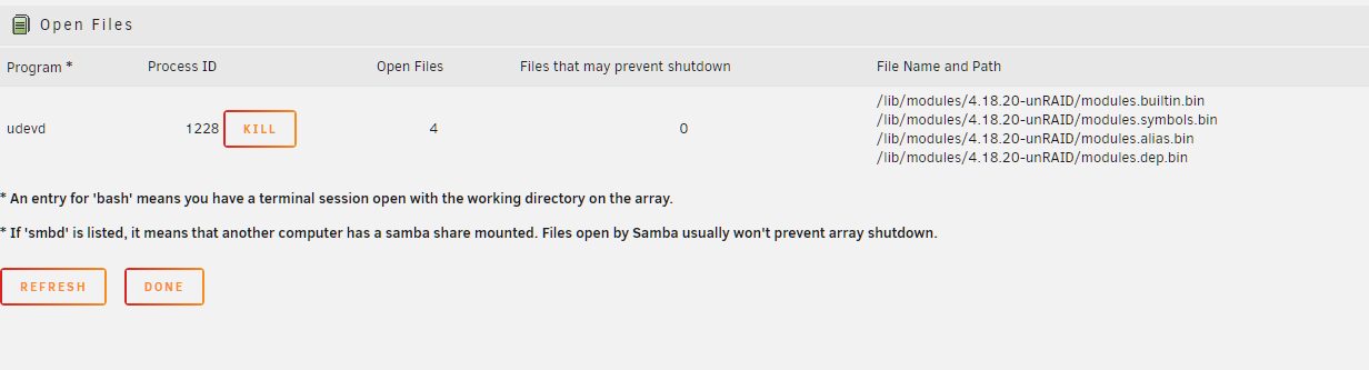

So it survived the night and the results of df -h look like it's still only using 11% on rootfs
root@unraid6:~# df -h
Filesystem      Size  Used Avail Use% Mounted on
rootfs          7.7G  802M  6.9G  11% /
tmpfs            32M  484K   32M   2% /run
devtmpfs        7.7G     0  7.7G   0% /dev
tmpfs           7.8G     0  7.8G   0% /dev/shm
cgroup_root     8.0M     0  8.0M   0% /sys/fs/cgroup
tmpfs           128M  200K  128M   1% /var/log
/dev/sda1       7.5G  708M  6.8G  10% /boot
/dev/loop0      8.2M  8.2M     0 100% /lib/modules
/dev/loop1      4.9M  4.9M     0 100% /lib/firmware

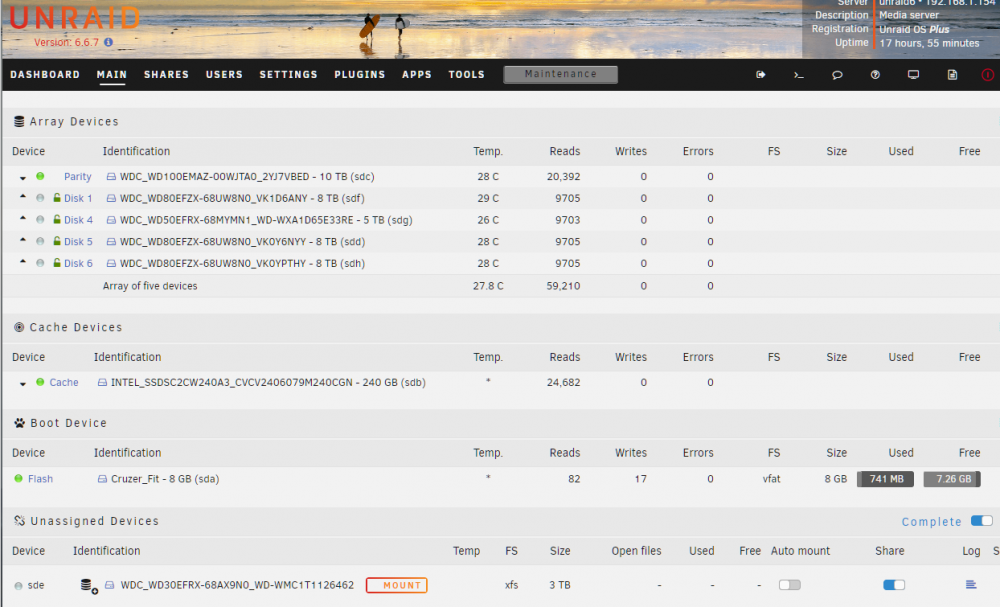

Can someone explain why it shows so many reads on these disks? It's still in maintenance mode:
and it doesn't look like much is going on:
I guess my next step is to bring the array online out of maintenance mode without docker or VM and start a parity check.
New diagnostics attached.
