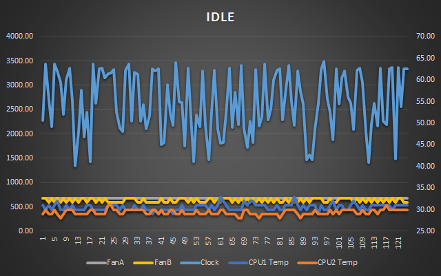

This is what it looks like for roughly 10 minutes with the system at complete idle:
CPU clock pulled from lscpu, left scale
CPU temps right scale
Fan speeds left scale
Average 2637.53

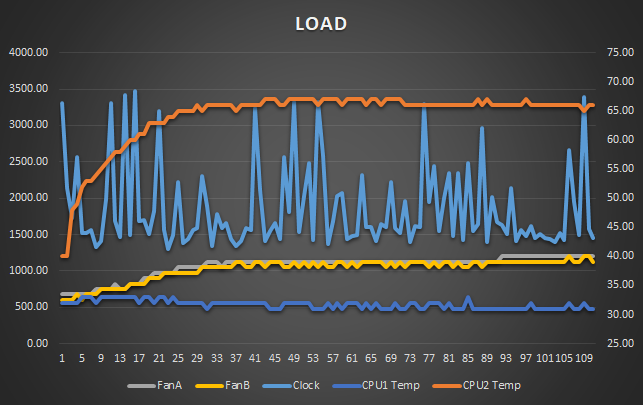

And this is what it looks like for roughly 10 minutes under a load, on 1 of the processors. To create load, I used a docker of Handbrake assigned it to all CPU2 via pinning and then launched the transcode of a 4K HVEC video to 720p.
Average 1865.39

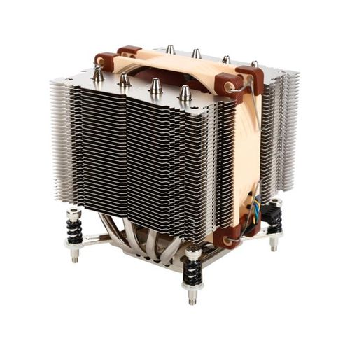

These are the CPU coolers I have:
https://noctua.at/en/nh-d9dx-i4-3u

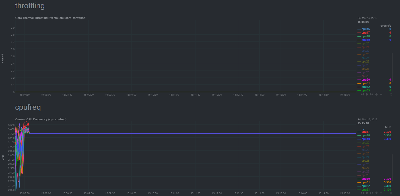

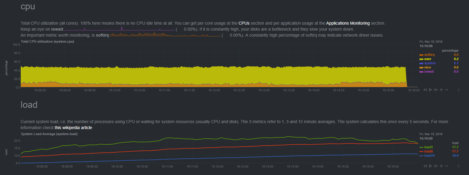

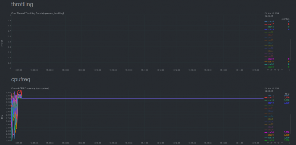

Netdata docker has throttling shown in the charts.
OK... that docker is AWESOME...  I feel like I should delete my above post out of embarrassment.... 😳
So, I've over complicated my effort to look for throttling ... check. And... it wasn't an accurate measurement....
Told you I'm a n00b...
Here's the results having another go at it. CPU stayed at 65C too... I'd say that's adequate cooling. Check.
