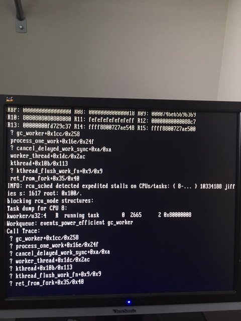

Here is something I've been able to catch

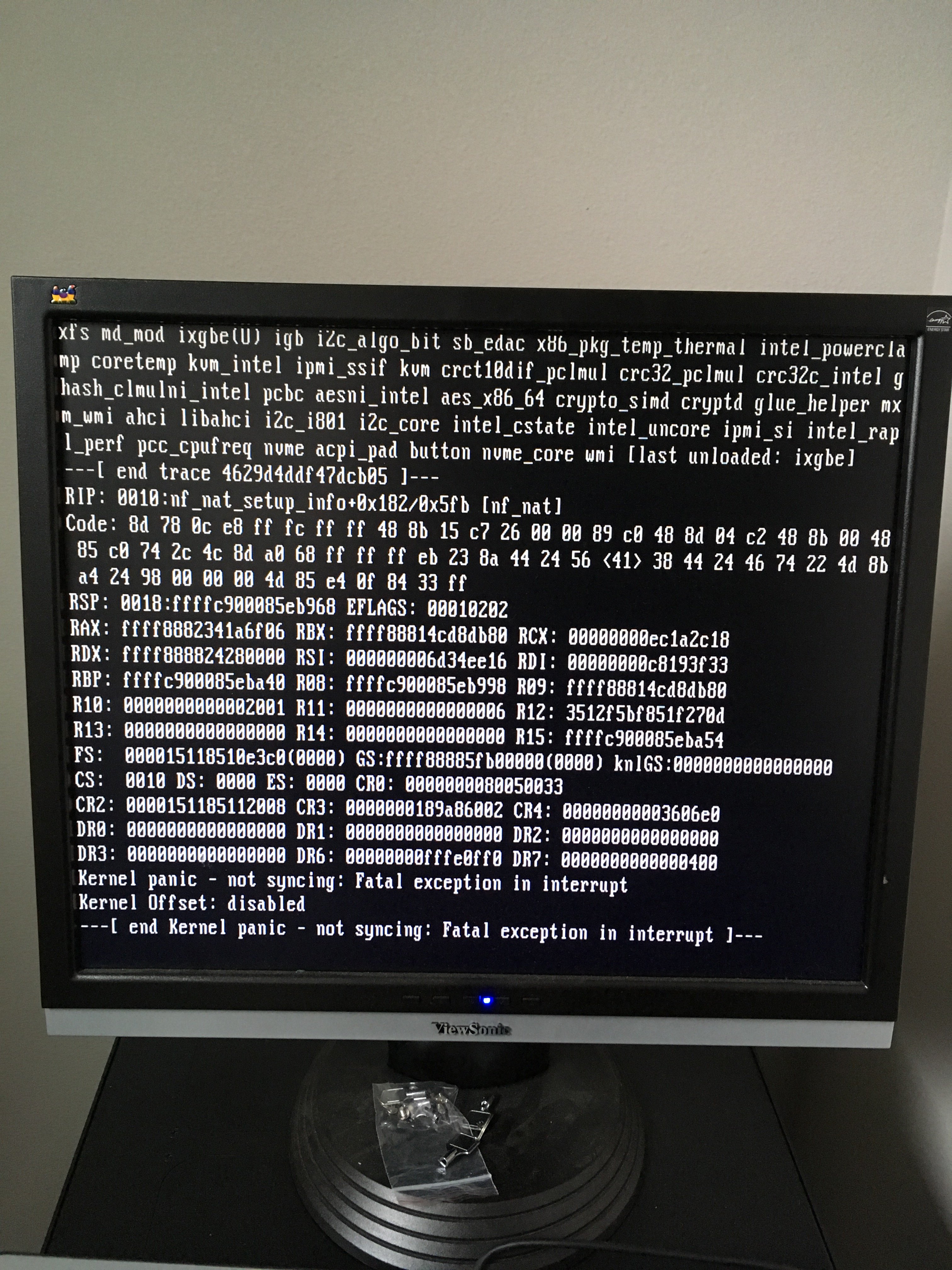

I'm still having issues with my server becoming unresponsive to anything and stuck with a screen similar to this..
Unable to access the system at all. This is the only notable interaction, a photo of the screen.

I am not enough of a Guru to be able to figure out from that screen shot what is going on but hopefully one of the true Gurus will be able to.
However, you can now grab the syslog since you upgraded to 6.7.2!   Go to   Settings   >>>>  Syslog Server    and set it up to 'Mirror syslog to flash:'.  You can find out how to do this by using the built-in Unraid "Help" feature--- it is the question-mark-in-a-circle icon on the Toolbar.

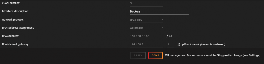

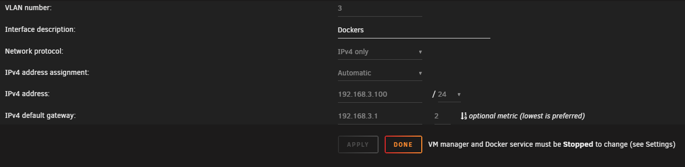

Here's my VLAN 3 for Docker containers as defined in unRAID Network Settings (since bridging is enabled it becomes br0.3):

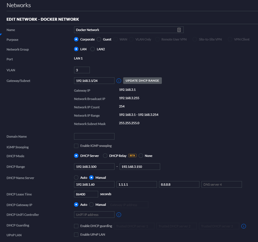

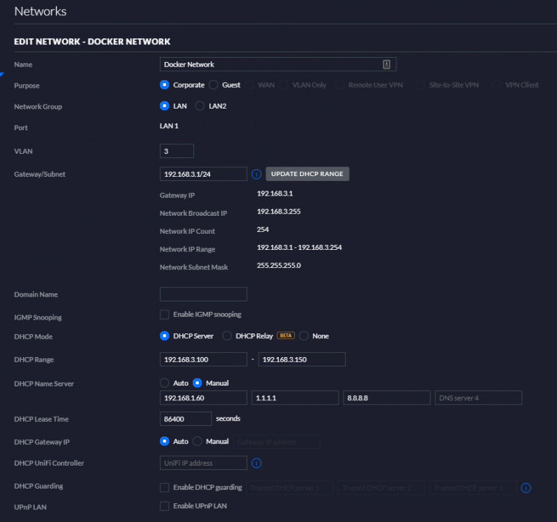

On the router side (UniFi USG), I also created the VLAN:
