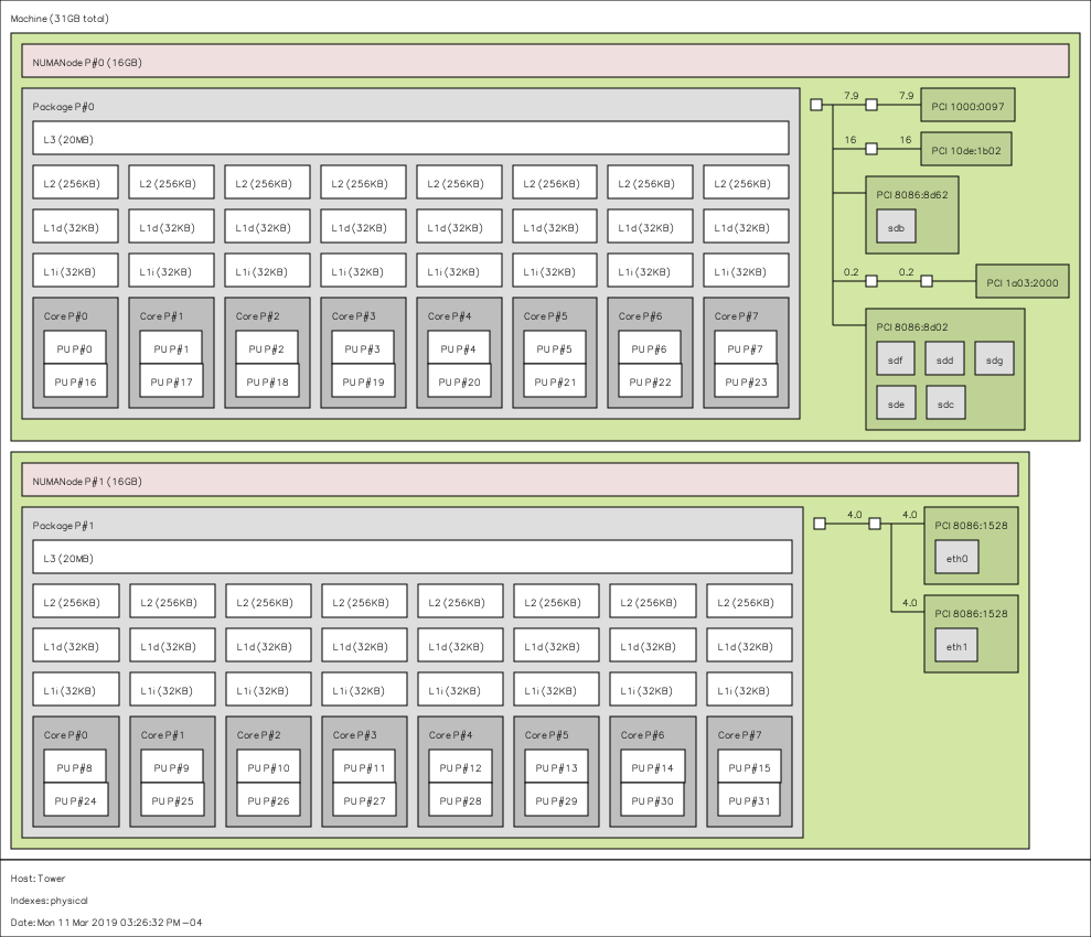

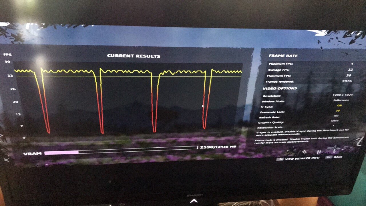

Hi guys so my current setup is a gigabyte MD70  with 2 xeons 2630V3 running 32GB of RAM and a TITAN XP. I want to game on a VM for while before pulling the trigger on getting a new system (my X299 build blew up lost cpu and mobo)  anyways the thing is that I have run some benchmarks on my VM and I get some really bad stutters the frame drops to 0 for a second and then they go back up.
This is the type of stutter I'm talking is also consistent I have tried messing with CPU power management on the Bios, set performance in unraid tips and triks I had already isolated the cores I'm using for use with the VM only I made sure that my GPU is in the pcie used for the cpu I'm using. I'm not using core 0 or 1 because unraid use them. I tried the vm only without anything else running in unraid and still got the same perfomance. Vm sits in the cache of unraid (samsung 850 pro).

I also tried removing cores or adding them the best performance I got what with this 6cores 12 thread config but still does this stutters also I capped my frames to 35 fps because If I try 60 is worse bare in mind is not a gpu problem since my Titan Xp is barely doing some work. I'm really open to ideas to try since I already tried many things I believe.
