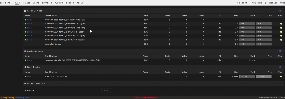

Hello!  I have recently encountered an issue with one of my most reliable unraid 6.6.7 servers.   Over the past week, this server has periodically "dropped off the network" where I can no longer access the ip (unable to ping) or use the console keyboard.  The power is on, but without keyboard response, I have to shut it down forcefully.   I have been trying to troubleshoot what exactly is causing the server to sporadically 'freeze' (hardware failure, etc.).
Tonight, after an 'unclean' shutdown, I am now no longer able to load the array.   The server will hang at 'mounting disks'.   I have tried everything, but have had no success.    I just see the following screen (shown in safe mode):
I am stumped if this is due to an XFS disk error, or something else.  Attached is the most recent diagnostics dump.

Have you tried a New Config and reassign the slots?
Try grabbing the diags after starting the array, use the console if the GUI isn't responding.
