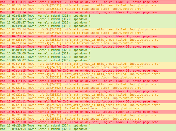

Since a couple of days (I think) I got these weird errors about disks that are not even in my array.. What's going on here?
The system keeps telling me that something is wrong with sds1 and sdt1 and about ntfs. I don't have ntfs disks (apart from the 2 windows vm's that is)
I don't get it.. - I don't like errors in my log esp. when I don't know where they are comming from.

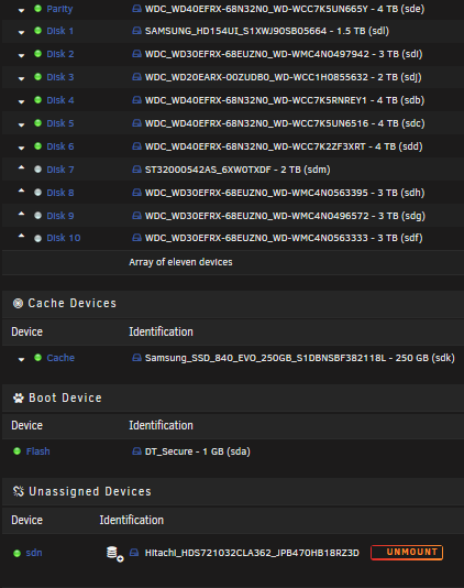

I was able to reboot the array. After the array was up I got an extra item on the main tab. Under the unassigned devices section I got a line to remove the missing disc (it got identified by the usb-drive's serial-number). After I clicked "remove" the drive disappeared from the mountlist (df) and I was able to rmdir /mnt/disks/USB3_1G
