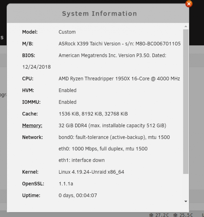

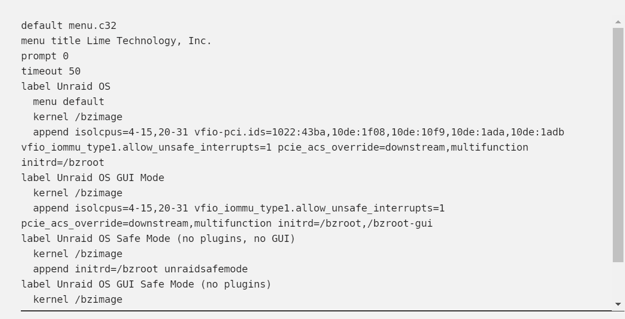

I'm having an issue with passing through a usb controller from my ASrock Tiachi x399 motherboard to a windows 10 vm. I have only been able successfully pass 1 of my controllers to the vm group 13:[1022:43ba]. I followed the spaceinvader one video.  I will just move the unraid flashdrive to whatever does get passed. Problem is that each time I try to pass either group 30 or 51 through both the Ethernet ports get disabled so I am just not sure what I am doing wrong. Unraid Version:  6.7.0 rc5
I have tried with acs override enabled on both downstream and multifunction. This is my grouping below.

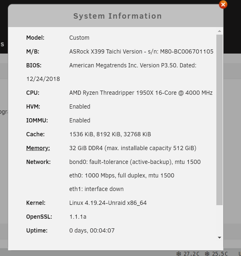

I have been at this for a really long time today and most of yesterday. Any help would be great. As of now this is what my flash looks like:
