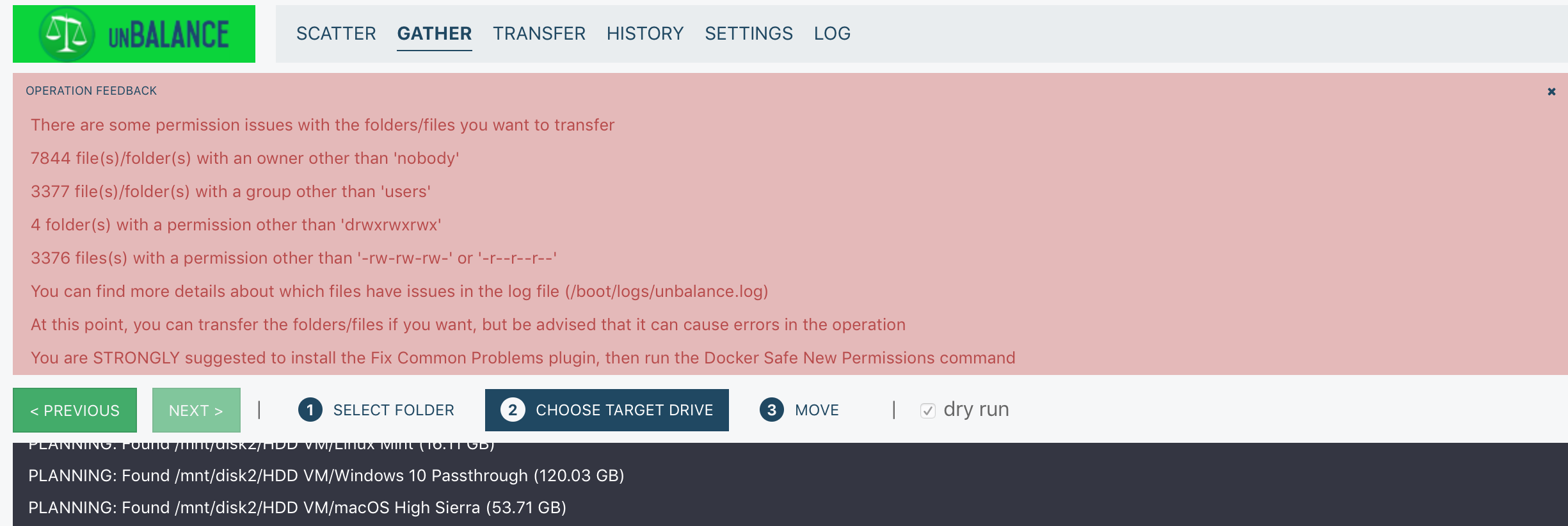

I was trying to execute Plan and this showed up for a few secs and went away. I assume it's all okay since it disappeared and it is now reporting all ready for gather?

2 minutes ago, Rendeaust said:
Thanks. I do have this plugin but never actually came to use it.
2047680126_ScreenShot2019-03-14at12_04_51AM.thumb.png.7c9709fea98a16c8db0e13255004ff25.png
Duno, I have always hated dealing with Linux permission issues, and so made sure to never add another user to UnRaid just to remove these type of issues (do security with firewalls instead)
I suspect you will need to use "New Permissions" tool under tools, or if you have the plugin installed, the "Docker Safe New Permissions" version...  But be careful with that, if you don't know what it does, it has the possibility of screwing up all you Linux permissions...  Possibly not much of an issue for someone getting rid of UnRaid though...
