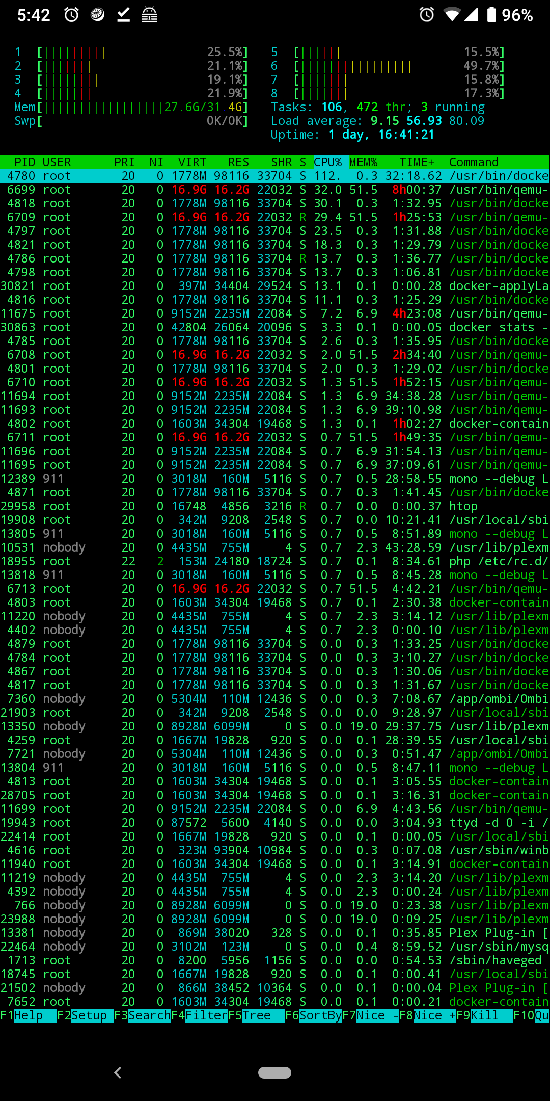

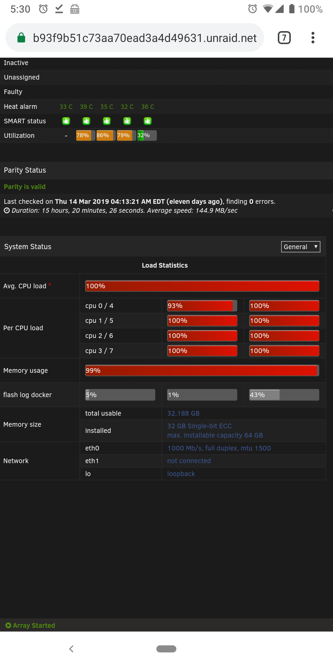

Unfortunately changing to binhex-sonarr didn't fix the issue. I noticed that all my cpu and ram are being used as well when the docker containers stop responding but htop shows otherwise . Attached are some new diagonostics.
Edit: weird thing happened but once docker containers automatically updated the CPU all went back to normal. The docker containers that got updated were :

The hard drives start maknig a lot of noise when this happens. I think there is an issue with I/O and it gets stuck? Is there any way I can figure out if it's a hardware issue or software? My drives are all relatively new (1-2years) and have gone through several runs of preclear before using them so I don't think it should be the hard drives. Any way I can check?
If you run out of RAM, your disks get more stress, and since tehy muich much much much slower then RAM...
