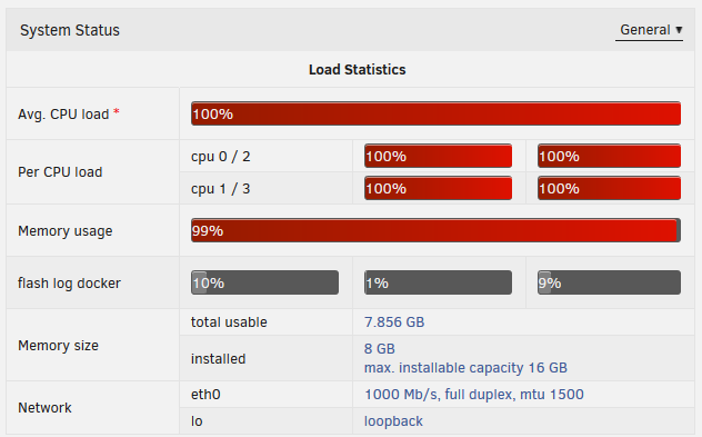

This issue started a few weeks ago and it happens every few days. I would notice that automations in my homeassistant docker weren't running. When I'd check, I'd find that none of my dockers were accessible. On the dashboard page of Unraid, the CPU and memory would be spiked. The dockers page of Unraid would not load at all. Forgive me if I'm not describing this correctly or providing the right diagnostic data. This is my first real issue with Unraid in 5 years of use.

Your screenshot and your diagnostics don't actually indicate a full docker image at the time they were taken, though, so perhaps you already took care of that problem and just never reduced to a more reasonable size. You should still reduce docker image to 20G and get your appdata moved to cache where it belongs.
