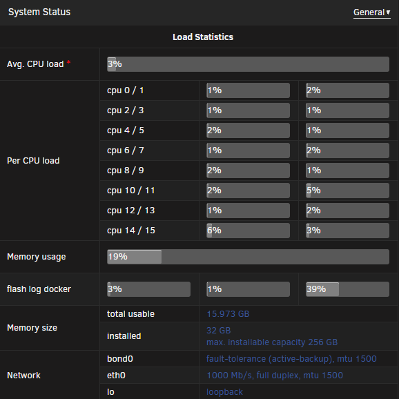

Hi all,
I've had this on-going issue for a while now and i cant seem to get my head round it. Recently i bought an extra 16GB of Hyper X Fury ram which is already installed in the machine. Same model so no compatibility issue. I installed the first set in and had the issue in the subject line. A few restarts later and still no luck.
I then asked for it to be replaced, assuming faulty RAM. Again, the same issue.
The current setup is as followed:
Ryzen 2700
Aorus x470
32GB Hyper X Fury DDR4 2400Mhz
Unraid 6.6.7
MSI GeForce GT 710

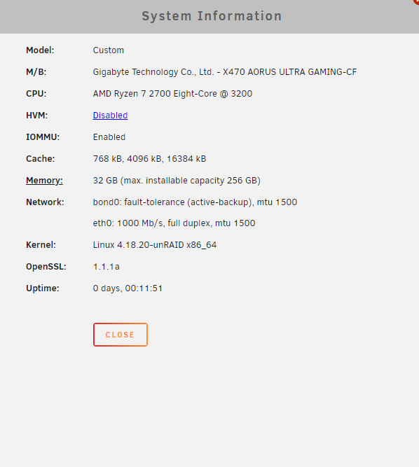

Unraid sees the RAM, as 32GB installed, it just advises only 16GB is useable.
Any help would be greatly appreciated.
2 minutes ago, jonathanm said:
Where are you seeing the 15.973 usable?
image.png.19747729dece735f43a4942a3deaac82.pngimage.png.62e26c978fd6738648fe8d475e019d38.png
