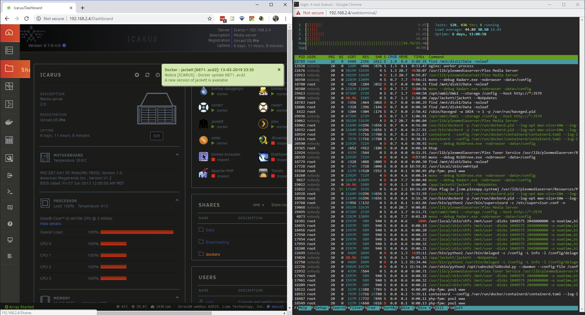

100% CPU in dashboard, 15% in HTOP

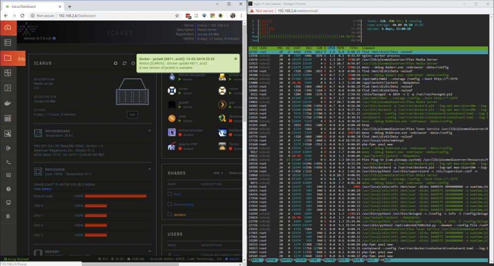

So i noticed plex buffering alot and logged into the server. The dashboard is showing 99-100% usage on the CPU but HTOP is not showing barely any...... Not sure what is going on here????
I asked almost the exact question yesterday but was using top instead of htop.  The response on /r/unraid was "Top does not include IOWAIT while dashboard does.  You can always Install netdata where you can see this type of data."
I personally think the CPU data in the dashboard is misleading but I'm a total noob so I might just be dumb.
