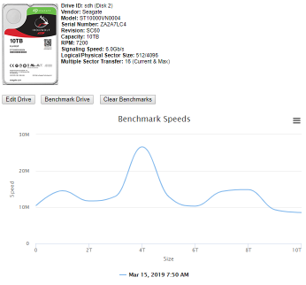

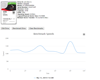

sdh (disk 2) and sdi (disk 3) are Seagate Ironwolf Barracuda drives, 7200 RPM, 10TB.  But their benchmark speed in the Diskspeed Plugin is crap.  Is that because the parity rebuild is occurring at the same time?  (I'm hoping.)  These are both attached to the ASM1062 SATA card (and signaling 6Gbps.)

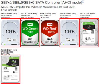

The rest are connected to the onboard SATA (which is in AHCI mode, at least):
Yes. How could it be otherwise?

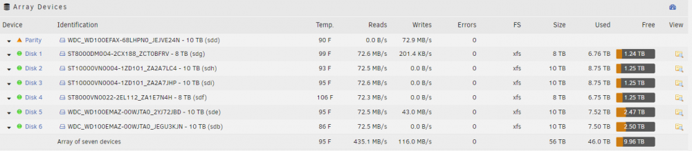

In the screenshot you are also writing to disk5, this will slow down the sync considerably.
The Mover's running!  AHHHHHHHHHHHHHHHHHHH
