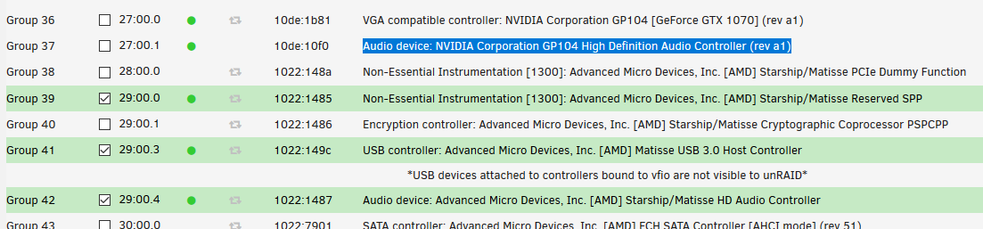

@RaidBoi1904 You are a champ for jumping head-first into this issue with a new UnRaid setup.  And, sorry to hear the problems all at once...  they are not so bad when they pop up once every 2 years after a major hardware upgrade.  But your first time out can be rough.

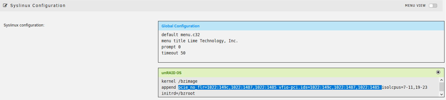

So, to pass through Audio and USB (or anything), you will need to isolate them (in addition to the no_flr hack right now for this mobo/cpu combo).
It looks like you know where you're going-  Main > Flash > Syslinux Configuration to add these lines
My setup looks like this for just the USB -- notice the vfio-pci.ids for isolation--I don't know if I need all of them, but I do them as a group and it works:
pcie_no_flr=1022:149c,1022:1487,1022:1485 vfio-pci.ids=1022:149c,1022:1487,1022:1485
You will also need to isolate the Audio device to pass-through.  on my mobo it looks like it's 10de:10f0, so you would add that to vfio-pci.ids:

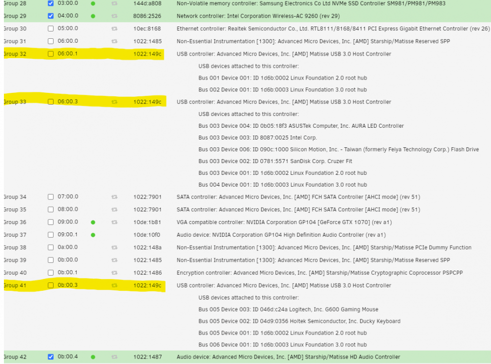

Thank you for your reply. Since I wrote this message I have tried a ton of things to get this to work, out of desperation i went back and tried all of those things once again! I did learn a few things so it is not all wasted, but I still haven't achieved a working solution (I did have a mobo brick it self via wifi update, that was cool lol and apparently also common!). In several occasions I got all the devices installed with their drivers but the computer always ended up freezing and refused to reboot (displaying a blue screen with a kernel security error).
It turns out I can't pass any of the usb hubs to my VM, they appear to share an ID so regardless of what usb hub I pass as soon as one is passed unraid is no longer able to access the unraid USB.
As I write this I'm thinking i should go change the groupings in the VM setting to see if that gives them different ids.
At any rate I'm back from trying beta .22 .23 .24 with regular and custom kernels. I'm now on the stable branch with a custom kernel and the following flags:

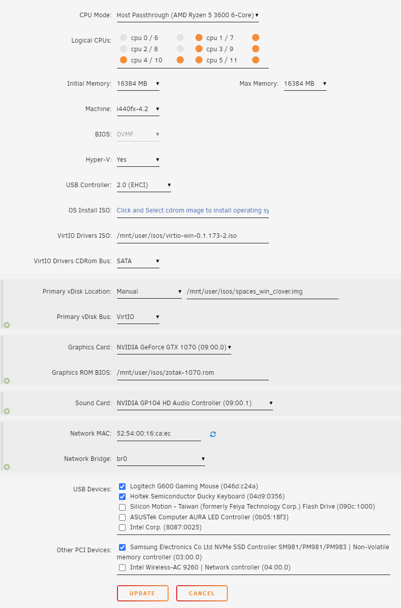

This is how my current VM looks:
I've put my video card and its sound card on the same buss  in the xml like so:
      <driver name='vfio'/>
      <source>
        <address domain='0x0000' bus='0x09' slot='0x00' function='0x0'/>
      </source>
      <rom file='/mnt/user/isos/zotak-1070.rom'/>
      <address type='pci' domain='0x0000' bus='0x00' slot='0x06' function='0x0' multifunction='on'/>
    </hostdev>
      <source>
        <address domain='0x0000' bus='0x09' slot='0x00' function='0x1'/>
      </source>
      <address type='pci' domain='0x0000' bus='0x00' slot='0x06' function='0x1'/>
    </hostdev>

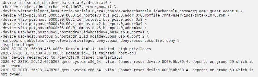

Right now I'm stuck with error 43, although I've passed this card to 20+ different VMs with this bios and this xml without issues (passing the video card is the only thing that always worked and now it doesn't lol). So I'm some how worse off than a week ago.
Update #1: I don't like this at all but the fix to my error 43 was disabling the UEFI boot... that makes a lot of sense to me. I will attempt to pass audio now, giving up on the usb hubs for now as changing the grouping method didn't change the "1022:149c" id for all of my usb hubs =/.
Update #2: I'm unable to  install drivers for the sound device I passed through, it appears to be working ok with the generic windows driver at the moment. I will start testing some games to see if this try doesn't crash.
Oh I was going to pass group 39 but that is the usb hub with the same vendor id as group 31. As I type this I will go see if I can find a fix for passing same vendorID devices and ductape one more thing to this vm!
