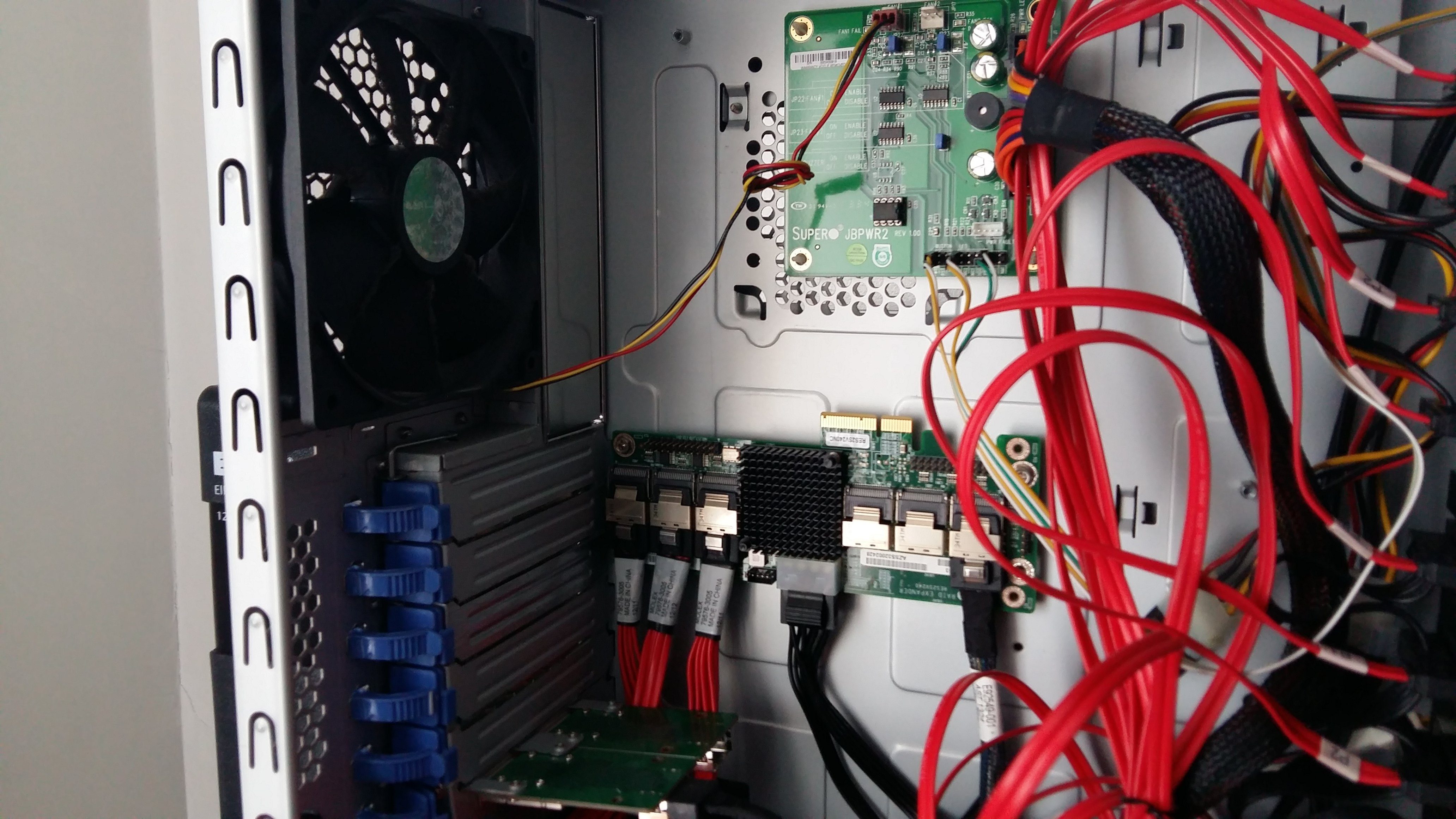

Yes, though slot is only required for power, and some expanders can be powered by a molex instead connector, for example, this is a second atx case with an Intel expander to increase the max disk capacity on one of my servers, it's connected by an external SAS cable to an LSI 9207-4i4e HBA:

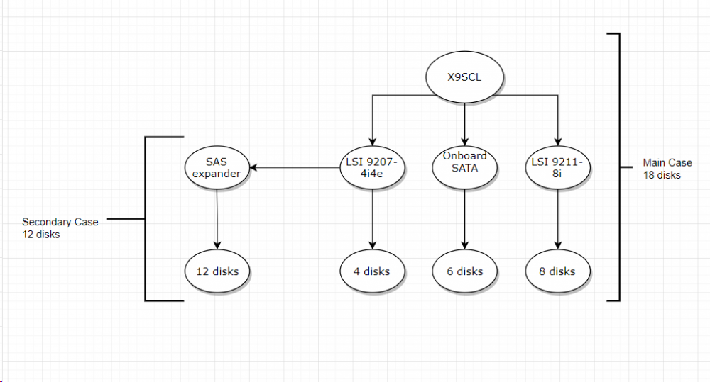

To better illustrate this is how they are connected:
Thanks, that drawing explained a lot, I'm finally beginning to understand :)
