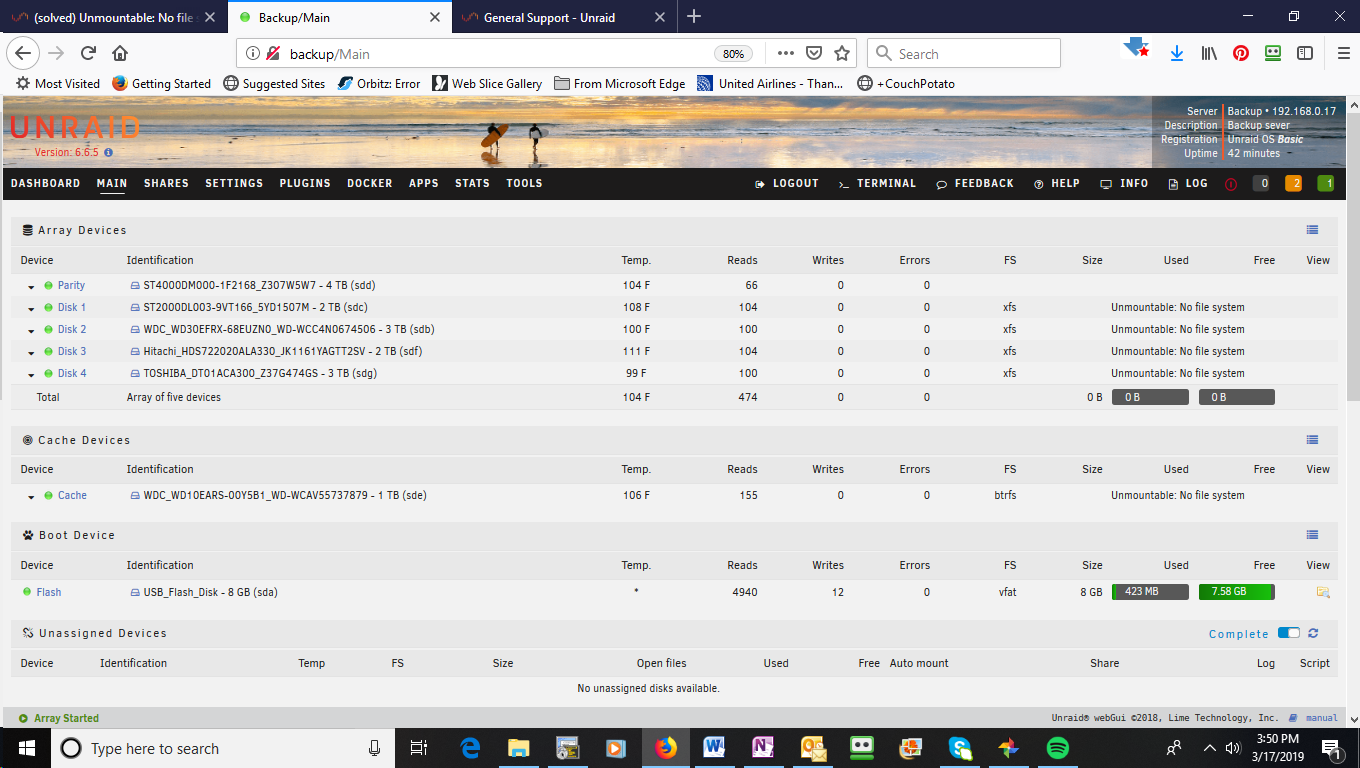

Storm power outage now all drives Unmountable: No file system
I had a power outage, had to replace the power supply and video card. When it started up I cannot get GUI.
SSH to server and started NGINX. PLEASE HELP - all my photos!!  main screen: and Diagnostic attached

You have a problem with your flash drive. Put it in your PC and let it checkdisk. Be sure you are using a USB2 port on your server for flash. While you have it in your PC make sure you get a backup of it. You must always have a current backup of flash, and for future reference you can get one from the webUI  by going to Main - Boot Device - Flash - Flash Backup.
Not the cause of your problem, but disk1 has more reallocated than I would be comfortable with.
Luckily I just backed up the USB.
I did a restore onto a new drive, transferred the key, and all is working again.
